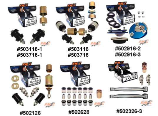

W212 4MATIC SUSPENSION OPTIONS
WHEN IT COMES TO UPRATED SUSPENSION BUSHINGS - AT K-MAC we have the experience of manufacturing longer then anyone else - Since 1964 !
WITH PROUDLY IN-HOUSE MANUFACTURE - not sourcing CCP imports (in fact bushings for virtually every model Mercedes Benz 1968 to 2024).
The 4 front “highest wearing” bushings we have also included BOTH “CAMBER AND CASTER” ADJUSTMENT AS WELL.
SPECIALLY DESIGNED SO “BOLT-ON” - NO SPECIAL TOOLS OR NEED FOR CONTROL ARM REMOVAL.
BECAUSE OEM THERE IS NOW ONLY BASIC TOE (DIRECTIONAL) ADJUSTMENT.
Brought about through cost cutting and ever increasing speeds of new car assembly lines. Stopping to adjust is no longer an option. Now Front Camber and Caster along with rear Camber is set to suit showroom height conditions.
NO LONGER ABLE TO ADJUST TIRE CONTACT ANGLES SPREAD LOAD MORE EVENLY.
PUTTING ONUS BACK ON OWNERS TO FUND COSTLY PREMATURE TIRE REPLACEMENT. With passengers side excess edge wear through high cambered roads or edge wear both sides through altered height - extra passenger loads or lowering. Fitting wide profile tires or curb knock damage.
SAME WITH REAR SUSPENSION.
Uprating of the two main rear suspension bushings and also same time providing rear Camber adjustment. Kit also uprates the two Toe bushings (and doubles the existing adjustment range).
THIS REAR KIT CAMBER BUSHES CAN BE REPLACED ALSO WITHOUT SPECIAL TOOLS OR NEED TO REMOVE CONTROL ARMS.
REMAINING REAR BUSHES ARE FITTED TO THE 6 MULTI LINK ARMS. Replacing, uprating these bushes significantly reduces rear end flex. Allowing “tauter response and traction”. Especially when applying power to lane change / overtake.
