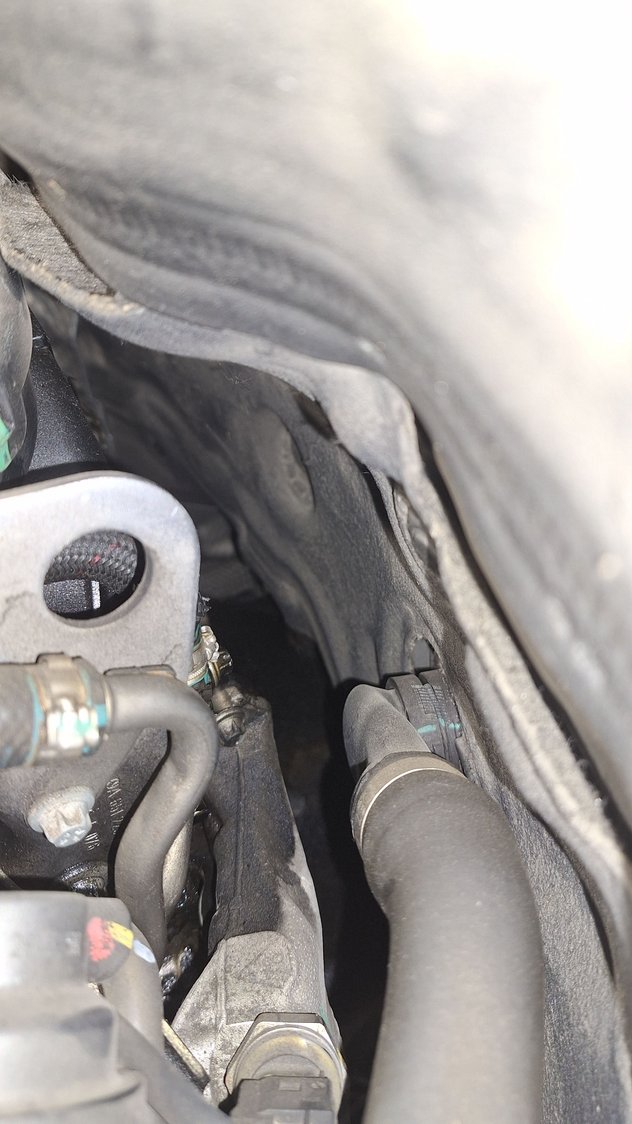

One leak is minor on the right front side of the vehicle under the cooler

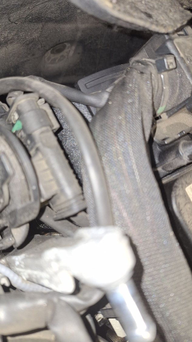

One minor leak on the side of front differential

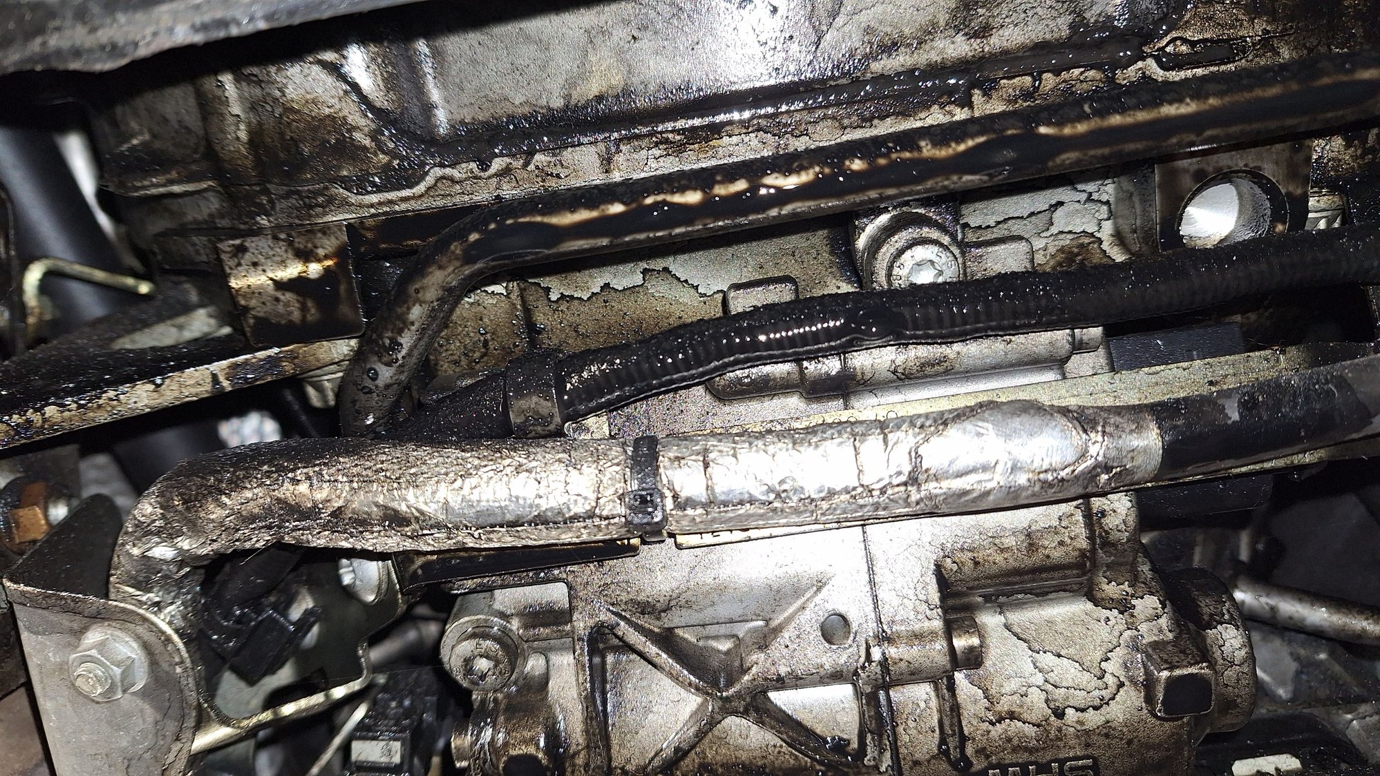

One large above the transmission. Several drips over night with engine off. Initially I thought it's the sump seal but the oil stain goes up a long way.
Front leak:
Front differential:
Transmission area leak:

It is definitely engine oil. I now completed changing all oils and after starting the engine, this spot next to auxiliary transmission pump started dripping. After half an hour there was already a small puddle on the floor.
I managed to film it with engine running:
https://youtube.com/watch/9dR2Iu9aN4w
I also made some pictures from above the engine and there are clear traces of oil right in front of the firewall.

this looks like you valve cover gasket....
valve cover
wet head at valve cover
why ? because it's wet all the way up to valve cover gasket
Is it alone? probably not!
As soon as you fix valve cover another vent port is going to vent out high crankcase pressure.
None of the old seals can resist high pressure. Fix up PCV and discharge tube to help that out.
