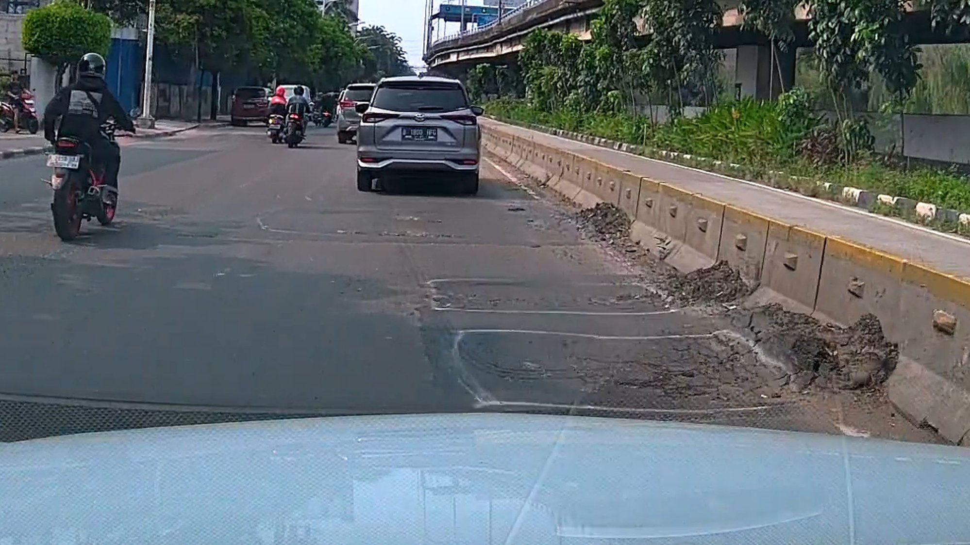

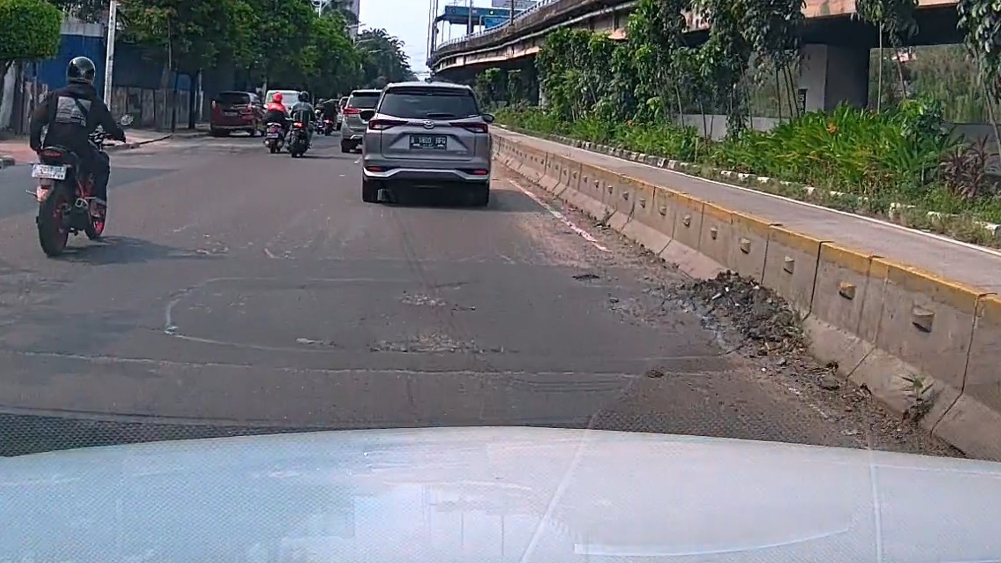

Now my car is firmer and on some decent-bad roads I would call it harsh.

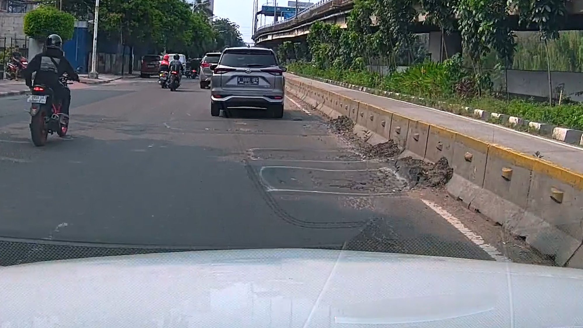

On this bad but not say crazy bad, it seems the B6 is holding up the spring from compressing fast enough. Therefore I felt it is harsh, not hard per se.
I
I recalled B4 was much more gentle on bad road of this type, I made a post on it :
https://mbworld.org/forums/e-class-w...gine-data.html
B4 was really nice and quiet, I even made a post on it ..as I was wondering why it can be more queit than the original dumb-azz SACHS.
https://mbworld.org/forums/e-class-w...oad-noise.html
I replaced B4 to B6 at that point in time was because at high speed at highway with bridge joints and 4 people on board including myself, some luggage,..... the rear suspension can bottom out.
It was Jakarta-Bali-Jakarta trip, the Jakarta-Bali section. So I thought why not try B6 version and only for the rear.
Looks like now my new spring and B6 combined = harsh for the above road.
I can feel it is harsh for the rear suspension only and not the front , which is still a B4.

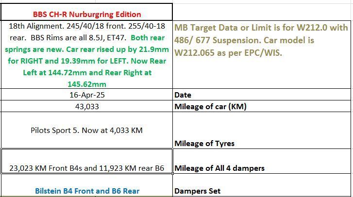

The NEW REAR SPRING is 130km, the B6 at the rear is close to 12,000KM and almost 4 years old.
.Now the new rear spring has settled, I mean no more as tall as 1st 2 days of install. 24th April 2025 data, below : but 40kg extra fuel load,
which is worth about 2.85mm lowering of the spring if at 7kg per 1 mm type of spring rate.

I don't think my spring is worn, tired maybe .
But it sure is at least 5mm shorter or more compressed the oldie one, when and if with equal weight on the car, compared to new one.

Those bad roads I showed the photos are probably needing only 2cmm or so spring compression and B6 initial push down is bit more than B4,
if B6 is firm and new spring is as firm as it should be, I guess overall is more firm and seems harsh, if compared to B4.
That bad patch road has white paint mark, that meant it will be repaired soon.

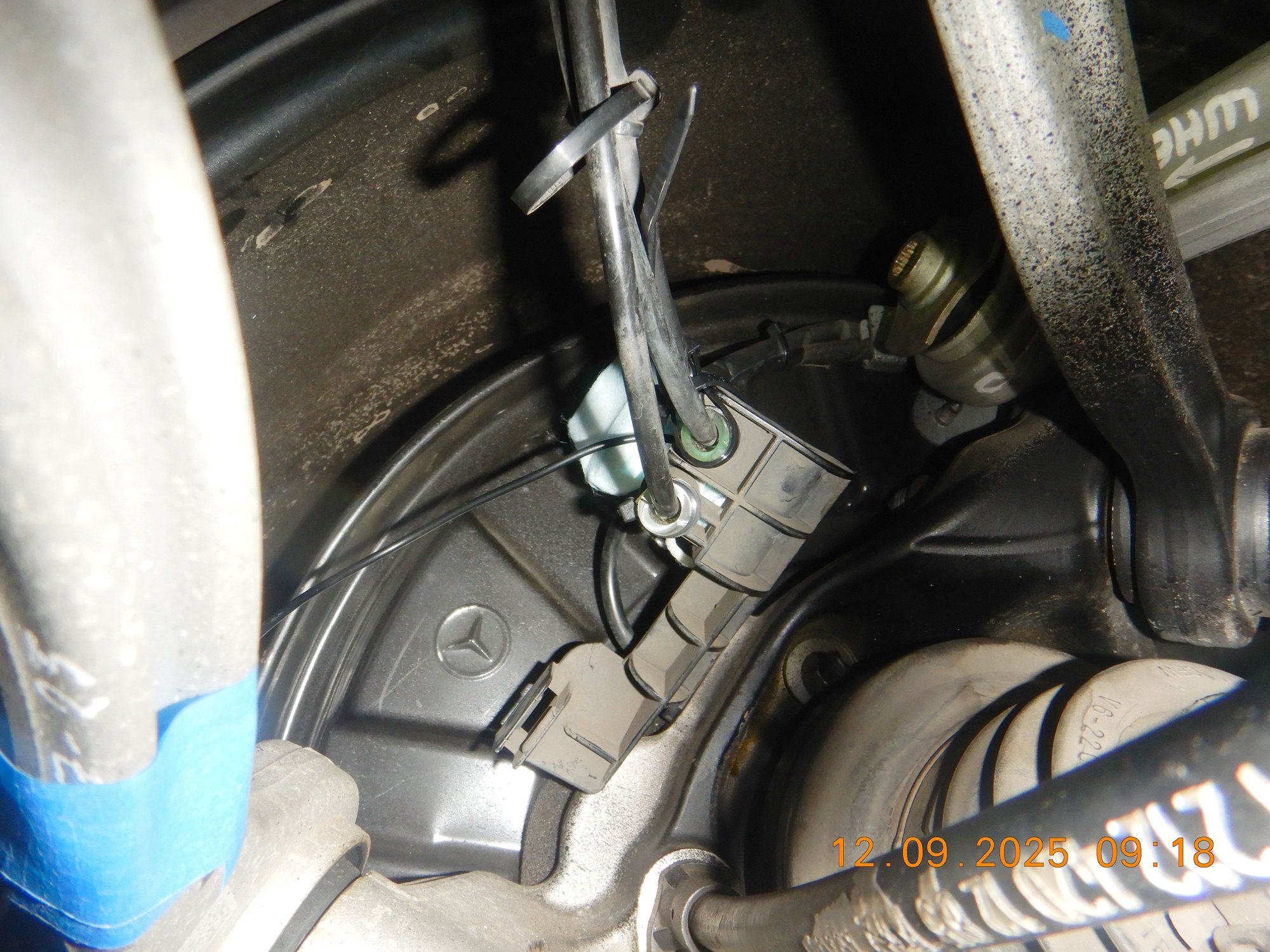

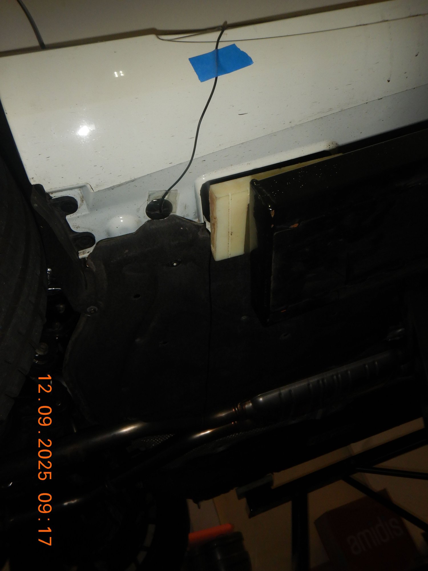

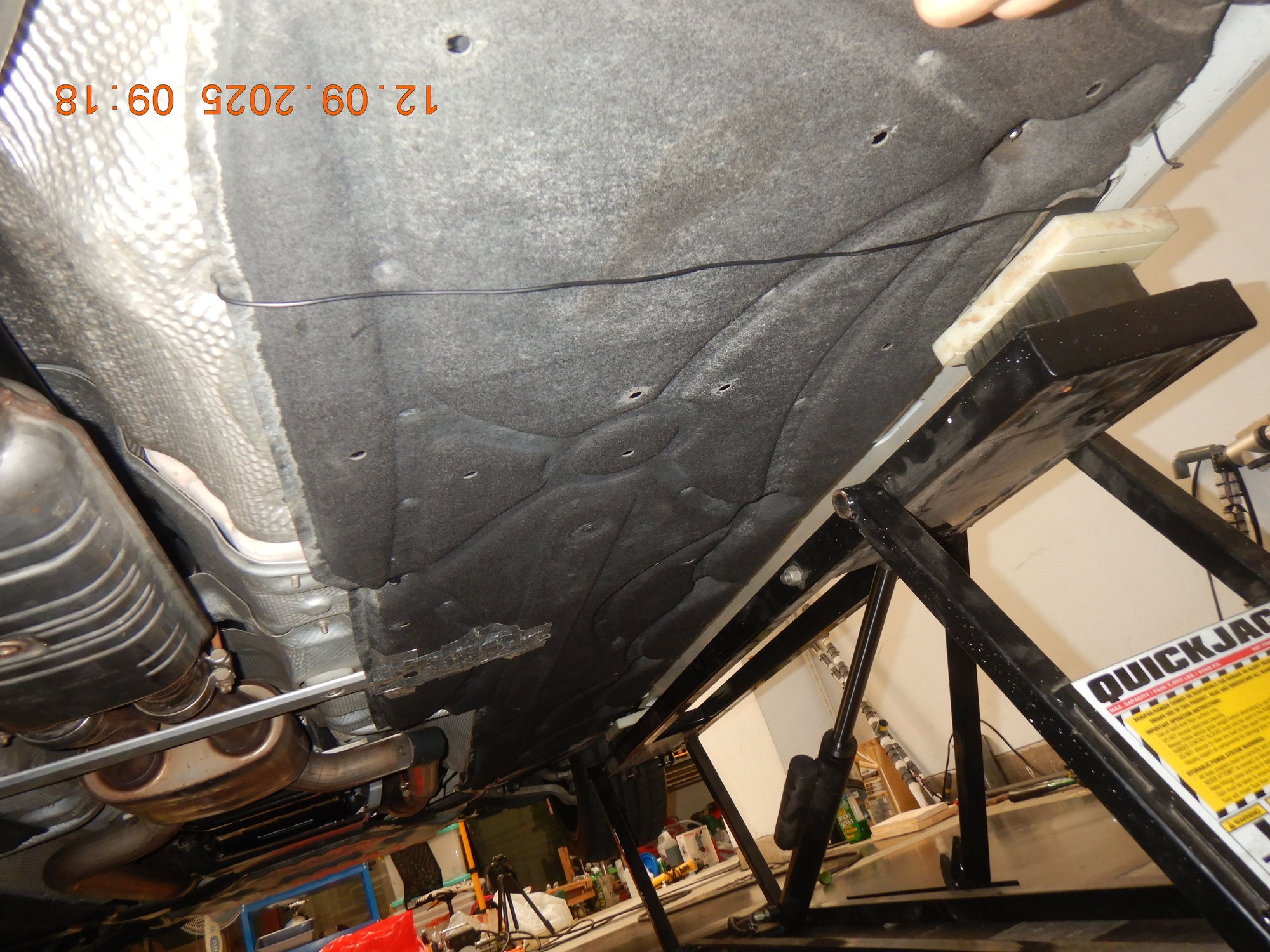

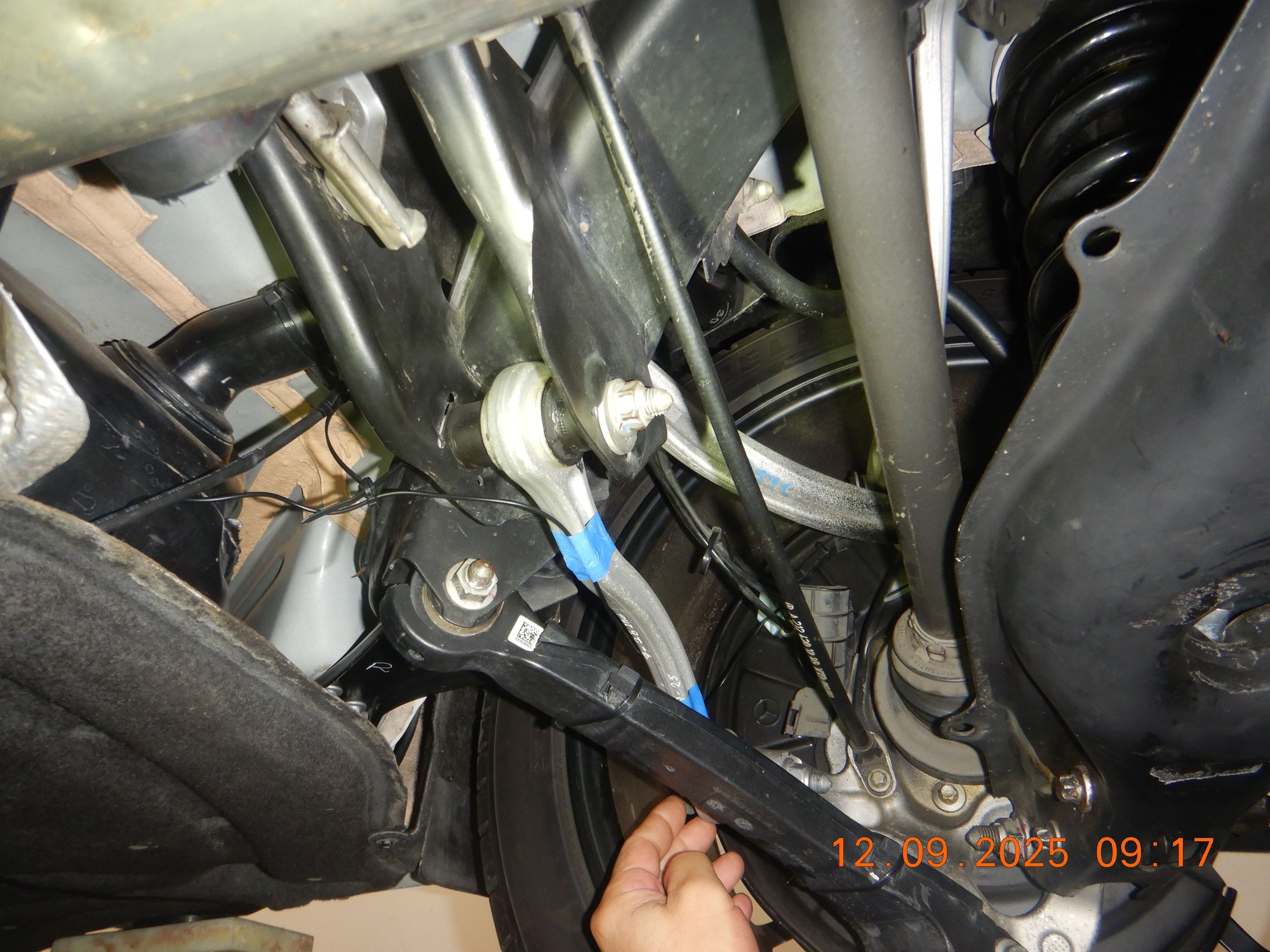

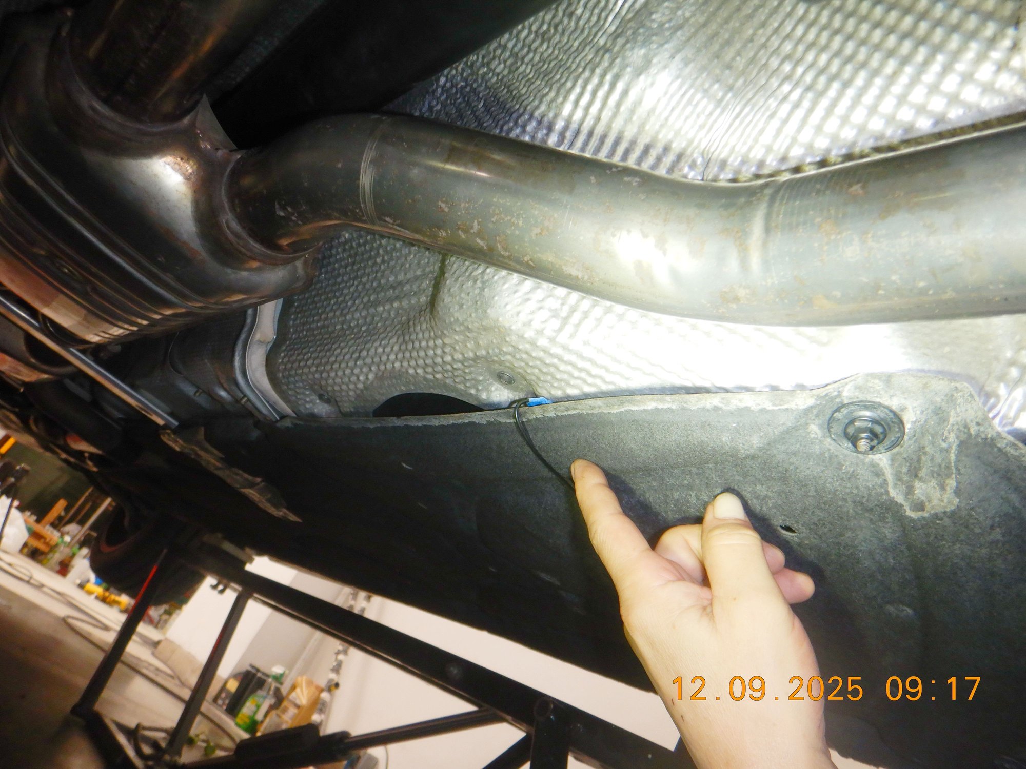

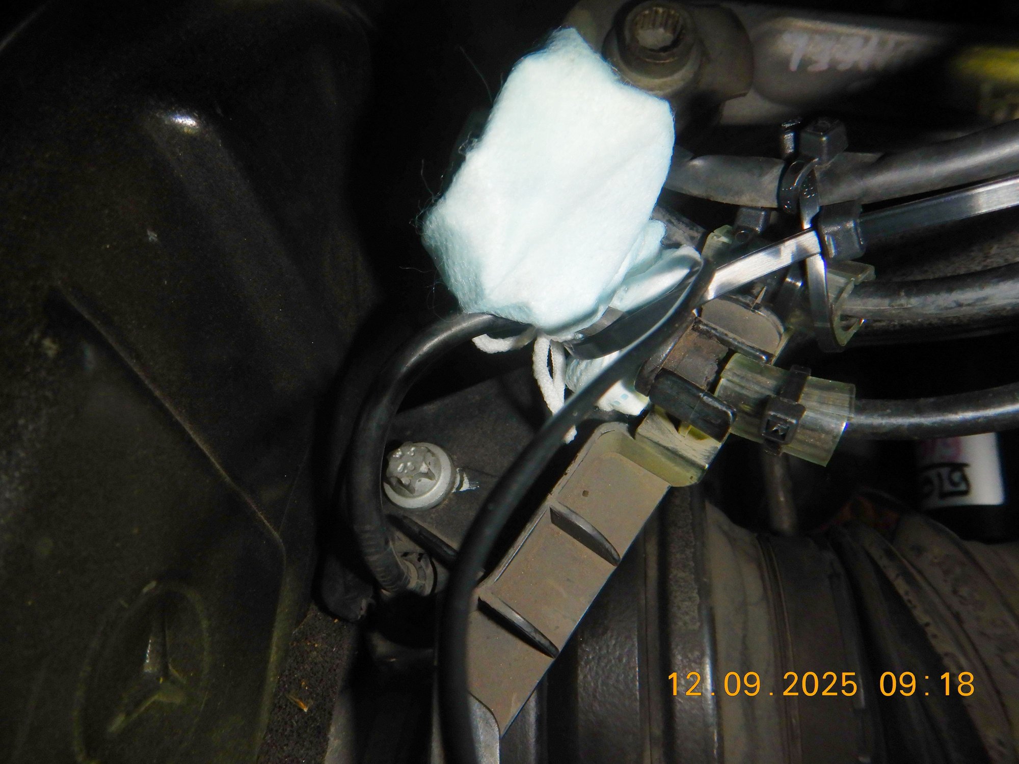

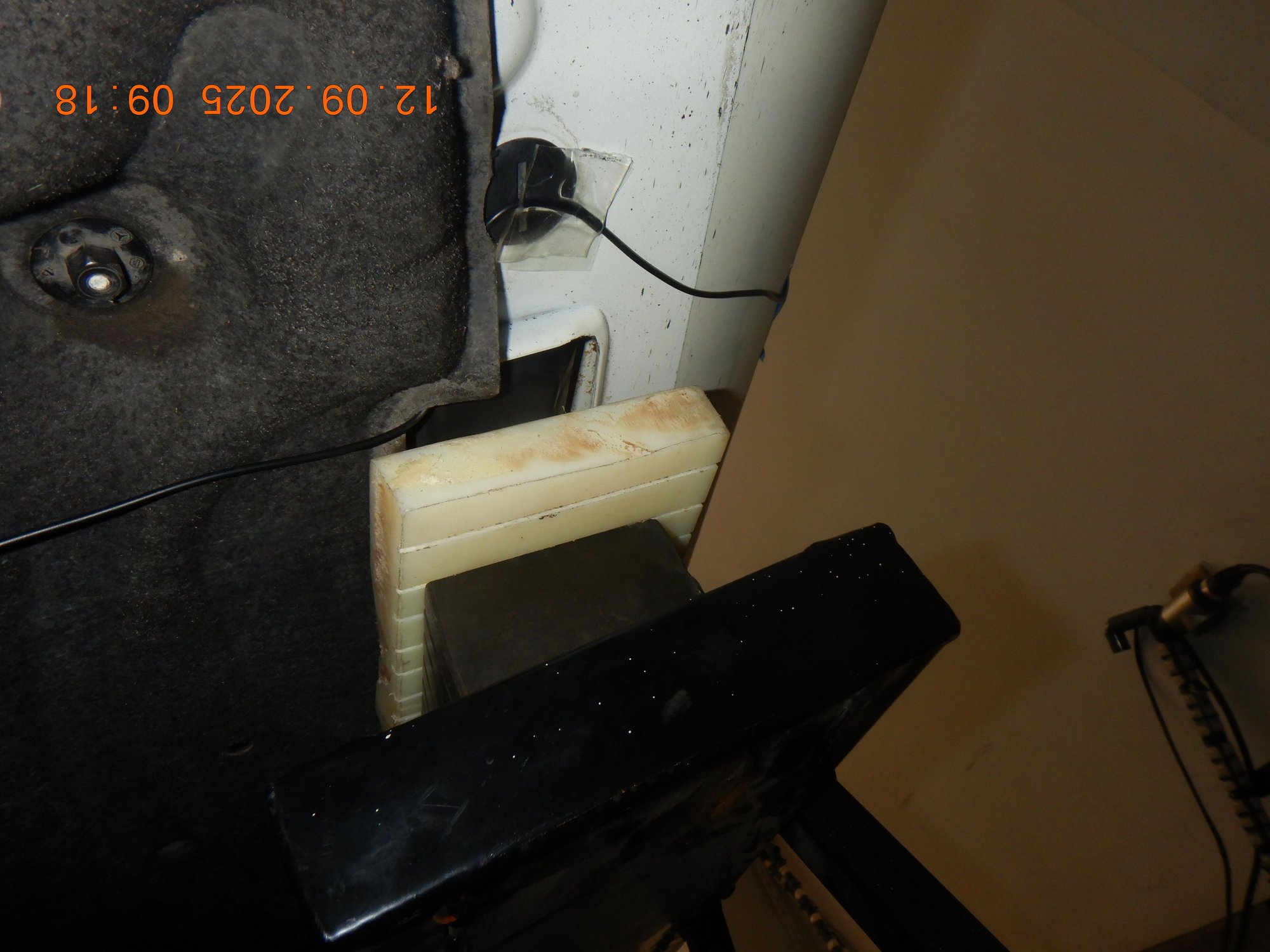

This is a recording of the wheel noise and normal interior noise , there is a mic I placed at near the abs sensor cable.
Mic covered in mask, as wind noise shield and also dirt shield.
Running the mic cable into the car
This mic is feeding my oldie Samsung S10e phone, which will be on a shaky Ram X shape suction cup mount.
Below is the video from the Dashcams and phone.
The Samsung external mic at the wheel gets some vibration noise which you can hear, ignore that. I could not super secure the mic.
