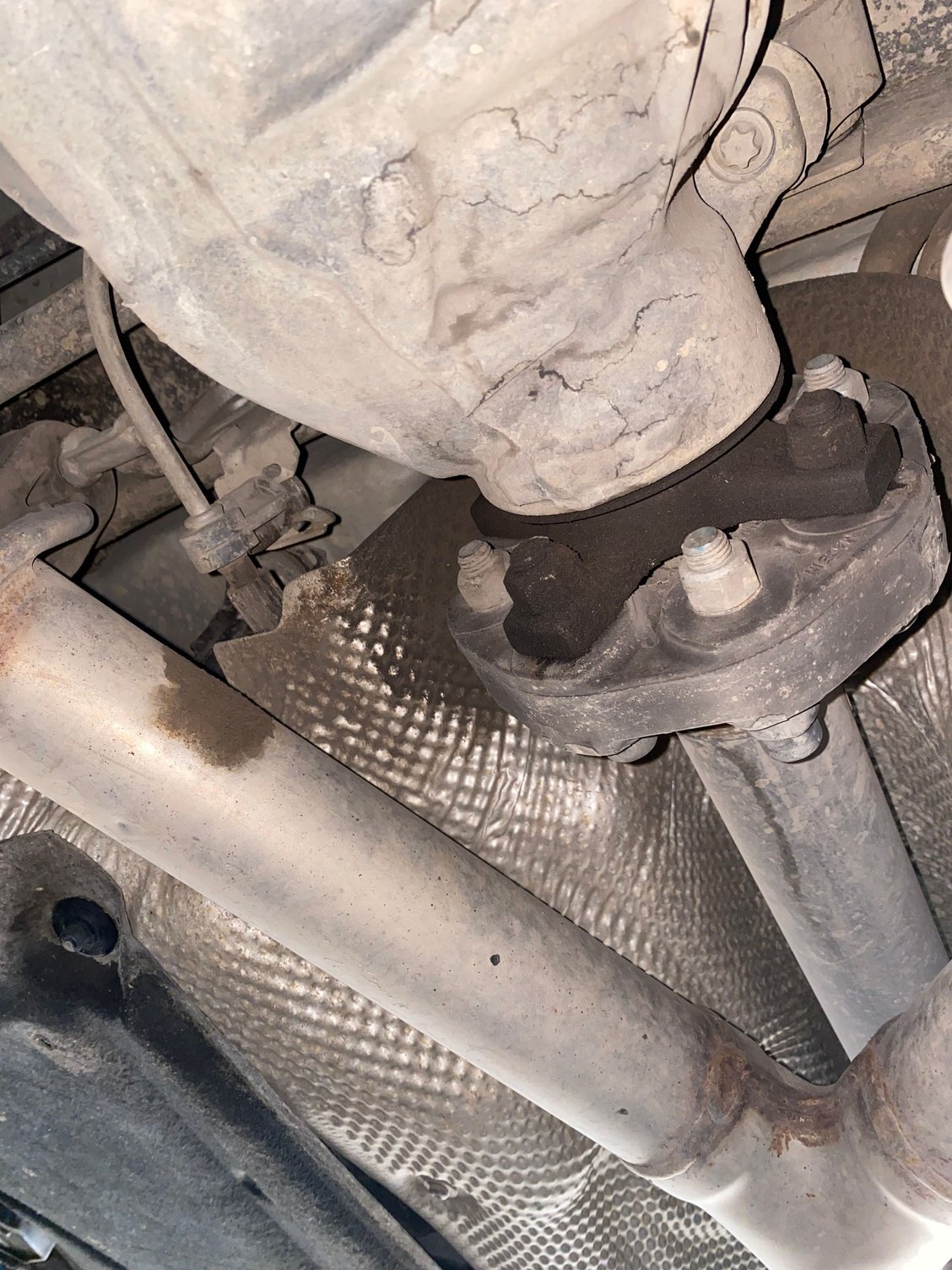

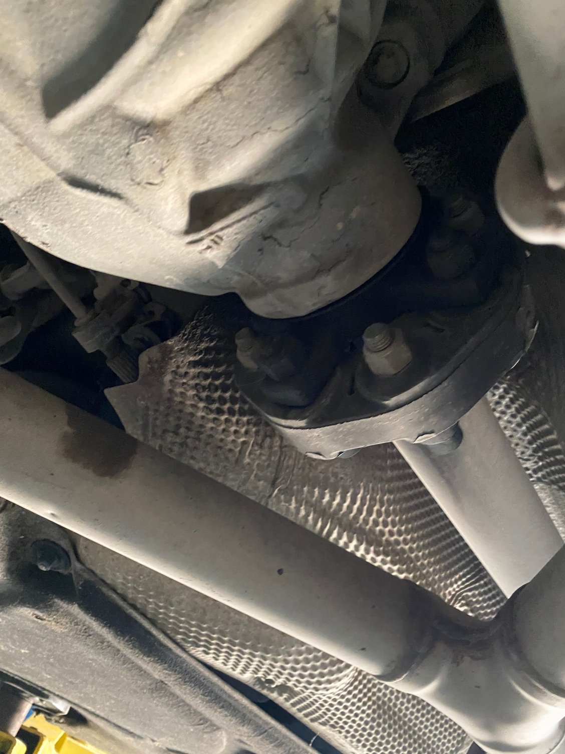

Hi everyone,

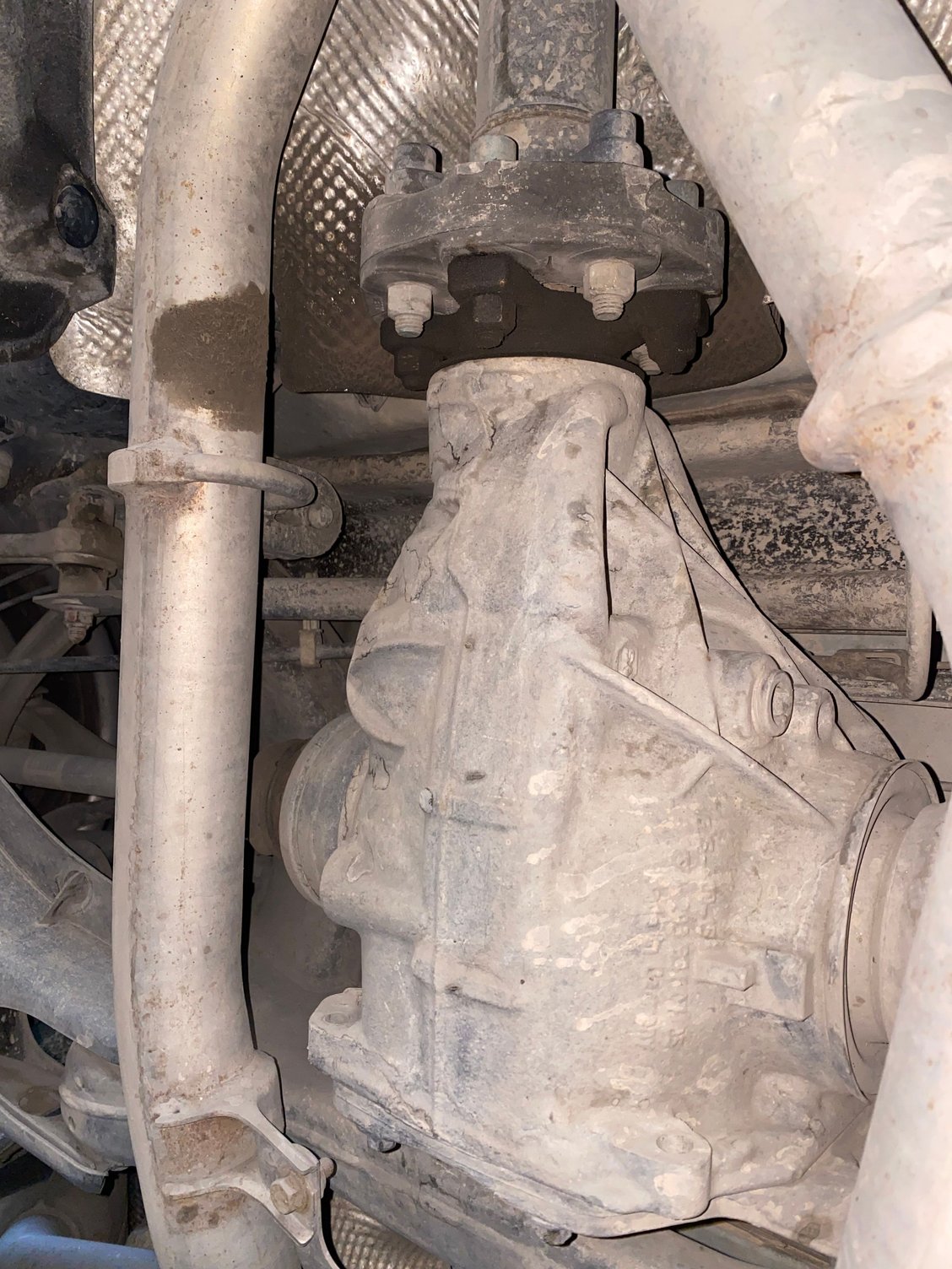

I noticed an oil stain under my 2014 Mercedes E250 CDI (Diesel, W212) rear when I recently went under the car to inspect. I’m not very mechanically knowledgeable, so I wanted to ask for your help in identifying what this leak might be, and whether it’s serious or something I can monitor for now.
I’ve attached a few pictures below:
From what I can tell, the leak seems to be coming from the rear area, possibly near the differential or driveshaft. There’s some oil staining on the exhaust pipe and surrounding metal, but nothing seems to be dripping actively. I don’t notice any performance issues or noises while driving.
My questions:
  • What part is leaking here? Is it the differential or something else?
  • Is this a serious issue or just a minor leak I can keep an eye on?
  • What kind of oil is leaking? Engine oil, gear oil, or something else?
  • What would be the best way to fix this, and is it something urgent?
  • Should I be checking fluid levels, and if so, how?
Any advice is appreciated — I’d like to be informed before taking it to a mechanic, and I want to understand the situation a bit better. Thanks in advance!

this is your dif pinion shaft seal leaking.
The problem is not the dirty seal, it's the input shaft bearings have too much freeplay.
Dont spend $8,000 to get this rebuilt. This is a standard failure, no need to open everything for estimate.
Caused by tranny mount, inter shaft bearing + destroyed dif. roller bearings not serviced.
Uses only 1Qt of 75w90 gear oil: not much to leak out.

  1. Honestly, I have no idea how long this leak has been happening. I just noticed the stain recently when I looked under the car.
  2. Am I cooked already, or do I still have some time before it becomes a major issue?
  3. Based on what you said, is my differential already damaged, or is it still savable if I act now?
  4. Would you recommend checking the gear oil level and topping up, or is that just a band-aid if the bearings are already gone?
  5. Also, is there any way to confirm bearing play or damage without opening up the whole diff?
I’m trying to avoid a massive repair bill, so I’d really value your thoughts on the next best step. I’m just a regular owner, so I’m learning as I go — thanks again for sharing your experience.

this is more than cosmetic! At this stage you're likely running on less than 1/2.Qt. of oil.
By the time you see the amount of glitter that come out of the drain plug you'll understand the emergency. Simple oil service was missed long ago.
This may lock up wile driving. Get this worked on.
These difs. are built without a magnet... steel particles circulate non-stop into bearings and gears...
By the time the bearings is gone the shaft has too much play that input seal can not handle without dumping oil.
Next time... add a magnetic drain bolt to disable self-destruction.

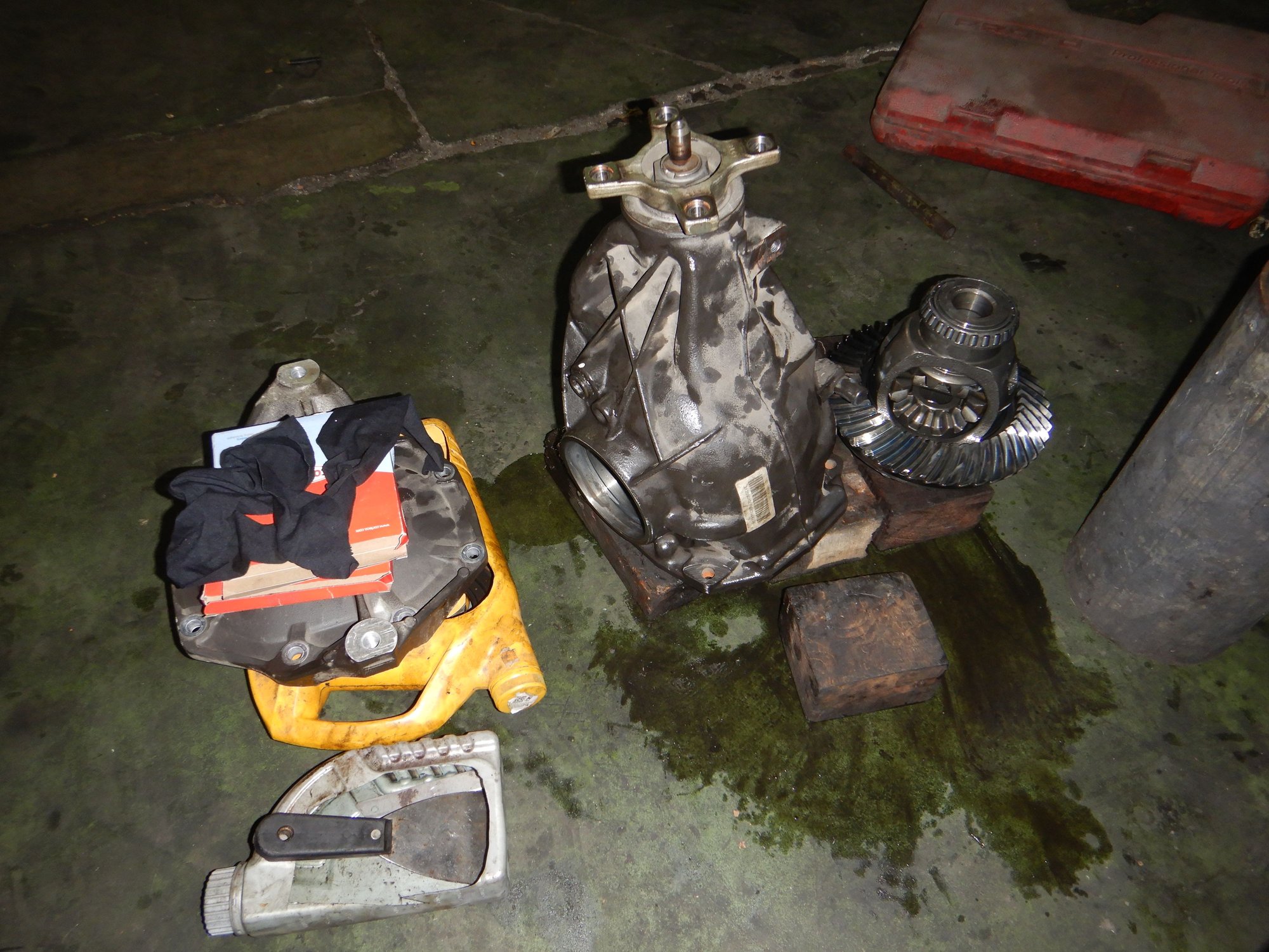

Just bring the DIFF back to its normal oil level.
Clean all old residue/dirt and start monitoring leak rate.
If leak is very small, perhaps you may end up topping off every 6 months or so.
True to what Cali said, it could be from vibration that the main input shaft went dancing-shakey-shakey and cause shaft seal to leak.
It could be a dynamic leak, meaning only when shaft spin and leak then occur.
So u must check both rubber dampers ( flex coupling ) of the propeller shaft and the middle bearing.
Flex coupling
https://www.fcpeuro.com/products/mer...i-0004110600kt
Middle bearing ( propeller shaft), read here : https://mbworld.org/forums/e-class-w...ml#post8822118

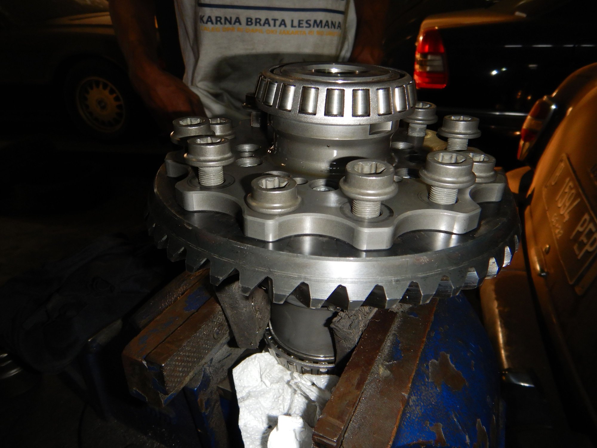

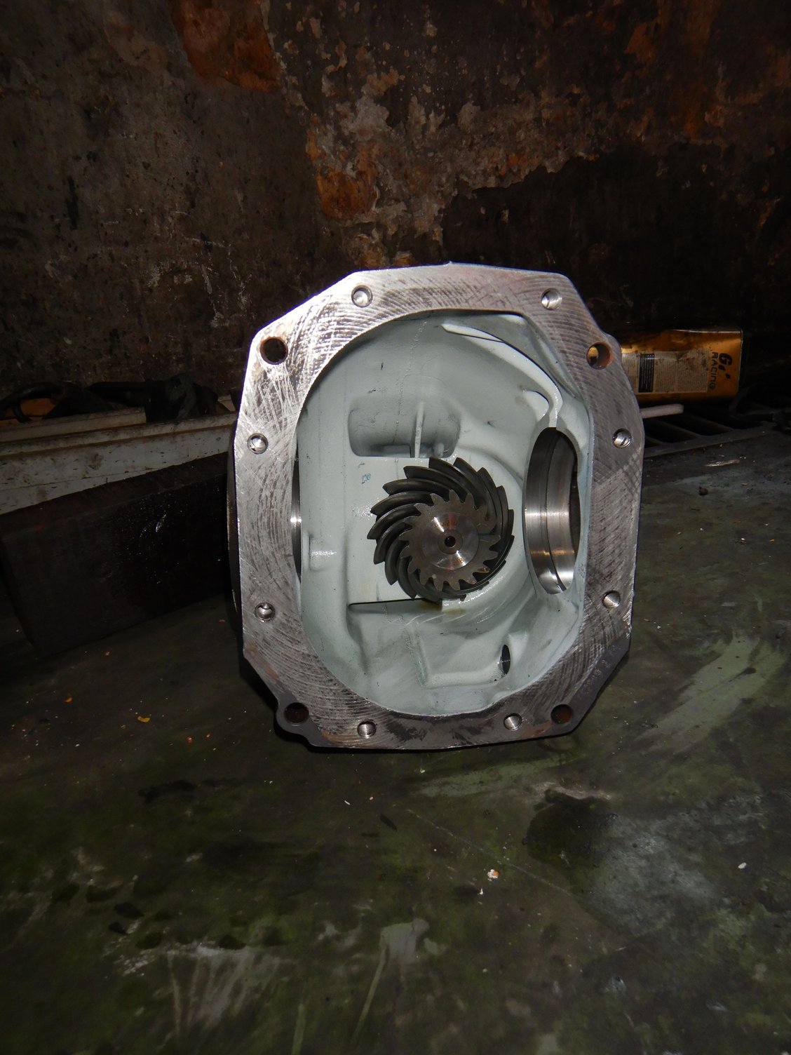

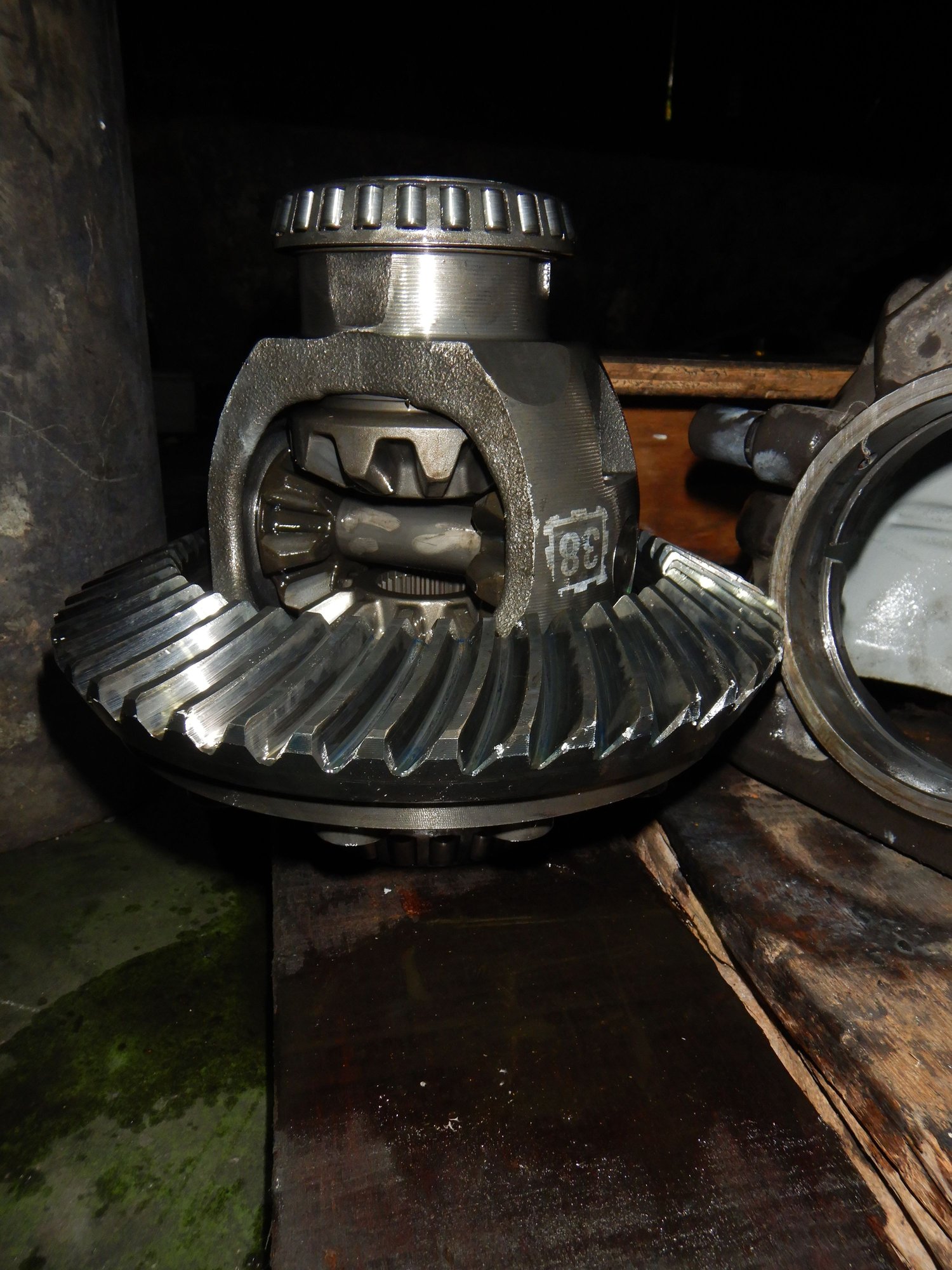

The DIFF strip down, but I did not remove the mains shaft, I only replace the big gears with ATB unit, like a Limited Slip device, but no clutch.
Below : original
Below, your leaking seal is behind that small gear.
ABT unit, below

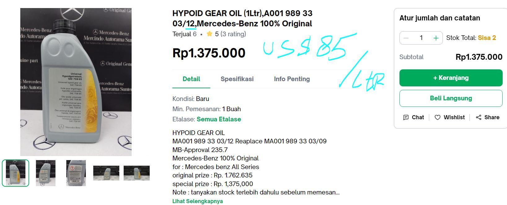

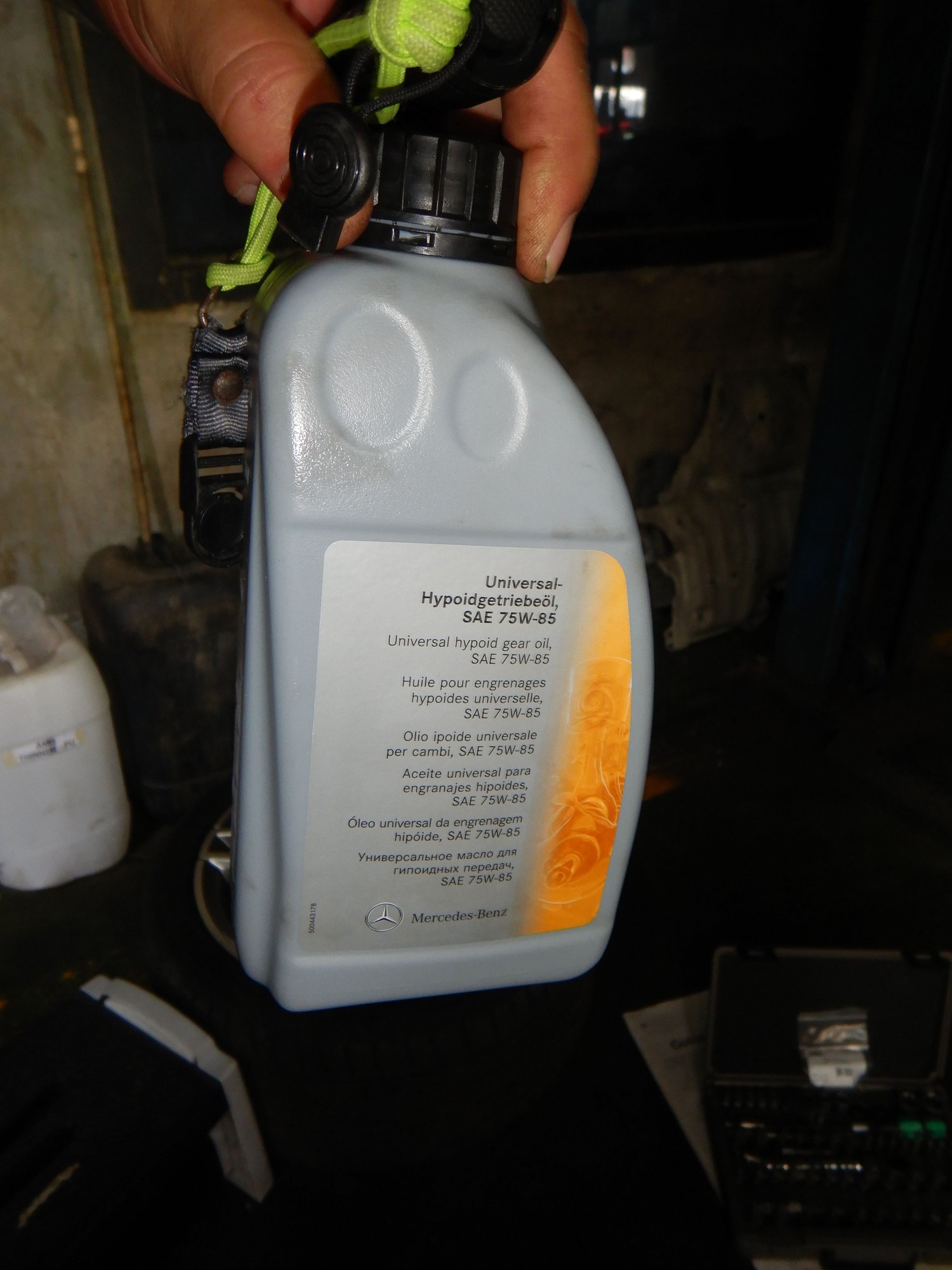

You need this oil for the DIFF
Do not buy wrong and ended up with LSD type DIFF oil.
Hoping u only have super minor leak.

loose input bearing
The leak serves as witness of input shaft freeplay...
input pinion gear: shaft bearings + seal
Diesel Mercedes still require maintenance to go high mileage.
The input shaft bearing being loose it's busy eating the gear into additional glitter - I hope I am wrong saying this is just "a leak": check the shaft freeplay!

The DIFF oil I shown is the one for regular non AMG LSD DIFF, that is us regular DIFFERENTIAL.
Sometimes MB add extra 2 digit on newer parts. Like above the extra digit is 09.
I got the one with 2 extra last digit being 12. The core part number number is A001 989 33 03
List of approved DIFF oil, our kind of DIFF
