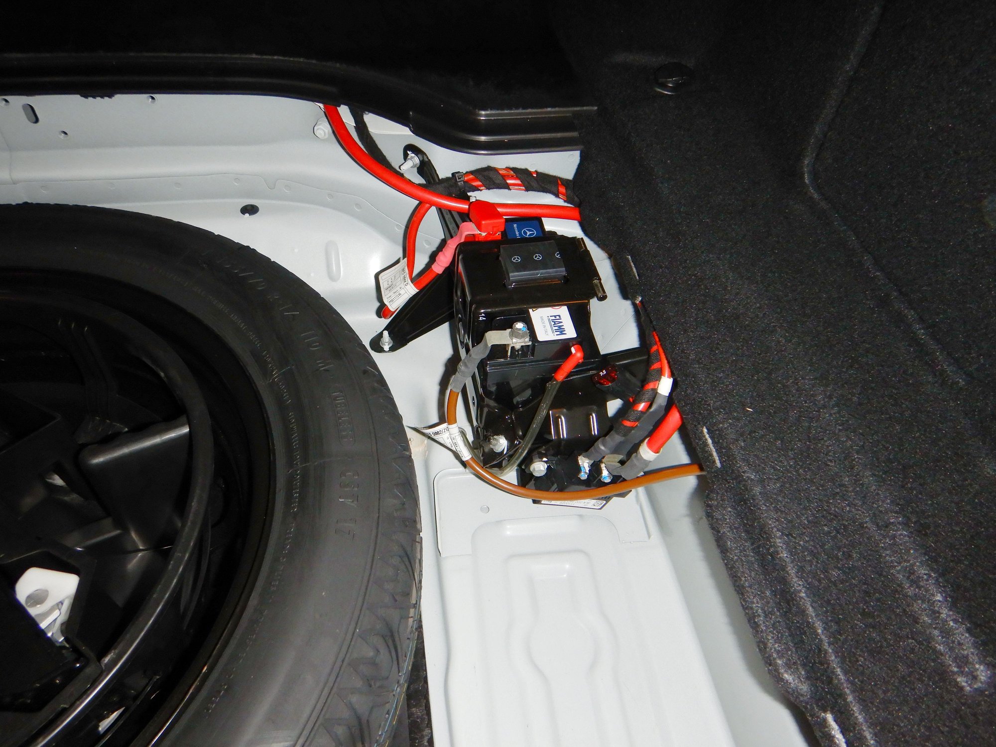

I'm not aware of any battery with an unlimited life, regardless of how it's treated. Aux batteries that I'm familiar with are sealed lead acid (SLA) types, the same technology used in devices such as UPS (uninterruptible power supply) applications, where they are on constant float charge except when serving their purpose. In my experience, SLAs can last 5 to 10 years depending on how they're used. Your aux battery might not be SLA, but whatever its type, it's unlikely to last forever.

Being a 2016 model year, it should be at the trunk, besides the mini spare tyre.
Go and find it.

Confirmed the aux battery is in my 2016 E's trunk as well, right next to the spare.

This looks like an SLA of the type used in power sports, lawn mowers, etc. Easy to find and eady to replace.

AUX IS VENTED
This is a particular SLA type called AGM with a VENT port to exhaust explosive hydrogen out of trunk enclosure...
vent pipe connection

thx for pointing that out
I'm pretty sure my main battery is also vented w/ a tube connected on the side, so will make sure to re-connect it after swapping out the battery

Don:t buy the wrong ATV battery
your vehicle requires a vent port.
