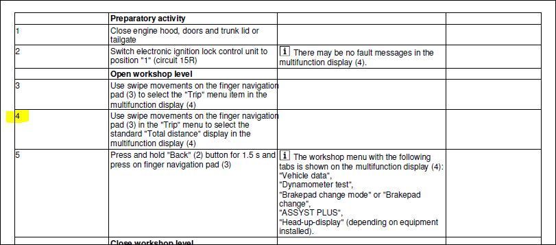

How about this...

How about this...
Those are the instructions I used. On step 5, I don't get the workshop menu. Could it be that I get a message stating that "Service A3 Due" in the nultifunction display when I switch on the ignition?

I don't know how I did it but it worked! I think the key is when you're in the trip menu and hit the back button (step 5 in Konigstiger's post) to very quickly press the center button on the navigation pad. That gets you into the workshop menu. If you're not in the workshop menu, start all over again. It's not easy, and it's likely to take several tries. Many thanks to those who responded to my post.
