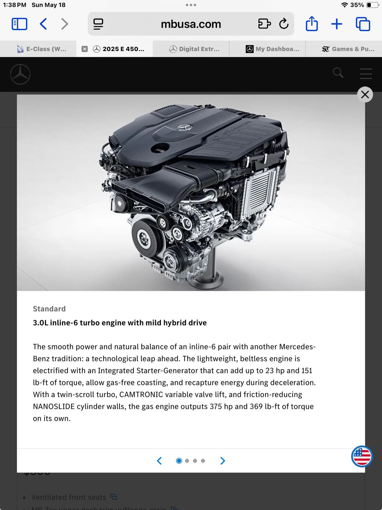

One thing that puzzles me is the pic on MB’s website of the 3.0 liter engine described as a lightweight beltless engine clearly showing a serpentine belt driving an alternator and a/c compressor.
Mainly talking about accessory drive:
https://mbworld.org/articles/heres-m...-improve-cars/
https://mbworld.org/forums/s-class-w223/896576-mercedesi-straight-six-engine-m256.html
https://forums.beyond.ca/archive/index.php/t-401007.html

This is the proper pic of our 3.0 liter engine. It’s wrong on the website for our E 450.
Sorry for veering off topic.
I see so the CLE 450 configurator page shows the right one but not the E 450.. Interesting.
