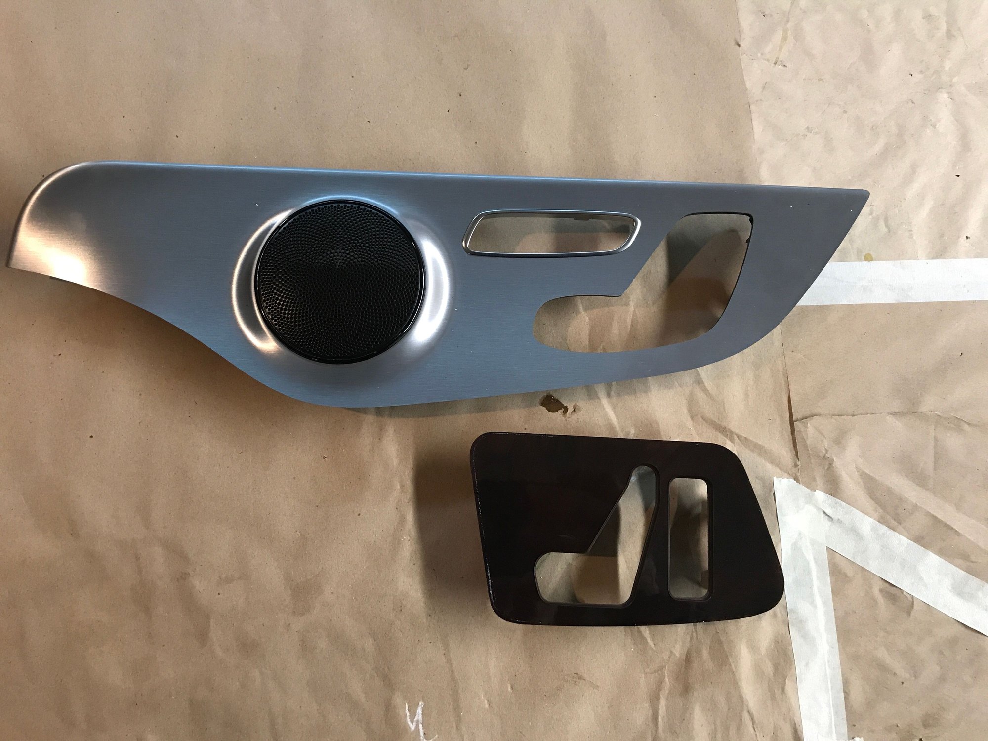

I am also going to be installing seat switches from 2016 E-Class W213. I am integrating W213 seat switch trim into my original G500 seat switch trim. Here are some pictures of how I did it.
Using 3M 2K panel adhesive.
Once everything dries, I will bondo the front to smooth it out, prime it and paint it gloss black.

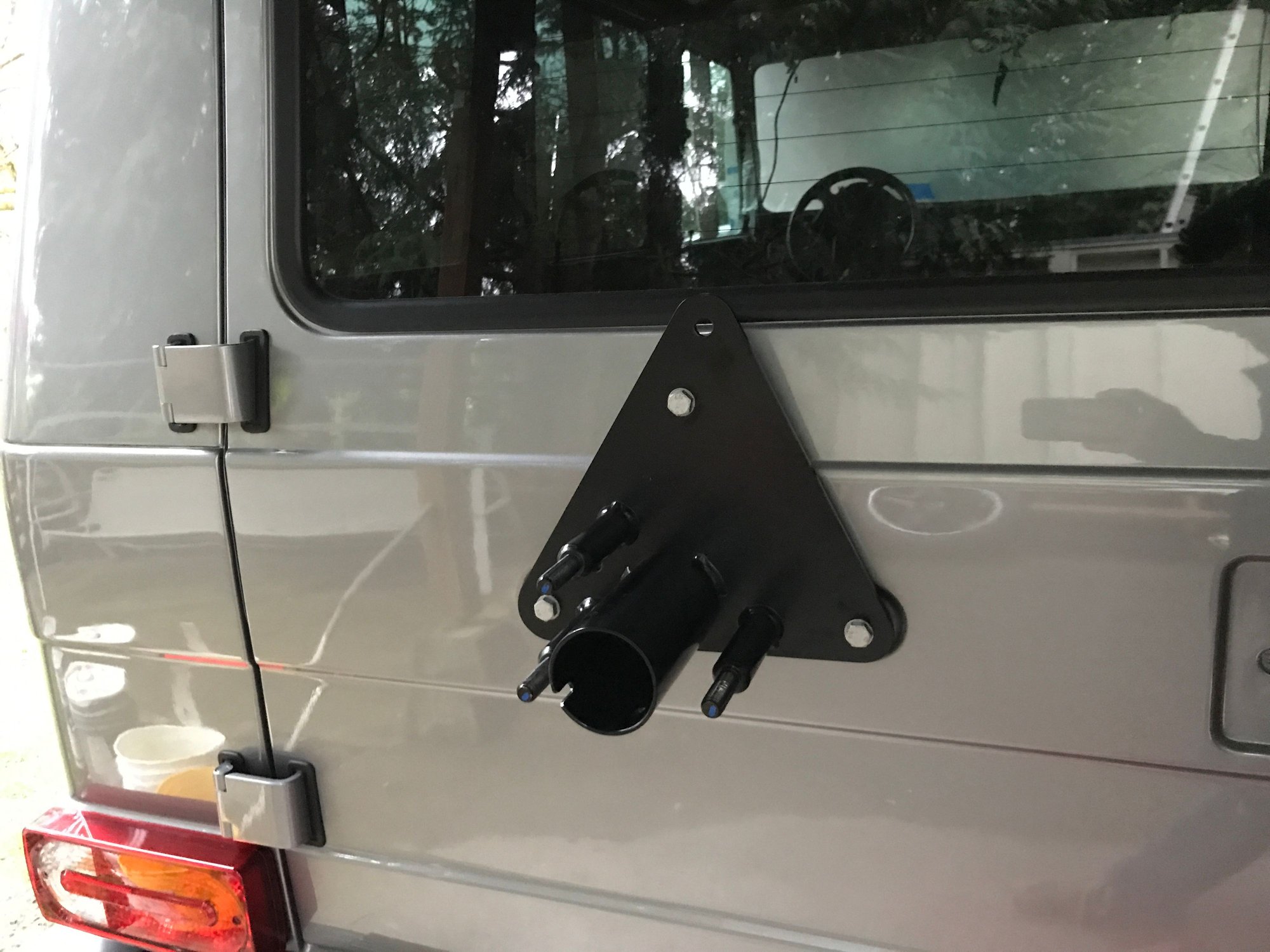

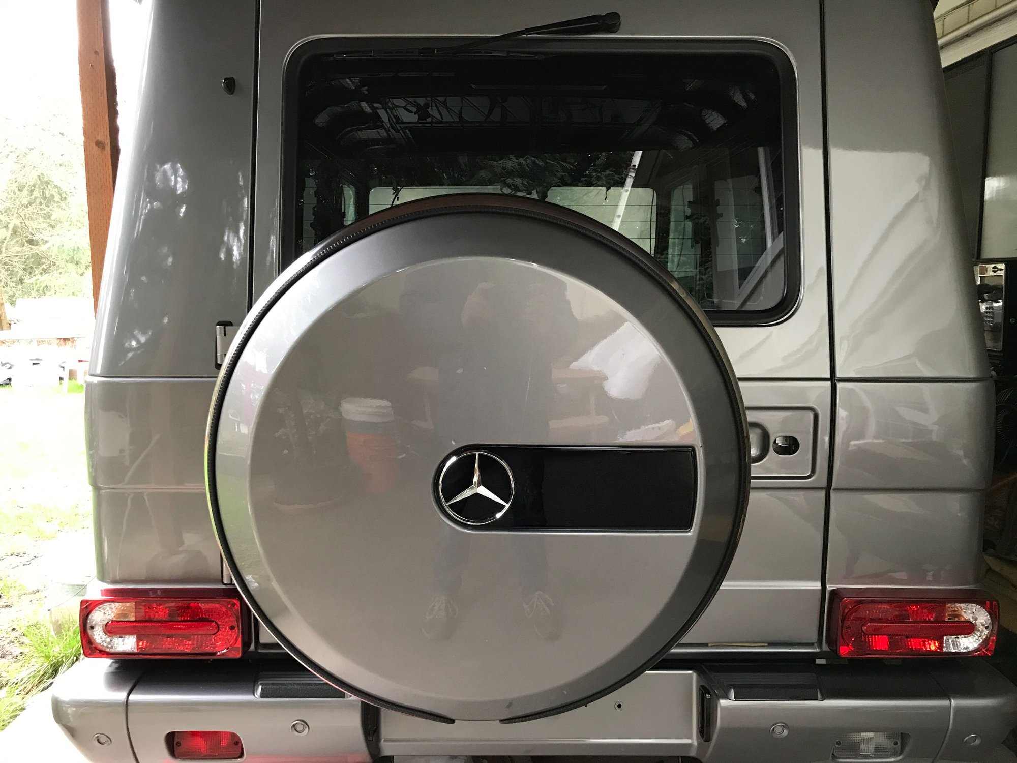

Installed rear wiper and spare tire mount
