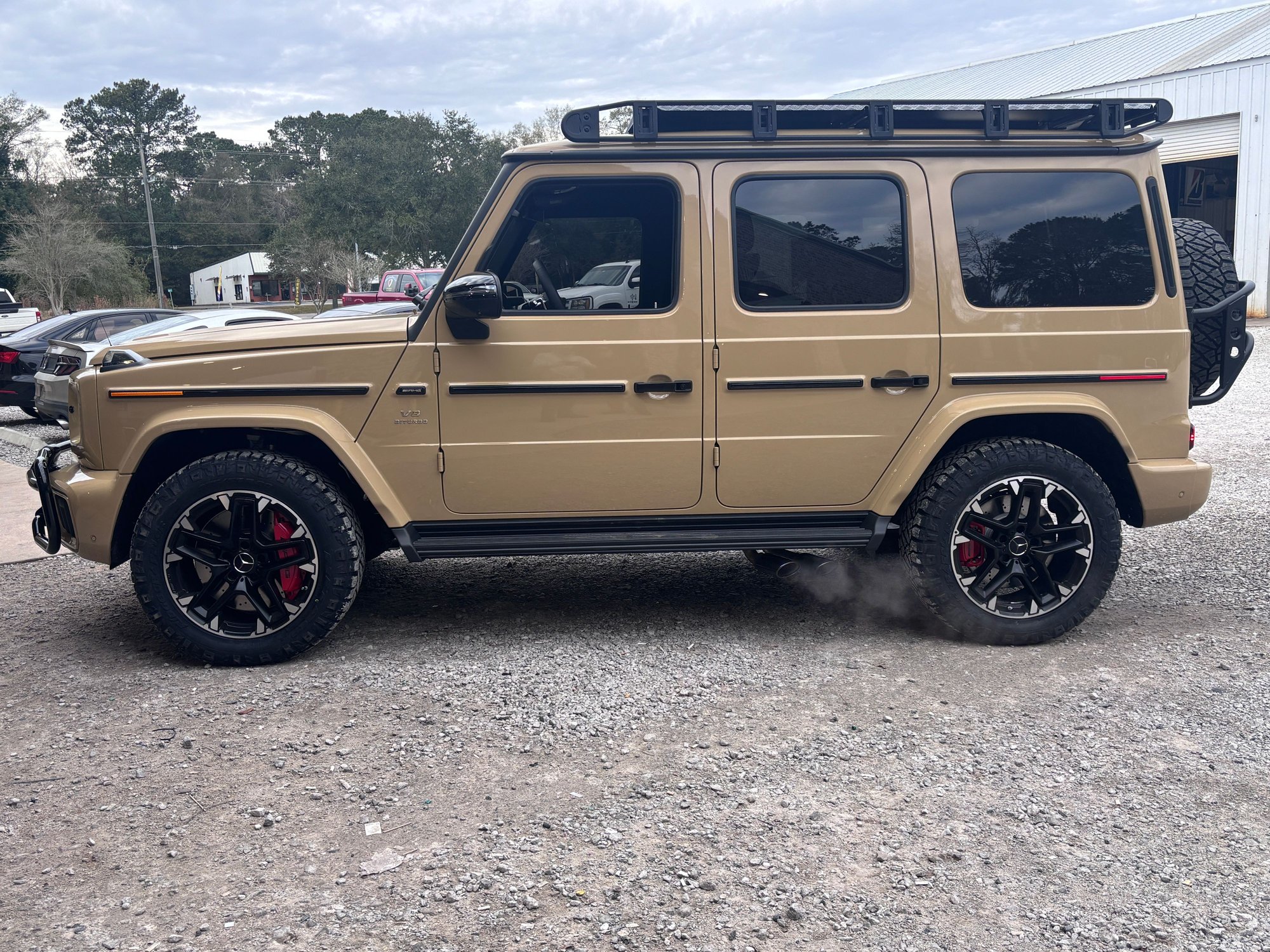

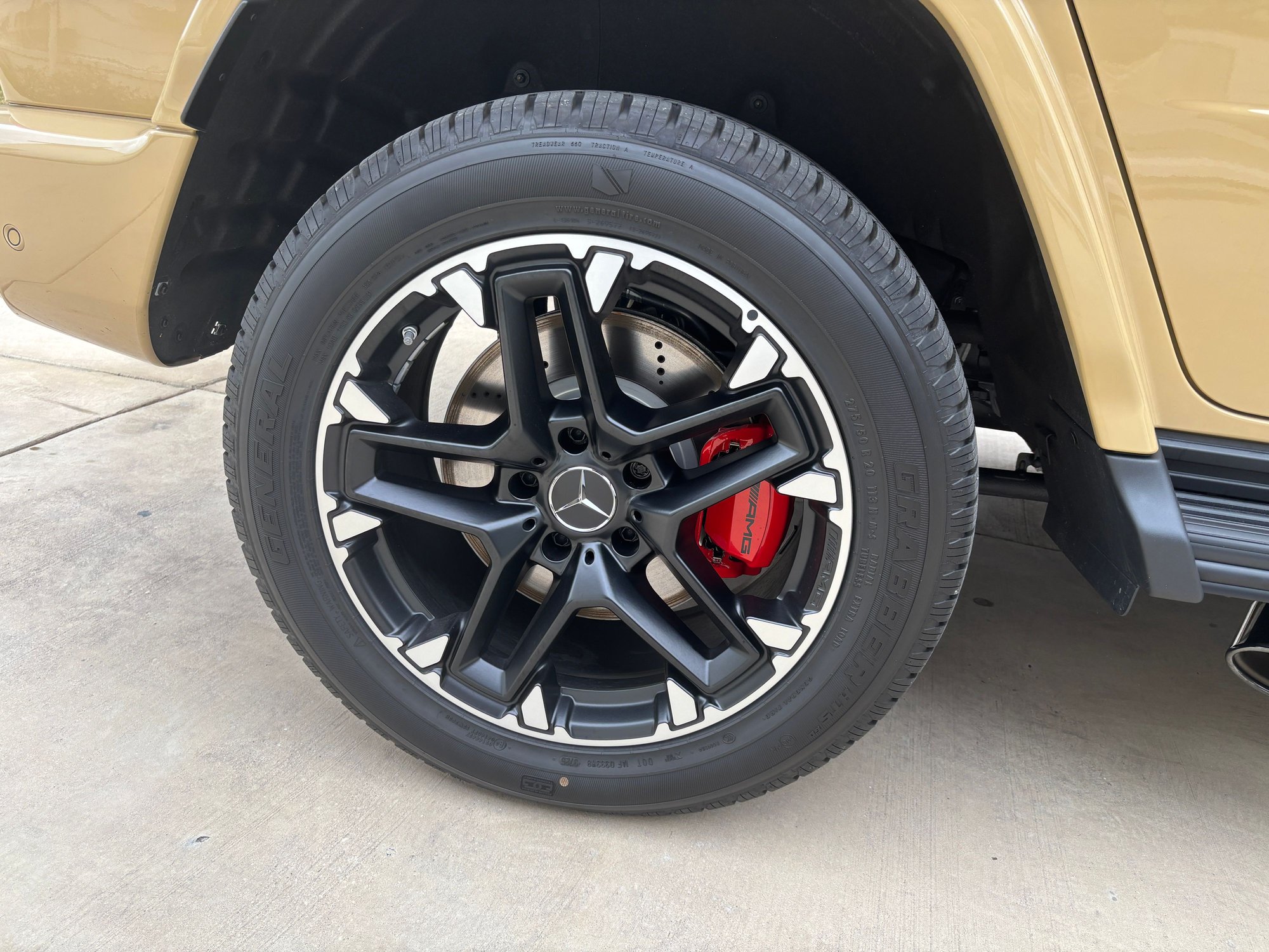

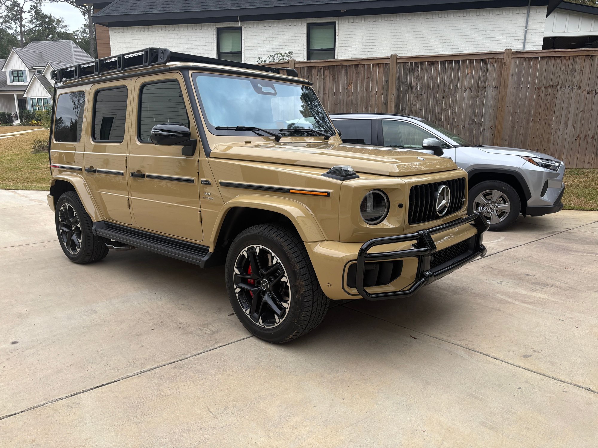

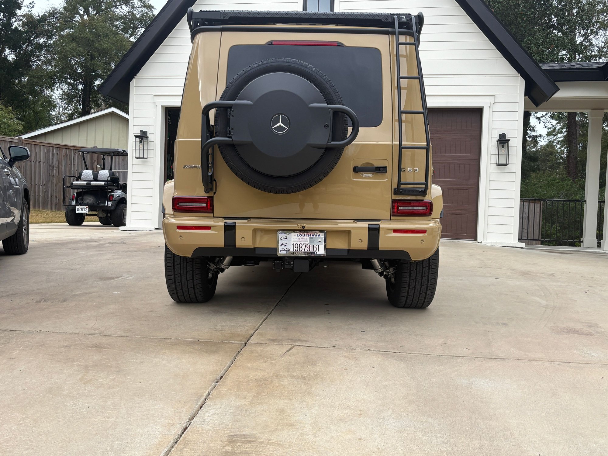

I just took delivery of a 2026 G63 with Off-road Pro package. The only available wheel with this spec is the 20” which I like more than I thought I would.
But the tires just look undersized to me. I’m thinking about doing Ridge Grapplers which have a much more aggressive sidewall.
Does anyone know the max tire size I can run without any rubbing? Factory size is 275/50r20. 285/50r20 seems like a safe bet, but I’m wondering if anyone has done larger. Also thinking about 21mm wheel spacers for a slightly wider stance.

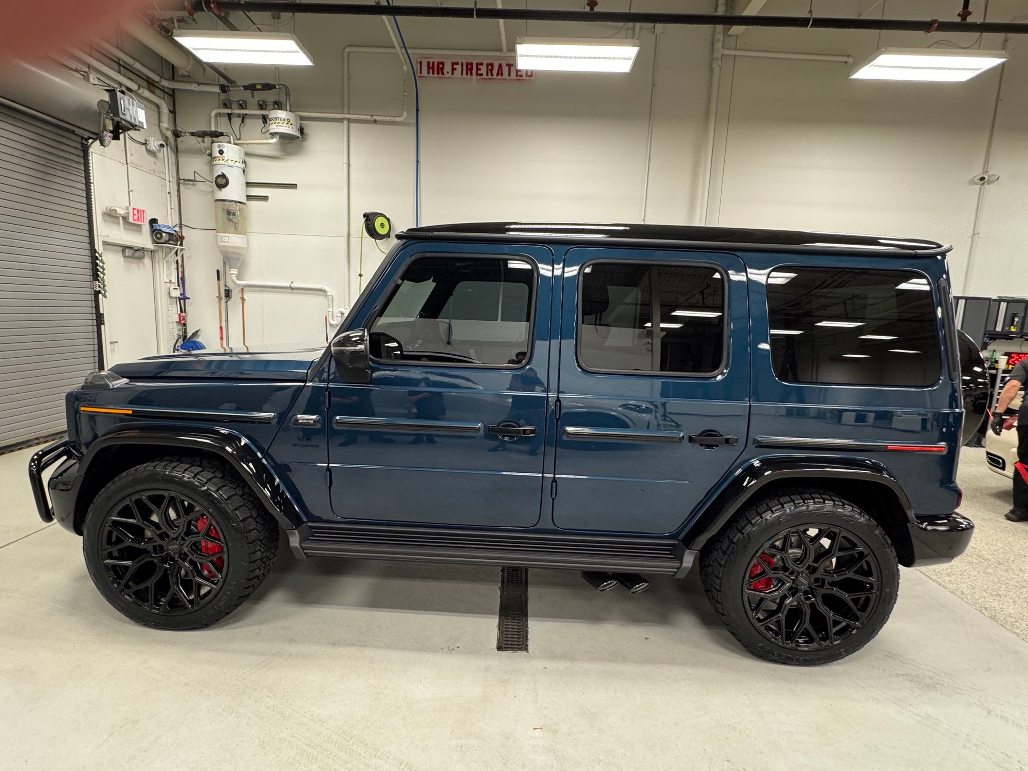

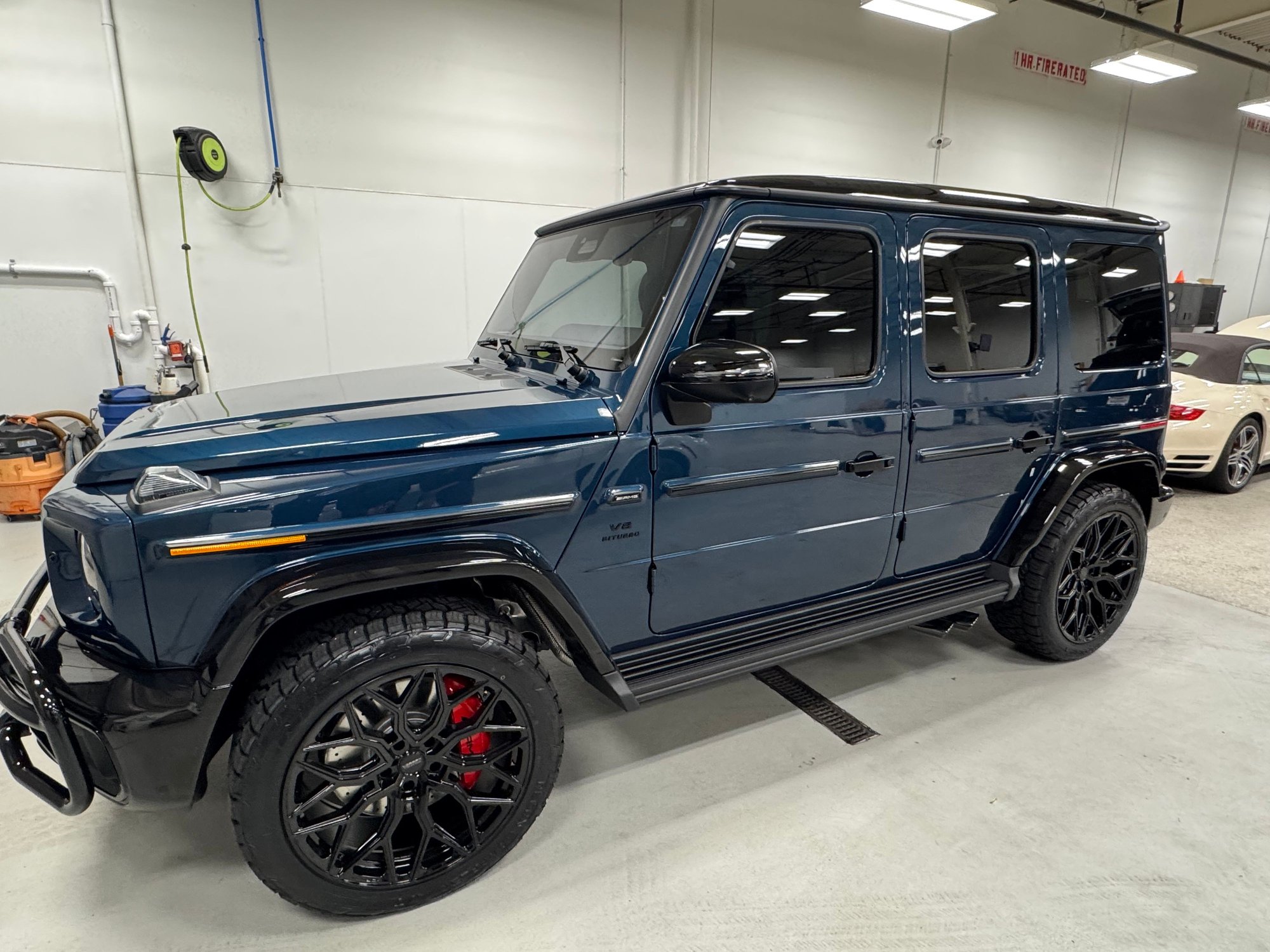

Great build and color - looks amazing with the offroad setup. I just put NITTO Recon Grapplers (285/45R22 on Vossen HF-2 wheels) on my 2026 G 63 for the winter and they ride great - there is some additional road noise vs. the summer tires but nothing harsh or loud. I also like the chunkier look of them on the G 63.
Reply 0
Dec 28, 2025 | 07:14 PM
Quote: Great build and color - looks amazing with the offroad setup. I just put NITTO Recon Grapplers (285/45R22 on Vossen HF-2 wheels) on my 2026 G 63 for the winter and they ride great - there is some additional road noise vs. the summer tires but nothing harsh or loud. I also like the chunkier look of them on the G 63.
I bet that looks phenomenal. Can you post a picture?
Reply 0
Explore
Dec 28, 2025 | 08:34 PM
I had Ridge Grapplers, but if I ever do A/T tires again I'll do the Recon Grapplers.
I never had the Ridge's long enough to hear loud road noise but plenty warned me about it.
Reply 1
Dec 28, 2025 | 08:37 PM
Quote: I bet that looks phenomenal. Can you post a picture?
Here you go….I have black monoblocks with summer tires that I was going to put on once its warmer but I may just keep these on year round.
Reply 4
Dec 28, 2025 | 08:46 PM
Yea those look great. Thanks for sharing

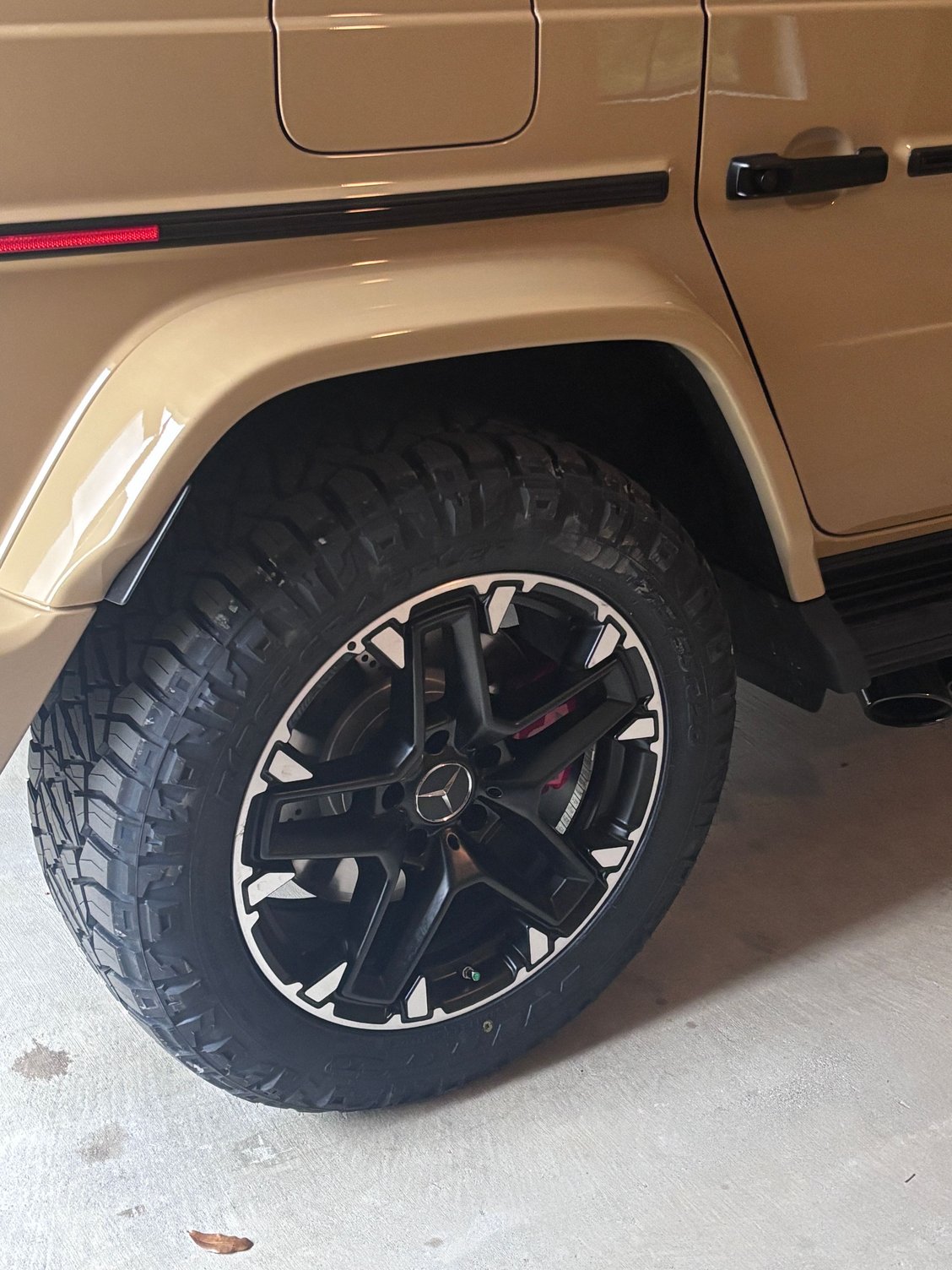

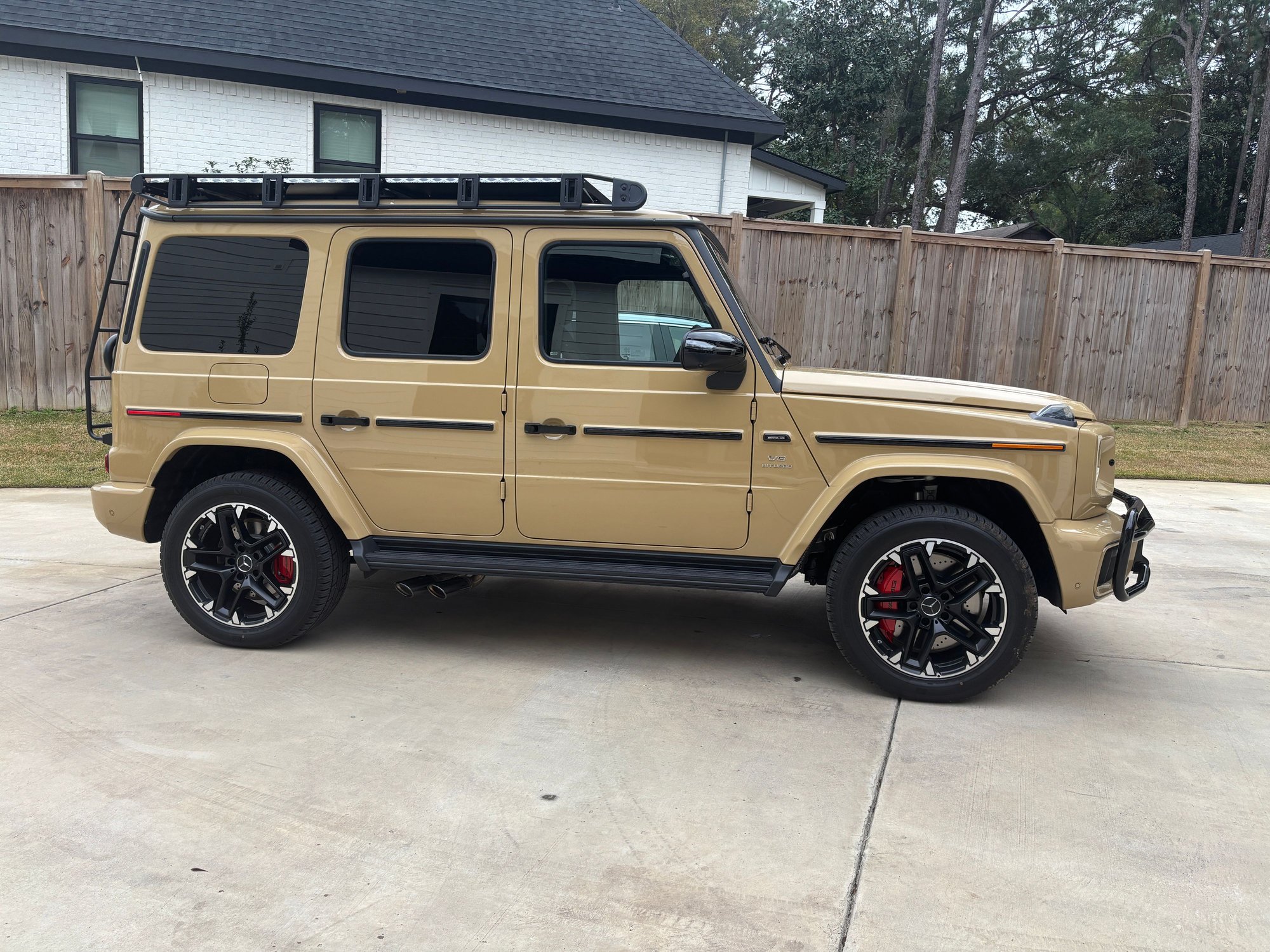

I ended up going with 275/55r20 Nitto Ridge Grapplers. It makes sense you fit 285 KO2's since BFG tires notoriously run small.
Reply 0
Feb 8, 2026 | 12:29 PM
That looks great! Did you change the spare tire as well?
Reply 0
Feb 8, 2026 | 12:46 PM
Quote: That looks great! Did you change the spare tire as well?
yes
Reply 1
