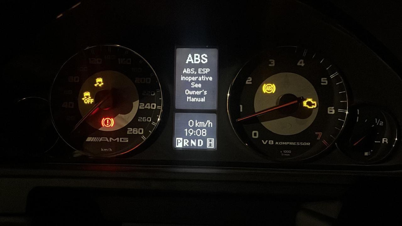

Hay all,
it just used to be intermittent, but now is permanent. Turning on and off the ignition ain’t helpful- faulty code is still here.
checked the fuse box by the driver side- all seemed to be okay.
Big socket by the ABS pump- all the pins are clear and seems to be okay. Plug and socket looks good.
Any other ideas where to look?
(patient: G 55 AMG 2011)

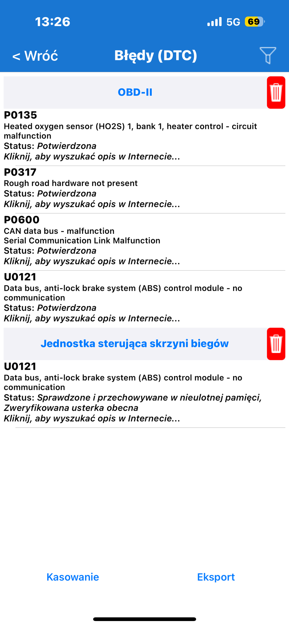

With DTCs reported as communications faults and now no speedo, I'd inspect for wiring damage. Any evidence of rodents snacking?

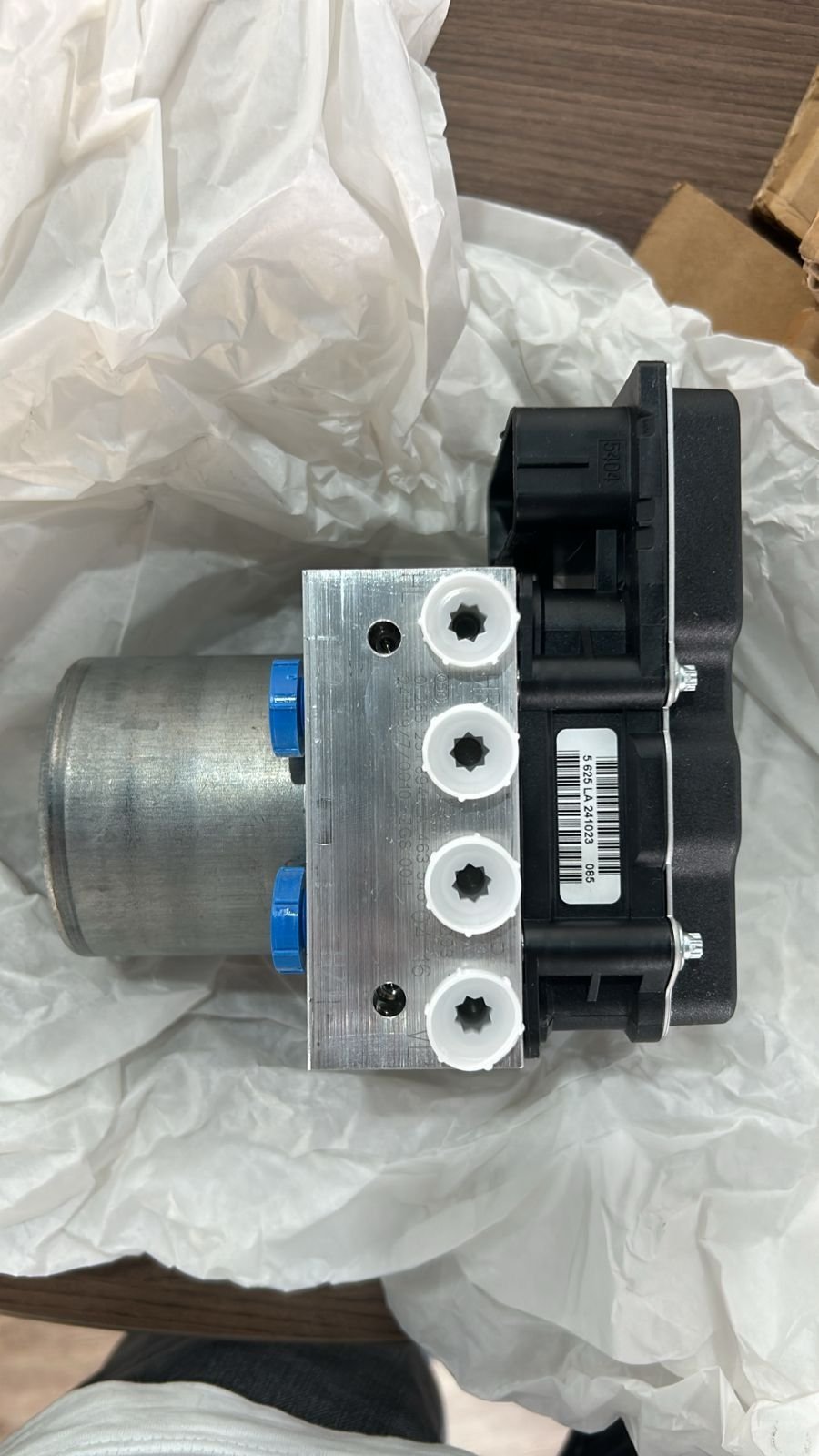

Yes. It was a ABS control module…: managed to repair it but usually u gotta buy new one.

Unfortunately, we already replaced it a few months ago ($$$), but issue came back! Maybe some short circuit or bad wiring?

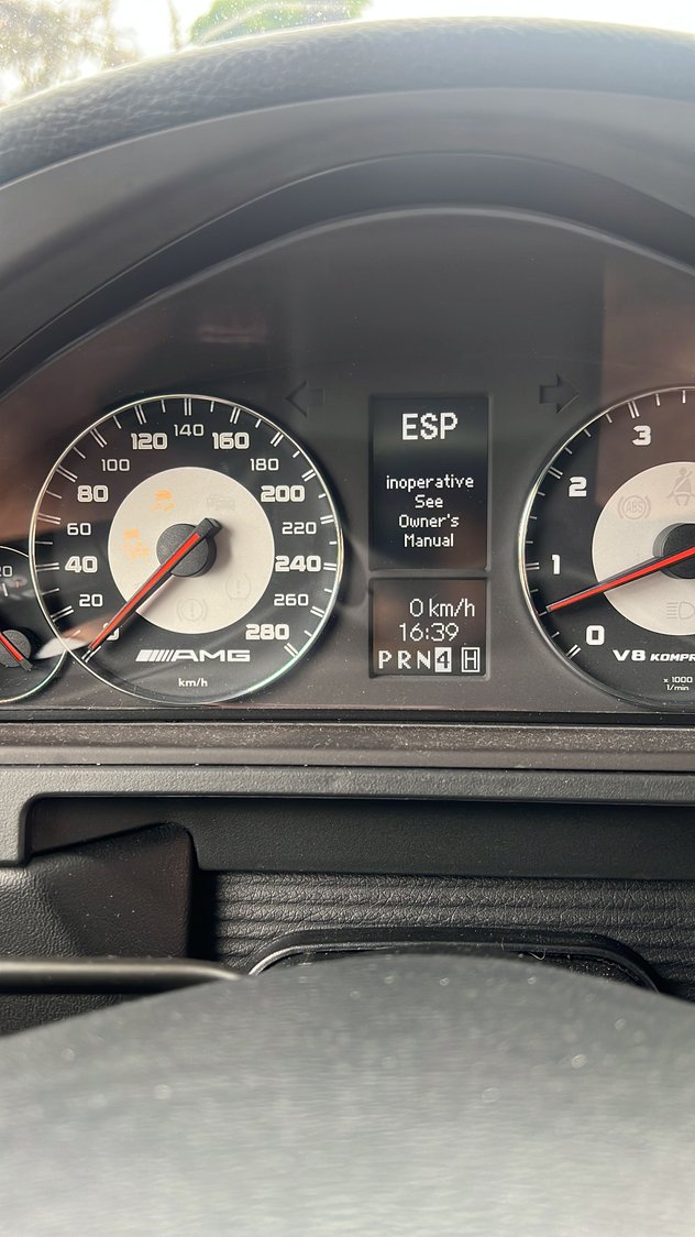

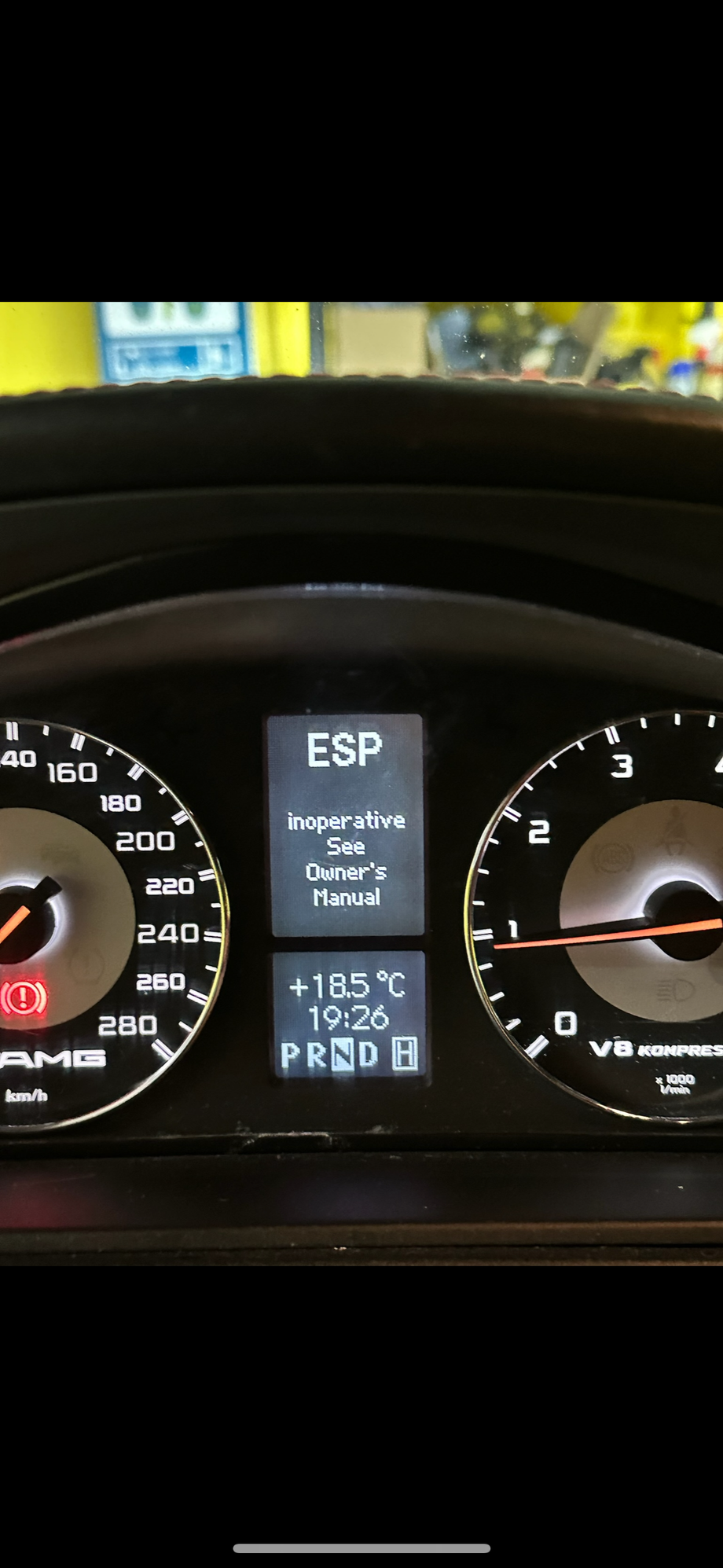

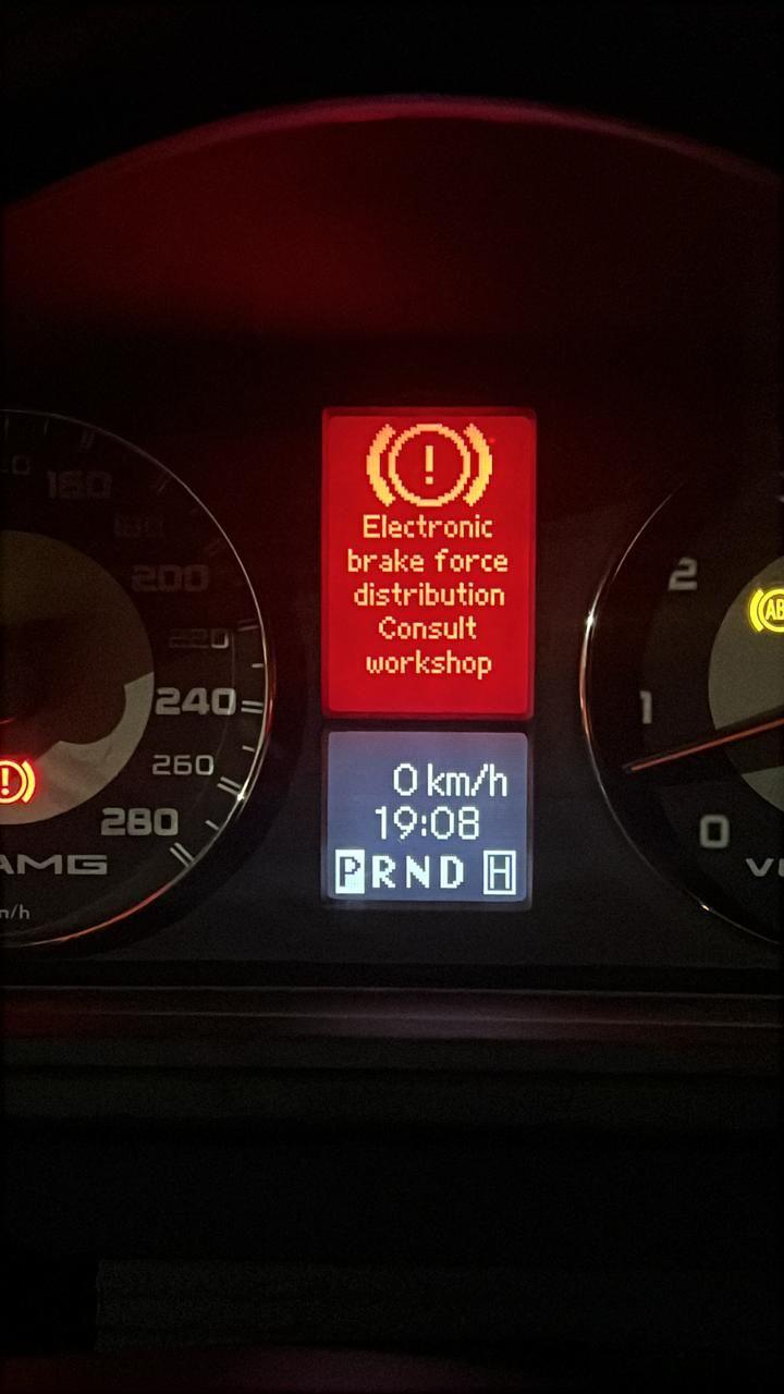

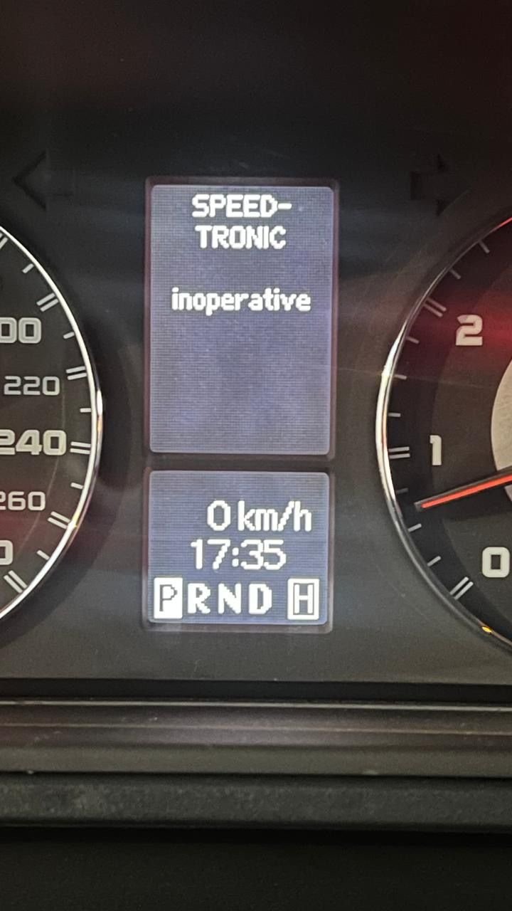

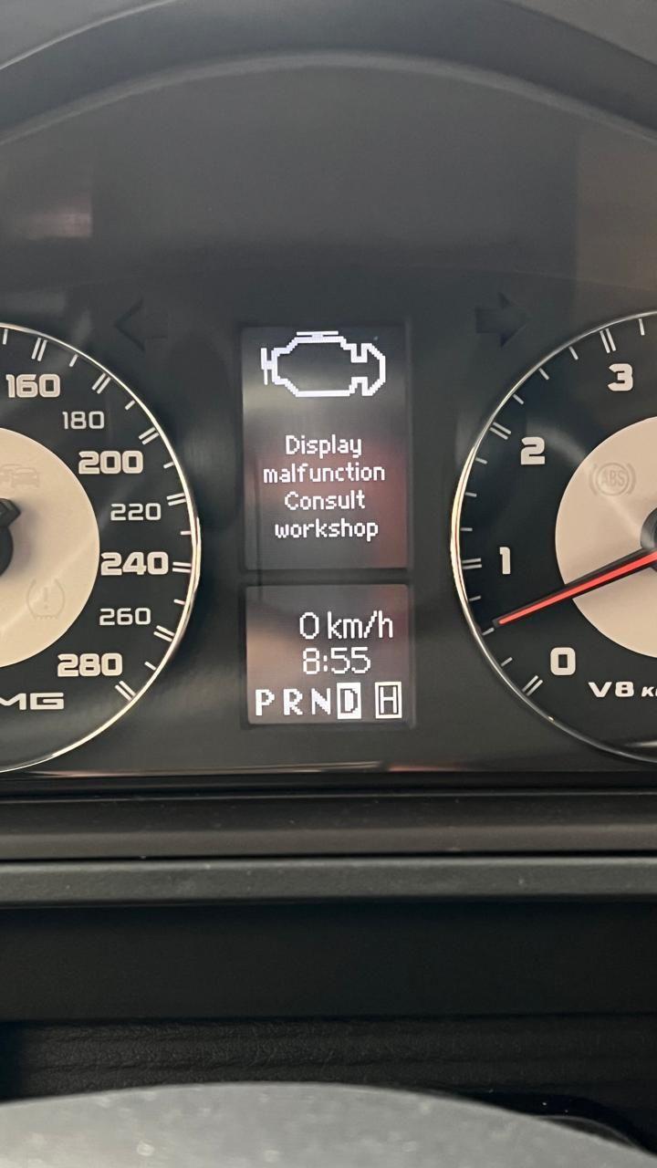

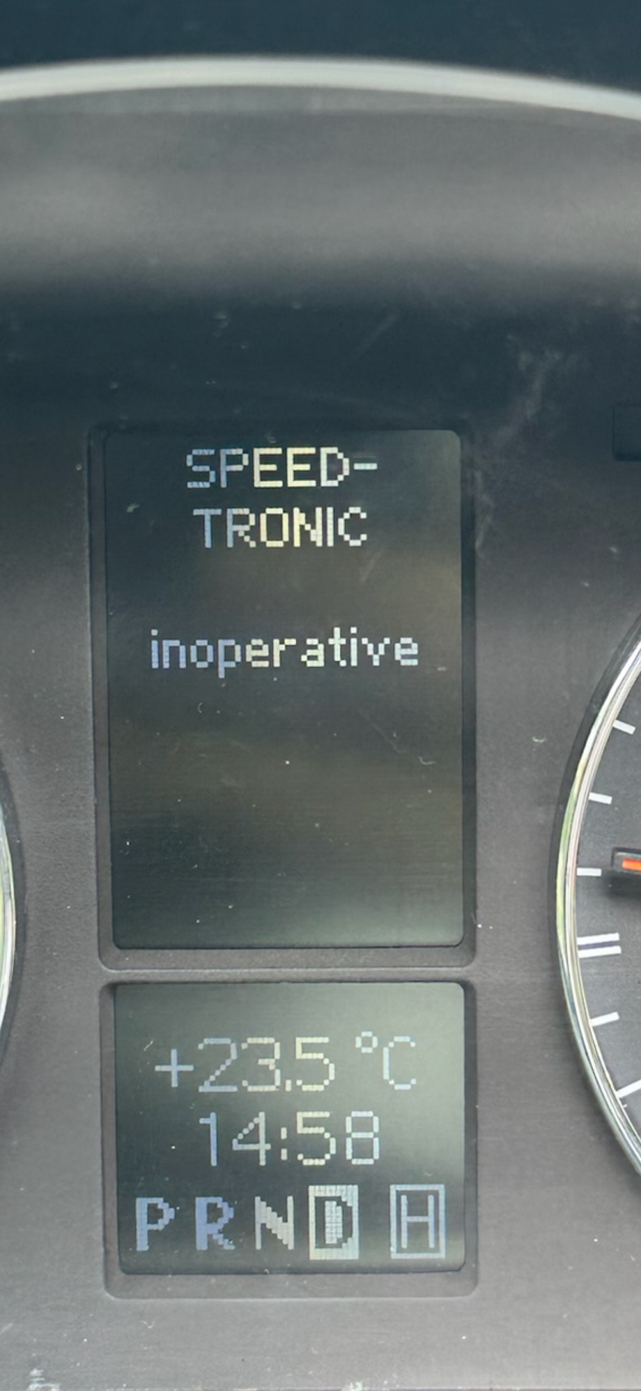

When the car starts, usually AAS “consult workshop” appears and sometimes the engine fan starts working even when the car is still warming up.
Some days only these two happen and on other days I have several warnings such as yours (ABS, ESP, speedtronic, brake distribution, display malfuncion, check engine light)….pics below.
Dealer suggested the ABS module replacement but still the same issues. Now they are thinking about sending a support request to the factory.
Strange (and good) update but, researching, found out that there were cases about key communication failure. I switched to spare key (brand new) and no more errors! 🙏🏻🙏🏻🙏🏻 one month daily driving it and zero warnings so far….
