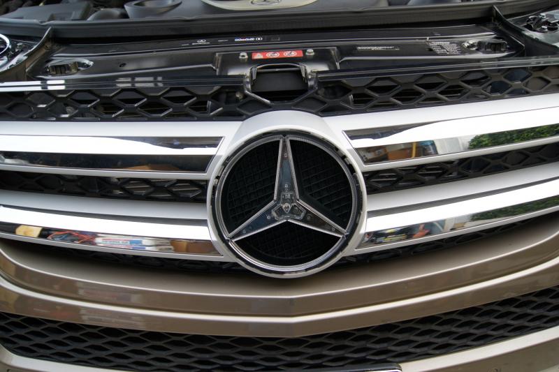

Guess what ???
Illuminated Star is on !! who said it is impossible ? Took me 30 min to install...
Attached Thumbnails GL450 X164 few upgrades with Part Numbers-dsc04177.jpg   GL450 X164 few upgrades with Part Numbers-dsc04178.jpg

Originally Posted by wally AMG
Guess what ???
When are you taking it back of to add Distronic?

did the illuminated star fit the diameter of the old logo perfectly? How about the wiring tie in? I think it is a cool accessory,
Yes, diameter is the same, fit perfectly, but you need to make about 3 small cuts to the grille to make it fit perfectly, I use a dremell, star look like is a factory accessory, about the wiring I will do it next week.
Cuts are basically inside of the grill, where star will be attach, no worries ...
