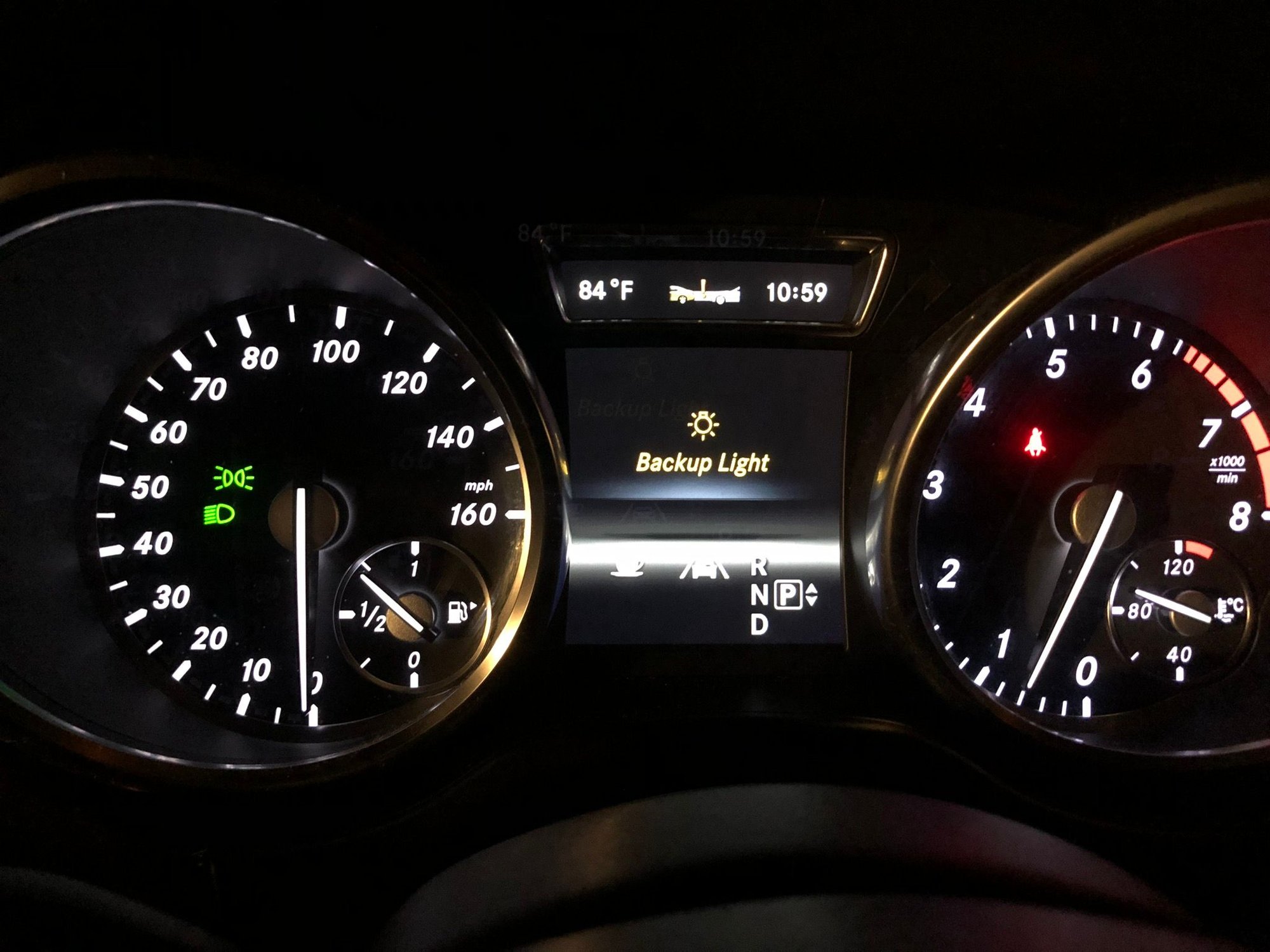

Update 9/17/2019. I attempted to install the bulb mentioned above in my 2013 GL550, last night after removing the tailgate trims and started the car but came up with an error 2 minutes into testing it. White LED Flashes 3 to 4 times upon startup. Then I shift to park. Shift to rear again and LED is bright white, but after doing this 1 more time, the dash gave me an error:

Hmmmm I may have installed a hidden bulb. I will get my buddy to pull my panel off if he comes over this weekend and the wife doesn’t take the GL to the condos.
2013 GL550 LED bulb error
Based on earlier post, I just purchased this bulb but have not installed it yet. It looks like I made a mistake........If anyone has it installed and working, please advise.
