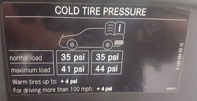

The difference between the two figures on the door pillar is 4psi, which is Mercedes specification for this model/tire configuration if speeds exceed 100mph. FWIW, I have a 2020 with the 19-inch wheels and the tire pressures in the door pillar are the same as shown above for the 2021 with 18-inch wheels (35/42 and 39/46) -- again the two stickers differ by the 4psi. I view black the sticker with the VIN as the "recommended" inflation pressure, and the white as the maximum recommended (reflecting the +4psi if you will be driving over 100mph).
In my fuel filler flap it shows "normal load" as 32/32 and maximum load as 35/42 with a note to add 4psi for driving over 100mph. 32psi seems just too low -- I have NO IDEA what they were thinking there, and the maximum load figures match the door stickers (35/42 or 39/46 if you add the 4psi for high speed driving.

Question 3 stickers and 2 tires
Door Sticker 1
Door Sticker 2
Gas Door
Summer Tire
Winter Tire
Door sticker 1: 45 front, 48 back
Door sticker 2: 45 front, 48 back
Gas door normal: 35 front, 35 back
Gas door max: 41 front, 44 back
Summer tire: 50 max
Winter tire: 50 max
This is on a GLE350 diesel (SUV), 20 inch rims.
I've tried a few PSI (35, 40 and MAX) and the best ride was 40 PSI (cold). The GLE handled well and ride was comfortable. Tire guy said to keep below the tire max (50psi) when the tires are warm (meaning below 46 PSI cold). He didn't want to commit to what was the best pressure - smart for a guy that looked 17 years old
I appreciate all the opinions in this thread but does anyone have access to MB's official data?
