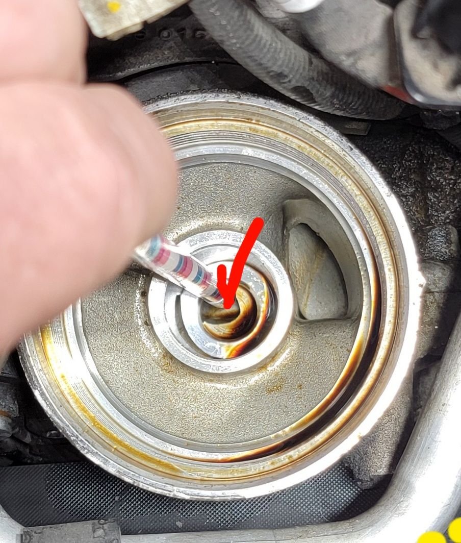

Next up, this photo shows the three "oil passages" inside the oil filter housing
a) I assume yellow is where oil flows into filter
b) The blue is, I guess, is where oil flow away from filter and back to engine
c) Not sure about the red passage - notice the hole is not perfectly round - the hole is crescent-shaped.
The red is where the wheel dropped down into.

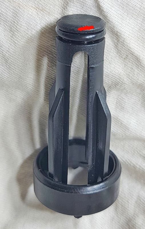

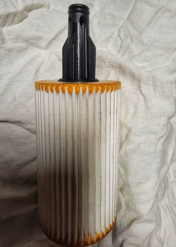

The oil filter my engine uses has a "snout" with a o-ring, and that snout drops down and "blocks" the crescent-shaped hole.
Here's a photo of me holding a pencil just above that crescent-shaped hole, where the wheel fell

So here's my question to all the GLK experts here ... if something fell down that center crescent-shaped hole, do we know "where it went to"?
Did it drop to the oil pan? Did it slide into an oil passage? Did it drop to the oil pump?

But what I'm still curious about is, "where does that hole lead to"? If if drops directly to the pan, a retriever may not find it, but if we drop the pan, that thumb-wheel might be laying there.
Or does it lead to the oil pump? Or ....

The thumbwheel is likely in the housing for now. An oil filter housing is easy enough to pull off. Take it to a bench and fish it out there.

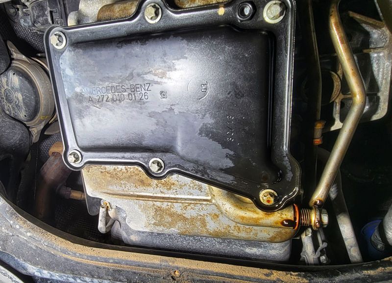

My best guess is that center hole is the drain that leads right to the oil pan, so when the filter is loosened that o-ring moves upward and allows the oil to drain out of the filter housing. Look under your GLK, it may have a small steel oil pan; if so it's easy to remove it and check for your thumbwheel. You should replace the pan if it's steel, as they warp when removed. You can also try your flexible magnet through the oil pan drain hole first.
Image of my filter at bottom (it's a one piece filter - the snout is not removable). Notice the tip of the snout has an o-ring.
If you measure the length of the snout, it drops down into the center orifice and seemingly "seals off" the lower crescent hole, disallowing oil to push upward or oil to drop down into the crescent hole.
So your reasoning seems sound, that when the filter is pulled out, the excess oil in the housing would drain down into the crescent hole.
Great idea to snake the magnetic retrieval tool in through the oil pan drain hole first !! Hadn't considered that !
Finally got around to check the pan ... you can see the drain bolt at lower right and then the oil pan "cover".

I have some new photos here, with different perspectives.
1) The first photo is a different angle and zoomed in bit, and I've marked the different orifices, as I did in my first post ...
(r)ed is the crescent-shaped drain (where part fell)
(y)ellow, I assume, is where oil is pushed onto the outside of filter and forced inward, and
(b)lue is "drain".
2) second photo is the snout of the filter (I cut it away from filter). Notice the o-ring and that the extreme end of the snout seals off the (r)ed crescent-shaped orifice.
3) third photo is the same angle as photo #1, but with the snout snapped in place. Notice that the extreme end of the snout has sealed off the (r)ed crescent-shaped orifice. We can see that the (b)lue orifice is obviously exposed / open and available for oil flow.
I think @E55Greasemonkey assumption that the (r)ed orifice is a "drain", so when you pull out the filter, pooled oil now flows down into (r)ed.
