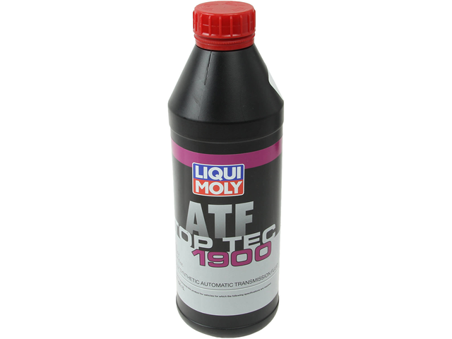

I got the transfer case fluid from FCP euro. I guess from now on, my fluid change parts will be free. I got a box of washer and the product AT205 from amazon.
This is my transfer case. It looks pretty clean, it doesn't look like it leaking anymore. Hopefully it will stay the same. I think from now on, I will change the transfer case fluid more often

The ML350 transfer case still use the red fluid. I wonder if I can use the new blue fluid, don't know if that will make it better or worse, but for now, I used what Mercedes recommended, the red fluid.

-my transfer case fluid was bad, and am surprised the volume is so small. planning to change yearly, got sold on royal purple product, using synchromax.
· I just used the OEM red fluid. Make sure you change them often before it leak. I think mine is fixed now with the AT205. last time i changed the trans fluid, i didn't notice any leak
· What is the royal purple product ?

I recently changed my Transmission Fluid. This is my second time doing it on the 722.9 transmission. I did it once on my GLK, but I didn't drain the torque converter at that time. This time I did drain the torque converter. Honestly, it was very very satisfied to see extra 3L of dirty fluid coming out. Draining the torque converter was a lot more easier than I thought with the ML. All I have to do is use a 27mm socket to rotate the engine and the access hole are very easy to get to. I didn't know that there is a washer for the torque converter drain plug, so I didn't ordered an new one. I re-used the old one. Hopefully there will be no leak. The other thing is I didn't really do a good job this time since I got a call for overtime halfway while i was changing the fluid. I rushed and finished the job. I didn't even use the torque wrench to torque the 6 bolts properly. Oh well, when i did a final check, there was no leak, but i guess i will go check it again whenever I have time and not super cold. And i even invested buying one of the expansive torque wrench that has the digital display with audio alarm sound when I reach certain torque, just way too tired that day.
I used 10 Liters of fluid to do this job
This OEM Tools pumps really makes the job easy. And it comes all different type of adapters

I have a 2013 Mercedes Benz ML350. I wanted to know what transmission fluid I should use for the change. I’m not sure if the old fluid is red in color and I’m not sure if the new fluid comes blue? I read that ATF 134 is the correct application but I wanted to reach out to you on this question along with where you purchased the manual ATF fill pump. Thank you!! 👍👍
The fluid in your transmission are suppose to be blue. I believe model after 2011 are all blue transmission fluid, double check with your V.I.N with fcp euro or your dealer. When you drain your old fluid, you gonna see black if you never service your transmission before, and they smell. The ATF pump i cant remember where i got it, it either from fcp euro or amazon. Make sure you get the one are specific for Mercedes

So this is what I ordered:
Liqui Moly ATF, Automatic Transmission Fluid; Top Tec 1900, 1 Liter
P/N: 20028
1
x
$14.49
Liqui Moly Differential Oil; Synthetic; 75W-90, 1 Liter
P/N: 2048
2
x
$14.79
I'm concerned I purchased the wrong stuff.... Any thoughts? Thx!
Anthony

The transfer case fluid, u got the updated one. But somehow Mercedes still recommend the red fluid over the blue for the transfer case.
For the diff fluid, there are huge debate in the forum. Some people say it ok and some say it doesn't meet the MB requirements. I personally wont screw around with any of these fluid since the parts are expansive to replace
