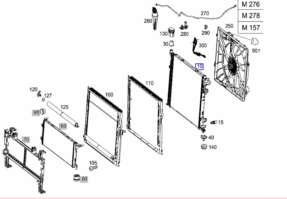

The EPC shows a different part number. But the description implies an integrated transmission oil cooler. The radiator is item #10. Not sure what item #100 is, but it seems to be the AC condenser. Grayed out numbers are not applicable to the model identified.
I am at a loss....

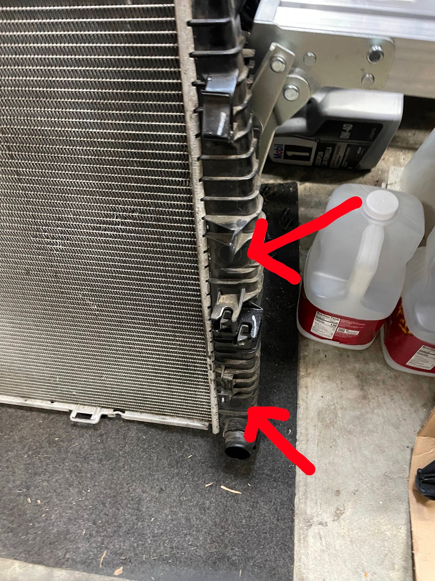

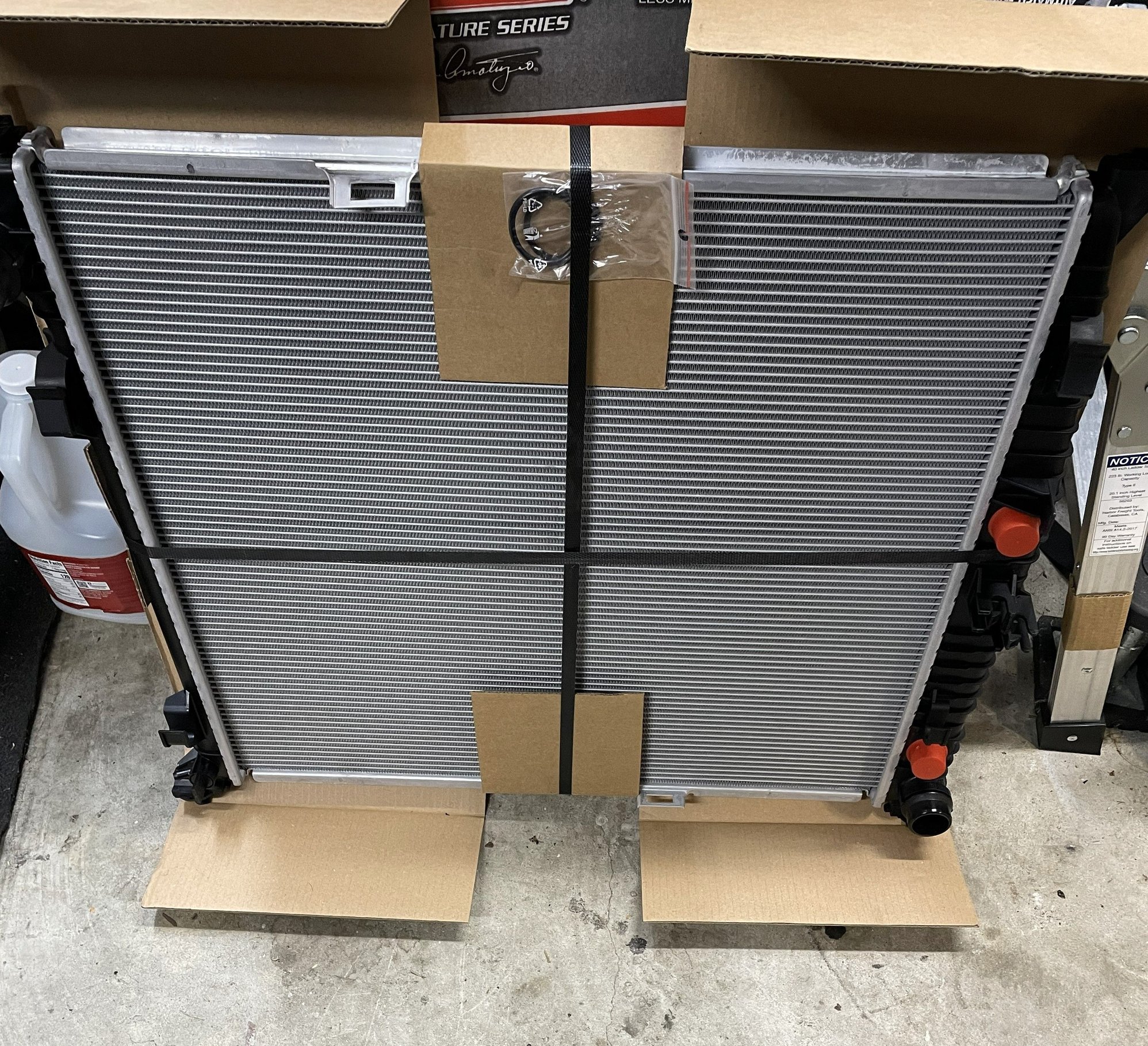

I just replaced my radiator on my 2013 ML350 yesterday with Nissens 0995001303 SKU067188 (which FCP says its a fit). Like the OP, my original radiator does not have transmission line connects, however, the radiator DOES FIT. The holes are there for, I assume, later models that connect to the radiator. Looking at my original, you can see where it looks like it could be plumbed for the connects but was not.
New
New
Old
Old
No connections
No connections
Connections
Connections
New
New
Old
Old
No connections
No connections
Connections
Connections
Exactly what I was looking for.... thank you very much.
What dud you do with the ports? Plug them? (with what?) Or just leave them bare?

I just left them bare. They are not pressurized. I started to leave the caps on that were provided but I did not want clearance issues when the tranny lines were put back into place. You will have to transfer the top radiator mount rubber bushings to your new radiator.
