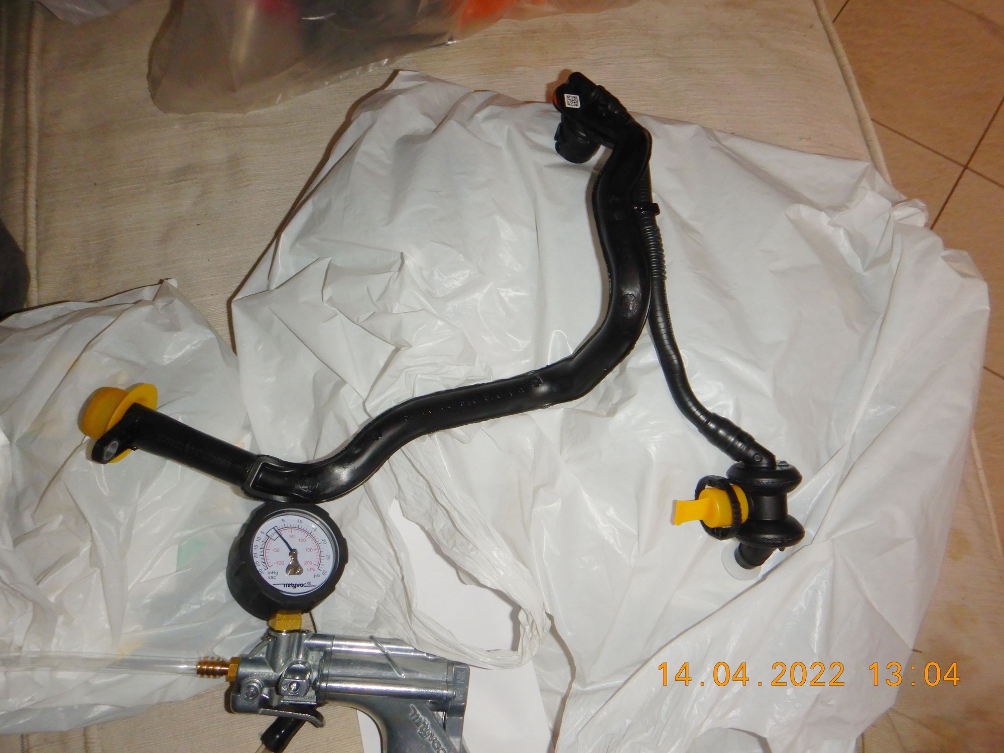

i've changed the PCV 4months ago when we had discussion with you on private

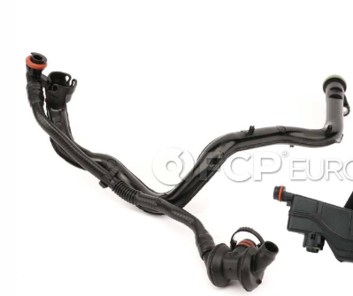

this is the one i had https://www.fcpeuro.com/products/mer...des-2760107111
by conduit pipe do you mean this https://www.fcpeuro.com/products/mer...nuine-mercedes
if so we checked it and we didn't notice bad flow when we test it

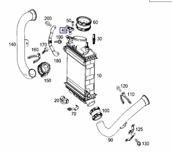

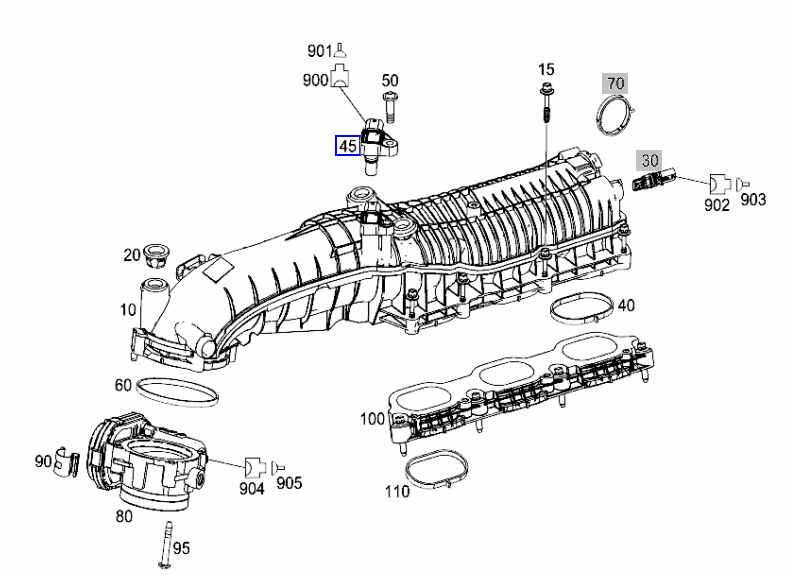

just found something from JR in another topic that our engine doesnt have MAF but only x2 MAP, will give a shot to remove it and clean it (just found out that is recommended MAP to be clean every 30-50k miles)
should i clean both of them? or just the one in the manifold
https://mbworld.org/forums/c450-c43-...-anywhere.html
MAP, #45

I would say do both MAP sensors while at it
They are solid state electronics, no diaphragm in use.
-- Read your ECU MAP data before vs. after cleaning.
-- Then play around a bit ...
measure MAP pressure with PCV return pluged in vs. capped shut while reading idle rpm for variations.

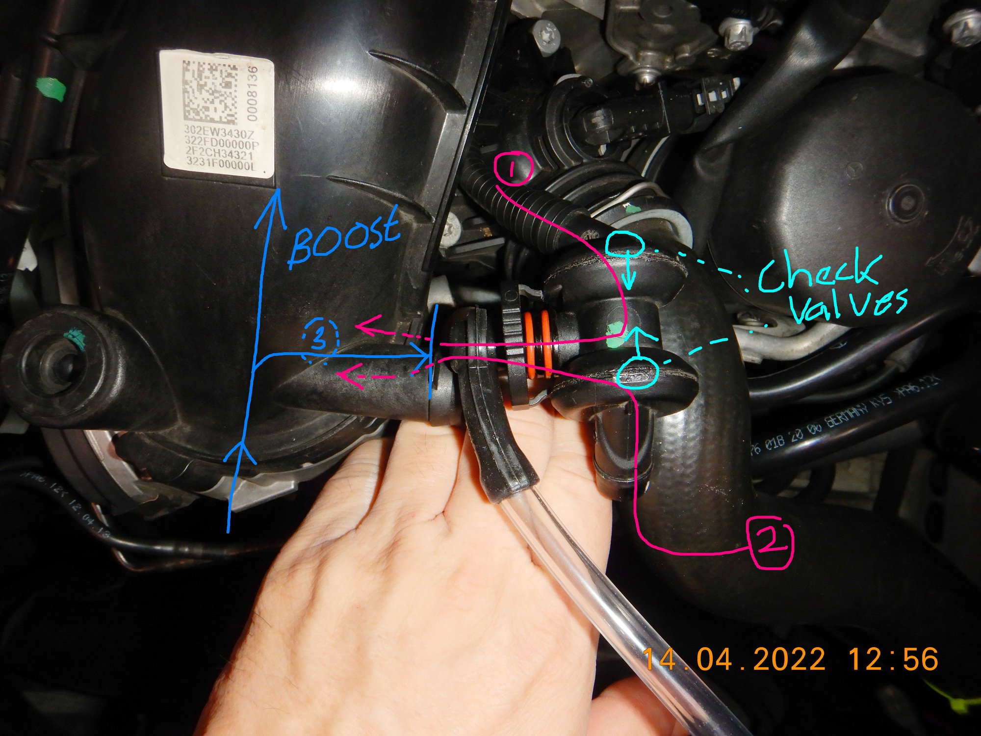

This is a POSITIVE pressure test, not vacuum.
So I use my hand pump which can SUCK and do POSITIVE . See the gauge, left side is Vacuum or suction and right side is Positive pressure.
First you make sure you hand pump itself does not leak back and loose pressure. Block the test tube and see if pressure drop or not.
If pressure holds, that meant your hand pump is OK.
So my check valve is mild leaking, as you can see in the video.
If leak is bad, you loose turbo boost and will send boost to :
01. Fuel vapor system
02. Crancake PCV system.
New duo-check valve, it can hold pressure well
This duo check valve for our M276.8xx, its equivalent in a VW engine is a source of problem.
Our turbo wastegate has metal flaps ( due to hot region ) to maintain boost/pressure, while the duo check-valve is plastic + rubber probably but they both do the same duty for maintaining boost.
You can't just buy the duo check valve, you must buy 1 set :
