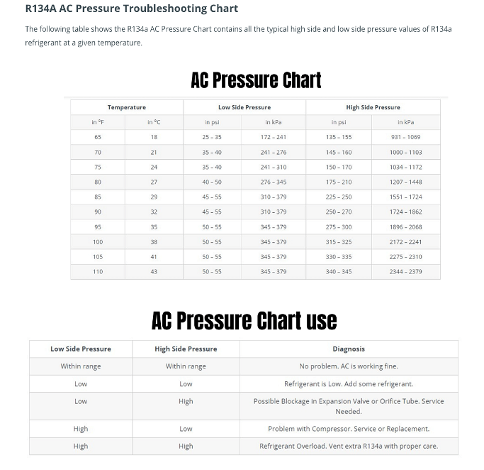

Go back to the charts I posted in #882. You can also search HVAC Symptoms Chart or something like that.
These may be simpler:
Old May 8, 2025 | 12:56 AM
  #912
CaliBenzDriver's Avatar
Joined: Apr 2019
Posts: 11,951
Likes: 6,796
From: Silicon Valley
W212 MY'14 M276-3.5NA @75kMi
Shouldn't these throw a code though? I got no DTCs
Codes are in the same league with the money light.
They are not here to help, only token for the real problem that's infact usually somewhere else.
To make decisive progress, you've got to analyze available evidence/clues while answering:
is it A or B else C.
Here you have medium pressure thats not pumped up... prop. valve!
Before rushing at opening sealed circuit, you check differential pressures to confirm compressor is not pumping besides commanded at 100% duty.
The wobling plate is staying idle.
without replacing while unit Toyota uses the same compressor with spare parts available.
Helpful chart, thank you I will check both yours and MS : ) Thank you all 3 of you for helping. There are no drips after parking the vehicle so clearly a/c is not working. Is it normal for there to be a whistle sound (relatively faint) when a/c is on, it is not whistling from the vents when it is off. I do recall this whistle sound is there even before a/c quit. Any suggestions on what the whistle sound is?
