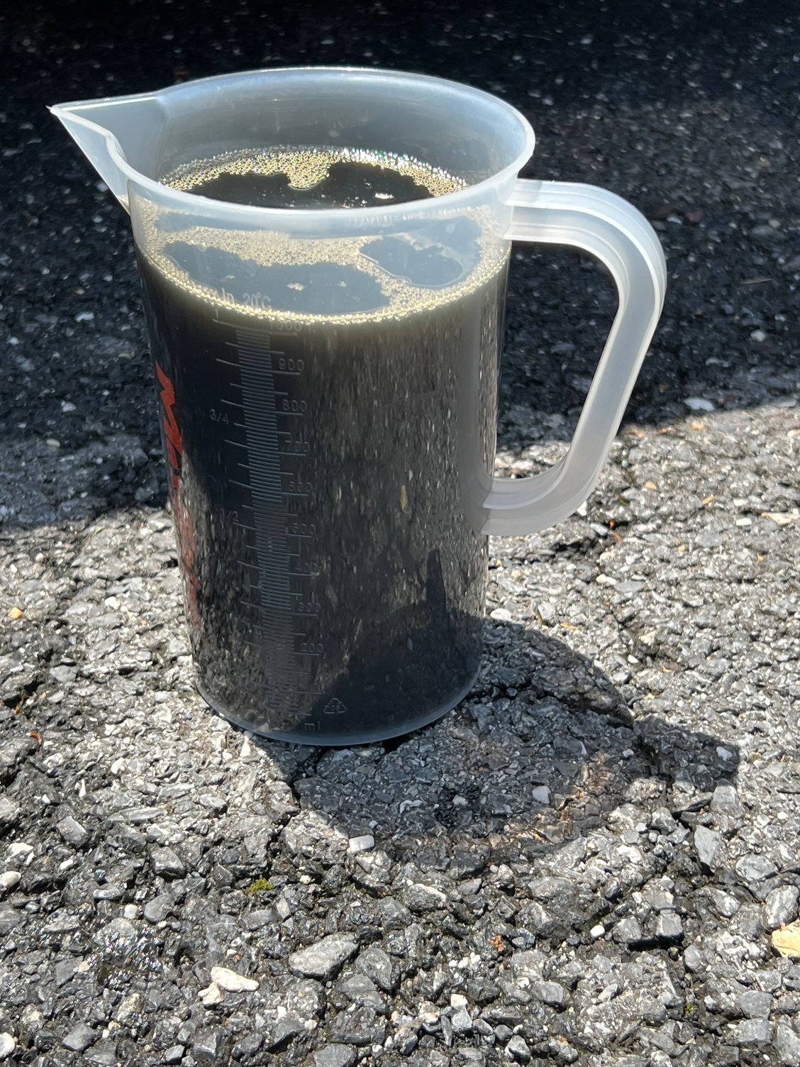

I have 56,728 miles on my 2015 SL400 and decided to change out the rear differential oil. There’s no scheduled maintenance for doing that unless you have a limited slip differential. Mine is non-limited slip. To my surprise, the stuff that drained out looked like coffee (without cream and sugar). The stuff I put in was Castrol Syntrax Long Life 75W-90 and looked like golden honey.
Has anyone else change their rear differential oil and was it black?

I haven't done a Benz but all those I did do looked like yours or worse.

mine came out pretty much yellow at 120k then again at 170k

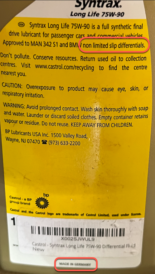

Thanks everyone for the replies. I went ahead and changed out the diff oil in my C350, as well. I also had a fine shimmer in the oil in both cars, though the C350 with 134,803 miles did not appear to be as dark (wish I had taken a picture of that, as well).
I happened to have had the Castrol Syntrax in my garage. I had bought a couple of liters a few years ago and never got around to using it. It's hard to get any gear oil that is not GL5 or made for limited slip differentials. This fluid is specifically for non limited slip diffs. I'm not sure Castrol offers it under that name anymore. When looking at my past purchases on Amazon, it is now called Castrol Transmax Axle. The insane thing is that I paid $15.99 per quart in March 2022 and it is now over four times as much. WTH, over! Mine was produced in Germany. The new stuff just says manufactured in the EU. Interesting!
Do you think the fact that this meets some BMW specification will hurt my Mercedes?

I believe "non slip diff" chemistry is tolerant of brass parts.
I could not find anything except compatible with "non-slip"
Diff oil needs to be "hypoid gear" rated not simply gearbox duty.

When I recently did the rear diff in my 2013 E 63 with 73,000 miles, the fluid did come out rather dark. I assume it was the first time it had ever been done in the vehicle which I had picked up with 42,000 miles. I do believe and could be wrong, but the fluid used in my rear diff was green (fuchs?) to start so the fact that it was rather dark didn’t bother me. That’s when I discovered my rear leaking axle seal. I refilled it with some Valvoline Synthetic GL five and now the dealer will put in whatever they stock. No limited slip for me.

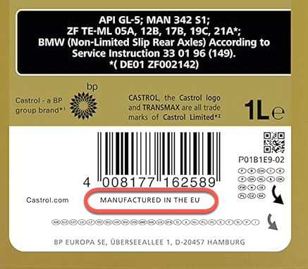

I had replaced my rear diff fluid a few years ago prior to finding out about all the Mercedes specs. At that time I had bought and used Syntrax long life 75W-90. Shortly after changing the rear, within a week, I found out about the MB specs. I then found a Febi brand fluid that has the proper MB spec printed on the bottle so replaced it again. I only had the Syntrax fluid in about a week but the car drove fine.
I forget where the Syntrax idea came from, I read it somewhere that it was good to use. I had to track it down and it wasnt cheap either.
When I did replace the rear diff fluid the first time I do remember thinking how good the old fluid looks, like it must have been recently replaced and I didnt even need to do it. I have no idea when or if that fluid was replaced prior, could have been replaced right before I bought the car. I forget exactly how the front diff fluid looked but I dont remember thinking it looked as good as the rear looked and glad I did it.

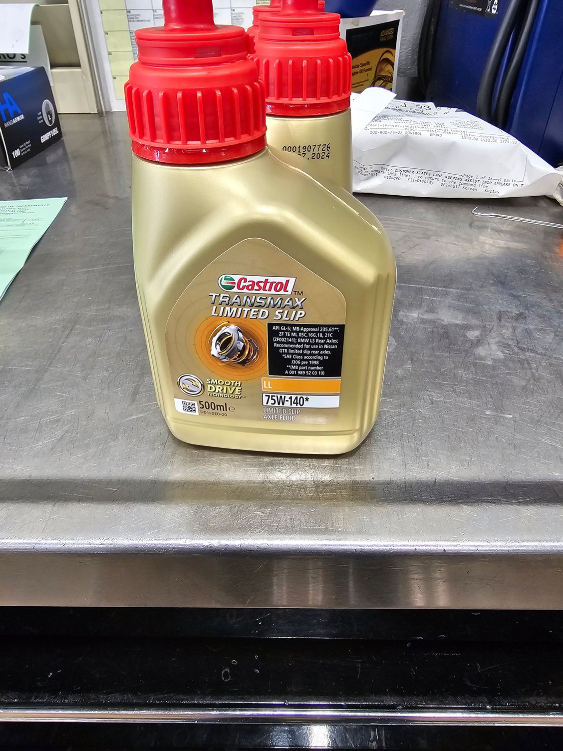

Can confirm the Transmax for the AMG spec - The dealer just did a diff fluid change on my 2022 AMG GLE and used the Transmax - here is the bottle they used:

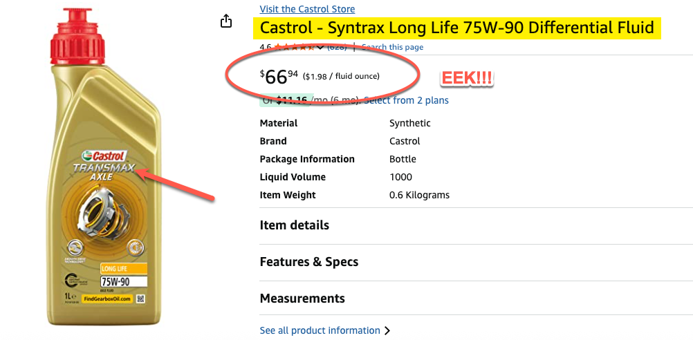

Theres an online store IDparts https://www.idparts.com/febi-oil-hyp...5-p-15664.html i'll buy from. They deal with diesel vehicles but have the same various parts. Bought most of my transmission service parts here. They are located the next town over in MA and have free pick-up at there warehouse.
When I bought the Febi oil it was around $18/bottle but has gone up since. they have Fuchs also.
