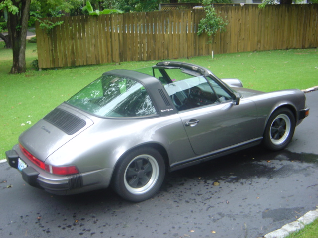

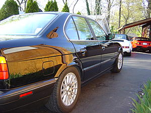

Attached Thumbnails Suspension completed on my 01 ML55-944-pictures-069.jpg   Suspension completed on my 01 ML55-944-pictures-071.jpg   Suspension completed on my 01 ML55-944-pictures-080.jpg   Suspension completed on my 01 ML55-944-pictures-073.jpg

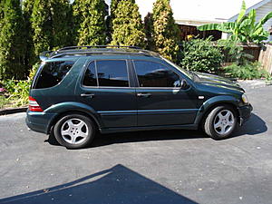

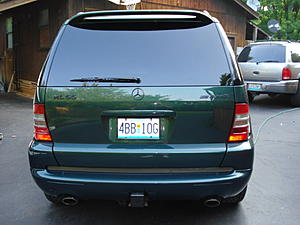

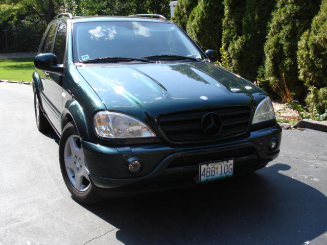

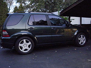

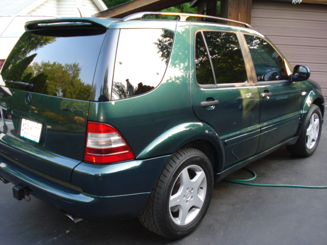

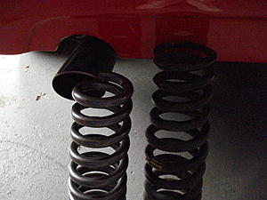

I have stuck a couple pics on. The ML is now lowered a little over an inch (see pics). I also shot the springs. Note height and also the flat end vs the round end. The round end ones in the pic are my old ones. The installation is relatively straightforward though a PITA. Tire Rack only has two spring listings for H&R one round end, one flat end. I bought the shocks off Ebay for $500 delivered. They are the Bilstein Sports. The ride is greatly improved. I don't know if it was because my old ones had 75,000 miles or the Bilsteins are just that much better. Either way it looks good and rides good w/o being harsh. I don't haul heavy stuff. I mainly have an upright bass and a small Phil Jones amplifier as the biggest thing. I agree that the ML is the best vehicle I have ever owned. I too have gremlins, mainly a very erratic fuel gauge. For $70K I would be pissed, for $20K I can reset the odometer when I fill up just to be safe.

So the ride is not bad huh? You can really notice the drop in height! I plan on having mine done soon with Eibach instead of HR if I can find them.

The ride is great. I also wanted Eibach but could only find the H&R. I instaled H&R on my 91 911 C4 and the ride is terrible but on the ML it's great. It also sounds eally good w/ the Camaro exhaust. I also like the blacked out trim against the green body. It's easy to do and is more stealthy.
