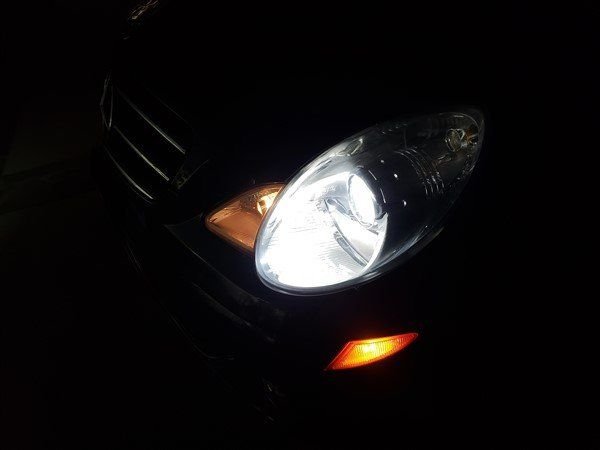

LED LOW BEAM LIGHTS: Replaced low beam halogen bulbs with LED 6K bulb. Most of my recent cars had HID/Xenon lights. Those yellowish lights should be banned. Should make LEDs standard on all cars. Replacing the regular bulbs on the R class is a pain in the *** in itself (you need an extra joint in your arms/wrist). I bought some no name LED lights online to fit "euro" cars. Sadly, it didn't fit. I bought another model, which didn't fit either. I thought about giving up, but made modifications to the unit to make it fit the light housing (see pic). Surprising it worked without an error code and is much brighter than stock. And, it looks cool at night (see pic). (MEDIUM difficulty).

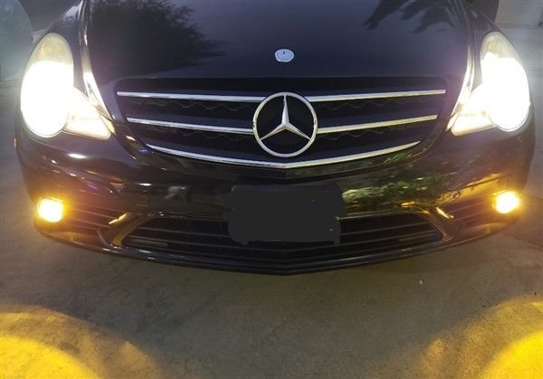

YELLOW HELLA FOGS LIGHTS: Replaced fog lights with Hella yellow fogs bulbs. I always thought theses looked cool back in the day. I had some PIAA's back then and wanted yellow ones. Unscrew the fog light grill and housing and replace the bulb. (EAST difficulty).

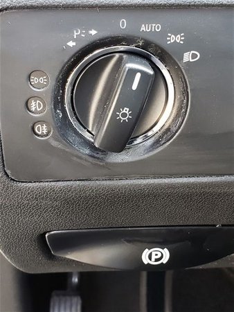

STRIP COATING ON HEADLIGHT SWITCH: When replacing the above bulbs, I notice that the headlight switch's rubber coating was sticky due to the years of heat, etc. This was a popular coating to plastic back in 2000's, which made it smooth to the touch yet softer than hard plastic. BUT, after years of use it gets sticky and nasty. I tried everything to strip it, rubbing alcohol, cleansers, thinner. Nothing worked. But the $324 (part#25154532049116) price tag (yikes!) made me try again. Finally tried Mr. Clean Magic Foam. With rubbing alcohol and some elbow grease, I was able to strip all the sticky goo off the plastic. Now it feels smooth and clean.
(sticky and nasty)
(now, clean and smooth)

Those LED "bulbs" do not put out a good light distribution. If you really want better lighting, do a full retrofit. I believe those are halogen E55 projectors, and Morimoto sells a bracket that can convert E55 to Morimoto Mini D2S projectors or use their new MLED projectors.

I was thinking of replacing them with used OEM Merc xenon assembly, but I'm game. If you installed it on your R, let me know what parts' are needed and how to install (as Morimoto's website has no info. on fitment of Mini D2s on a R class, only H7 bulb options). BTW, you know if those Morimoto H7 HID bulbs are any good. Thanks.
BTW->Morimoto's return policy sucks a$$. If you installed it (open box), then no return! Unopened box is subject to 20% restock fee! "If packaging has been opened and needs to be replaced because of which, an additional 5% reconditioning fee will be added without exception." It's a run-on sentence per their site, but I'm presuming an extra 5% fee. Jeez, I get you run a business, but what if it doesn't work on my car (i.e. reads errors). They better guarantee that it's going to work without errors before I order.

YELLOW HELLA FOGS LIGHTS: Replaced fog lights with Hella yellow fogs bulbs (Part # H7 YL). I always thought theses looked cool back in the day. I had some PIAA's back then and wanted yellow ones. Unscrew the fog light grill and housing and replace the bulb. (EAST difficulty).

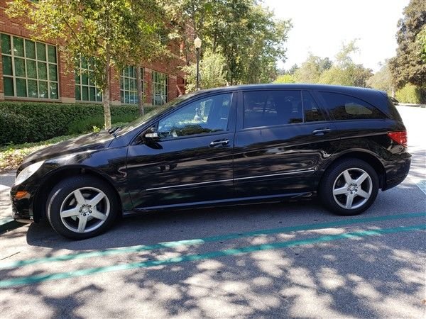

#4 BLACK OUT CHROME WINDOW TRIM
