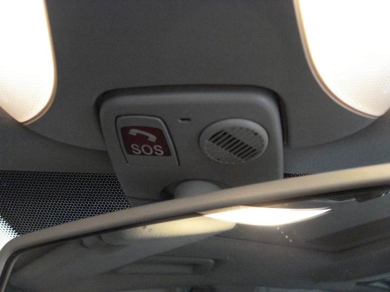

Originally Posted by M-bENZ
What about the "Autopilot"?? Do we have to remove that?? I heard that we need to remove that if not its gona mess up the sound..From that link he didnt mention anything about that "Autopilot"..well I guess his car doesnt have that..
Neither does yours.. Well not exactly the way you are thinking..,, it's function is software controlled and can be modified through STAR. YOu can turn it up or down to increase or decrease its sensitivity or the amount of gain increase. good luck explaining that to your local dealer..
But it isn't something that can be removed physically...its all built into the logic.
The best quickest way to defeat it is to remove the mic in your upper center console. If you have a phone system then you can;t do that of course...

mind to show me in the pix?? I have no clue where to find that so u saying I have to remove that in order to add the sub and the amps.
Here it is.. The mic is under the panel.
Remember though,, this is not a Honda... You'll have to rip out a lot of stuff and retool a lot of things in order to modify the sound in these cars..
The signal to the speakers come from the Audio Gateway located in the rear of the car and there is a bose amplifier, and all of that is ties to your MOST system and linked to the Canbus.. so it's not a simple thing to do on the S class..
I.O.W. Don't expect the audio geek at Best buy to be able to make this happen for you.
In fact, I'd say its easier to rip the whole thing out and start over than to integrate.. THere are members using JL clean sweeps and other stuff but I don;t know how that's hooked up and what the actual gain is at the end of spending all of that money. You'll have to search.
