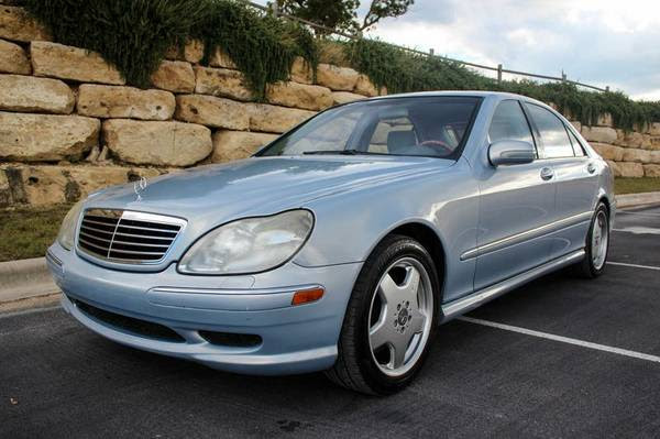

I recently joined the forums after acquiring an 01 S55 AMG. At the time during my purchase, I didn't realize the 03+ models came with the kompressor (silly me). Over the next few weeks, I did a lot of research and learned a lot about the W220 S55. I have also driven a few 03+ models since my purchase to get a feel of that extra power and torque compared to the NA.
Everybody raves about the 03+ versions because of the power and rightly so. I have read the W220 Encylopedia posts in the Quality and Comparison, Buying Advice section by forum member Skylaw.
But I still am torn whether I should keep the 01 S55 or go with a 03+ S55 so I want people here to give their opinions and experience. This car will be my daily driver (keep that in mind when giving advice/opinion!) As a DD, I feel like I won't necessarily need all that power but as a car guy it's nice to know that owning a 03+ rivals lots of cars out there today with that 4.6 0-60 time.
So I wanted to start this discussion on some questions I still had:
1. Quality was improved 03+ with the electronics and 04+ had nano clearcoat. What other improvements were made? (I am really interested in this question since it will be my daily driver) Was the ABC suspension quality improved? (assuming proper maintenance/flushes are done).
2. Was the kompressor headache free like the NA people say it is? I would think a NA would involve less headaches in the long term over one with a kompressor. Are these additional problems (clutch & chirp, cooler failing) that potentially can happen with a kompressor outweigh the 'thrill' while driving it as a daily driver? I am an aggressive driver so I do floor it from time to time
3. I guess this last question is this: 5.7 versus 4.6 0-60 time. For the car enthusiasts that have an opportunity to own a few fast cars in their lifetime, does a 1.1 second difference really that noticeable for a daily driver?
I look forward to having a good discussion around this topic and getting more involved with this community in the very near future with my new ownership! I have attached a few pictures of the S55 I bought.

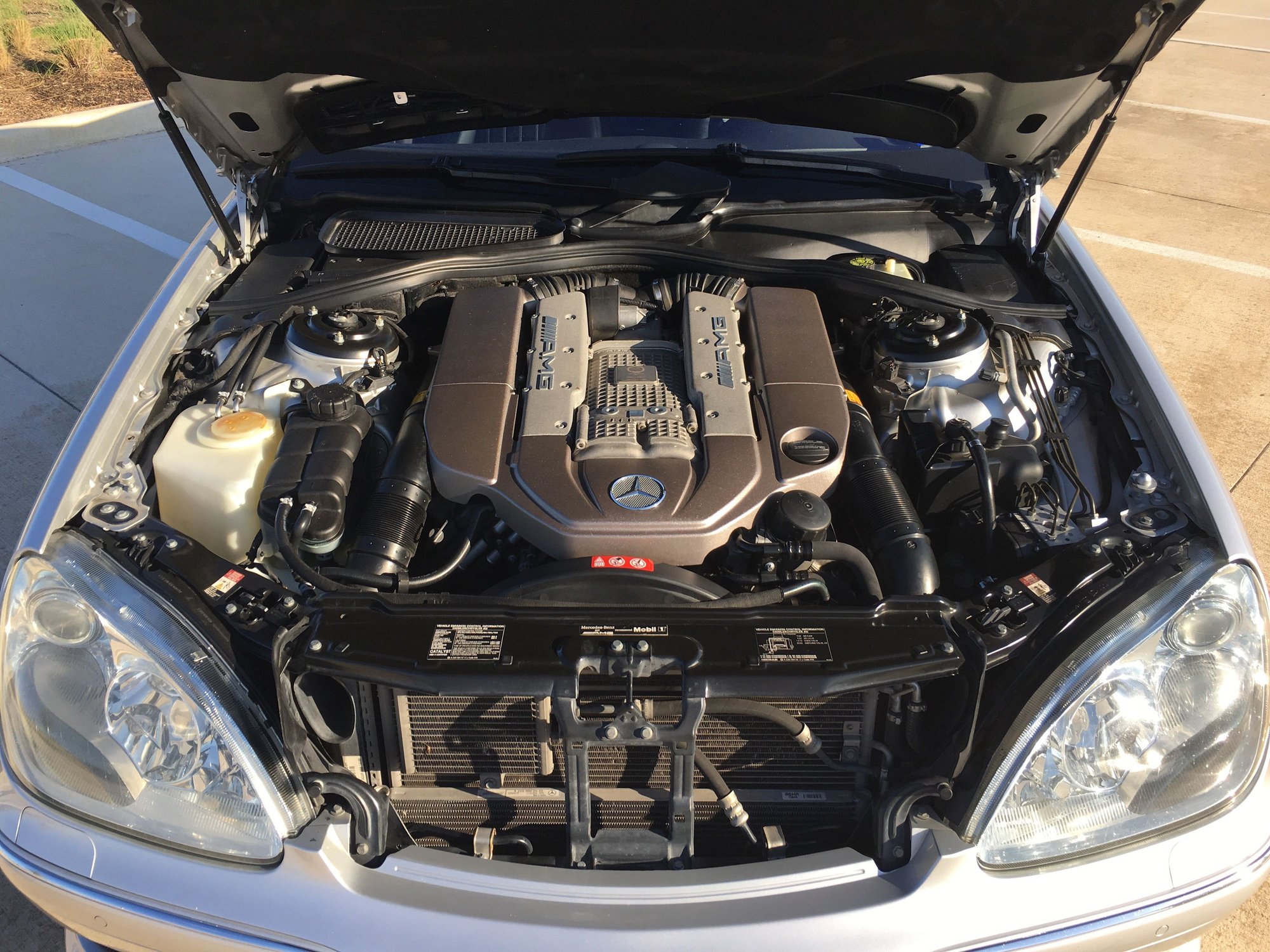

For everyone who has the kompressor model, how much maintenance has the kompressor required especially ones with high mileage like PillDrives

As far as the Kompressor goes mine has been great. Changed Oil twice now (Oil from AutoHaus AZ Part Number AD-000989620109 for $12) and my Clutch Pulley Bearing went bad once about 110k ago. Replaced that one with 45BG07S5DL-2DS from BearingsDirect.com for $40 and thats it. No other issues at all.

That's awesome to hear PillDrive! Sounds like no headache at all. Obviously oil and clutch need maintenance as they wear but 110k is amazing.
I agree preventative maintenance is the key to any car lasting.
Do you guys experience the 'chirp' I've read on these forums? What MY are affected?
Haven't really found a thread that fixes this chirping unless you make it clutchless: https://mbworld.org/forums/w211-amg/...-c-pulley.html

I have had the "chirp" since I bought the car new off the dealer's lot. After 80K miles and 14 years, I am comfortable saying that it's the normal slip squeak you would get from aggressive acceleration, trying to instantaneously spin the stationary supercharger's guts by mashing a clutch against a pulley that's already spinning at 1.5K RPM. The tensioner spring absorbs some of the shock. There could be a little belt slip too.
It doesn't always happen if you drive normally and don't mash the gas.
Sure it means the clutch surface is gradually wearing. I'm not concerned.
I am going to do a teardown on mine soon to check the front shaft oil seal.
