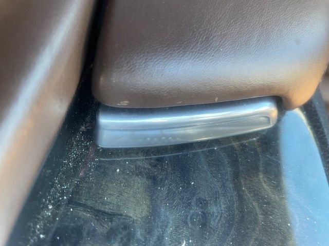

The console release mechanism, I call it a button which is probably a poor choice, when pushed is not activating the two doors. He has to depress and manually pull the doors open.

Sounds like the springs are either broken or out out place. The top of the console ("doors") can be removed. There are some YouTube videos showing how to do this. Perhaps you/he can remove and inspect them.

I think it may just not be worded clearly. The center console storage DOES have doors that open with a push in style button, or tab, or release, etc. at the front top of the storage. When that item is pushed your center console doors open. Sometimes I have to push the release twice as the left door (closest to driver) will open and not the right side. A second push opens the right side, however that might be because I have a cell charger cord coming out from inside the console that may prevent the doors from opening correctly when the cord is stuck between the doors and the doors are shut.

I get what you are saying. I posted a pic of the button to my console doors. I assume you are talking about button..

So, I just checked on my car. The big silver button pushes two latches (one for each door) to release the catch. Then the doors should spring open. If they don't, then the springs are broken/missing/out of place, or there is something jamming them from opening. This should not be hard to diagnose and resolve, certainly not for $2400! I'll do it for half that! :P

This is a fairly common issue with R231’s
https://mbworld.org/forums/sl-class-...ole-doors.html
https://mbworld.org/forums/sl-class-...-pop-open.html
$2400 is one zero off from the $240 this repair should cost ☹️
Your hinges need to be replaced or repaired. I believe there is a video detailing the process on here.
