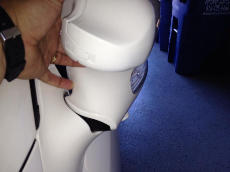

Old Oct 29, 2012 | 10:23 AM
  #40
pigskinplayers's Avatar
Joined: Sep 2012
Posts: 107
From: Midwest
SL55 AMG
I received the correct mirrors on Friday. I have not installed them yet but they look to have the correct housings now and are marked differently on the box than the first set I was shipped. I will update with additional photos once installed.

ok guys so I guess I am now past the official guinea pig stage of these mirrors and can share my experience with you all. I first ordered these mirrors off of ebay in mid september and the ones that were supposed to work did not. After spending $60 to return them I finally got them in on wens and installed them on thurs. As of now these mirrors are 95% installed. I am waiting for the star r230 service install dvd to get to me before I can finish as I have to know what color wire on the center dome light to splice into for the puddle lights on the mirrors. Currently everything is good to go and I have the wire leads from both mirrors puddle lights dangling right under my center dome light that is half way removed. Once I know which wire to splice into and a few minutes everything will be completed. They did take me a long time to install as I went slow to make sure I did not break anything and that everything worked. So both door panels need to be removed, the factory mirrors taken off and dissasembled and once all internals each mirror is taken apart and put back together with your new mirrors they need to be installed and pre-tested to make sure your connections are right. From there a wire needs to be wired from the mirror to inside door panel to kick panel to dome light on each side (this can be somewhat tricky). All in all I love my new led carbon fiber mirrors, and the puddle lights look sweet to. I am making it so my puddle lights come on when I hit the unlock feature on my key. Anyone who is going to do this mod, either in cf or a factory matching color need to order the 05-09 mirrors regardless what year yours is I think, as mine is a 04. If you dont plan on installing them yourself get ready for a expensive install bill to have them installed right. I am very pleased with the quality of these. You cant beat the deal of getting these mirrors for around $300, or the painted ones for $150, totally worth it. If anyone has the star dvd and can look up the electrical diagrams to tell me which wire the dome lights are triggered off of would be great as I wont have to wait for mine to come in

Finally received the replacement, the 05-08 model which should be the correct ones for my 2004:

yes those are the correct ones, they are a little tricky to install but once you do one side the other one is quick. there is a certain way these covers install correctly and do not force it, you will have to play around to see how the covers go on the motor assemblys

so the oem covers slide over the mirror and when they do two harnesses automatically connect for the turn signals. These wires need to be cut, I removed the end connecter and twisted the new led turn signals to the mirrors signal 2 wires, just test before you install so you dont mix up the polarities. After much thought i decided to leave the puddle lights disconnected because they were pretty lame when on, the led shined on the door, not the floor. Other than the puddle lights that are not even seen since there underneath, these mirrors are def worth the money
