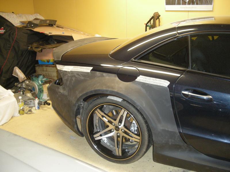

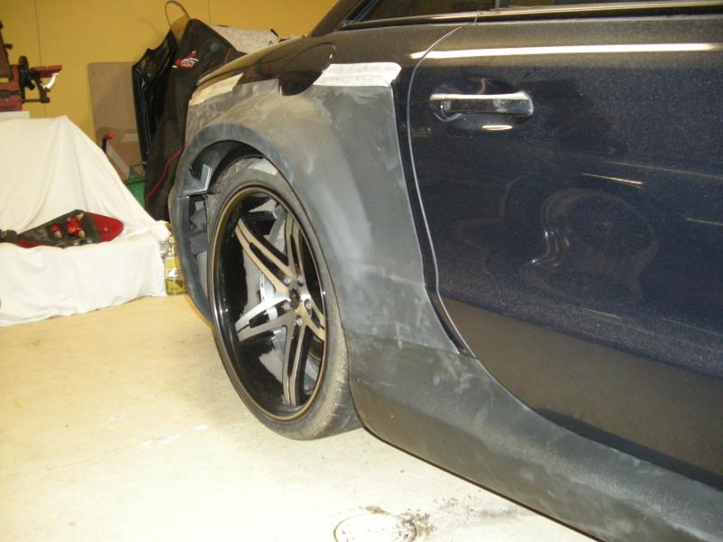

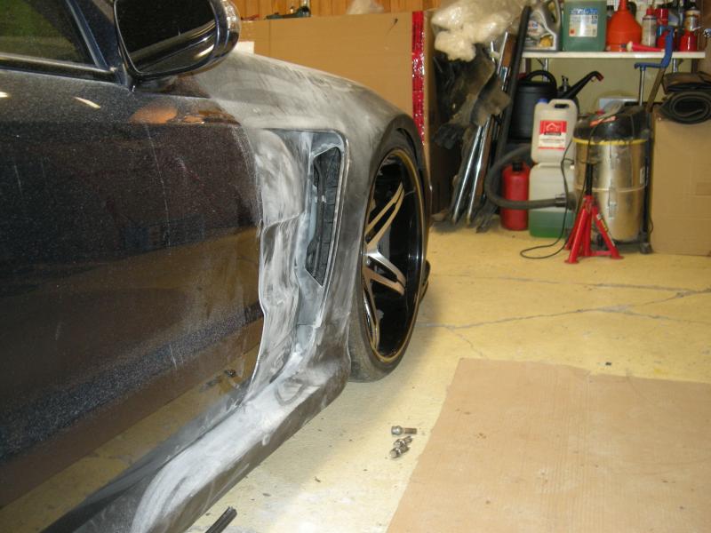

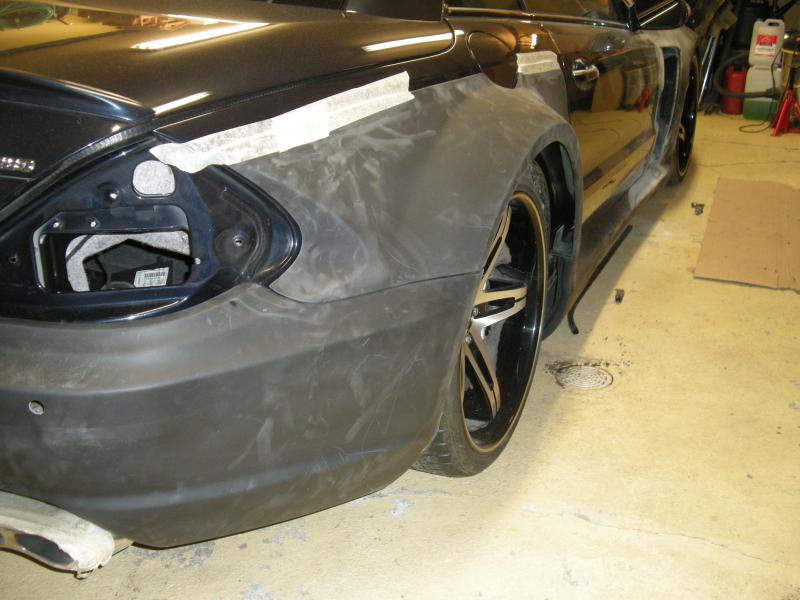

Hello..
My car is ready to the paint shop... Paint shop is going to install the rear fender parts.
Now I have regonize the differences between Mischa vs Prior fender types.
Prior use a big plate at the rear fender and at front Prior is rounder.
I have put at front my rear wheel... (305/25*20) 11*20" ET 31.... only for to measure the right offset. 11" is to wide.
Sorry to hear that your truck have broken..... But summer is not here yet so you have lot of time to build your project ready....
Juha

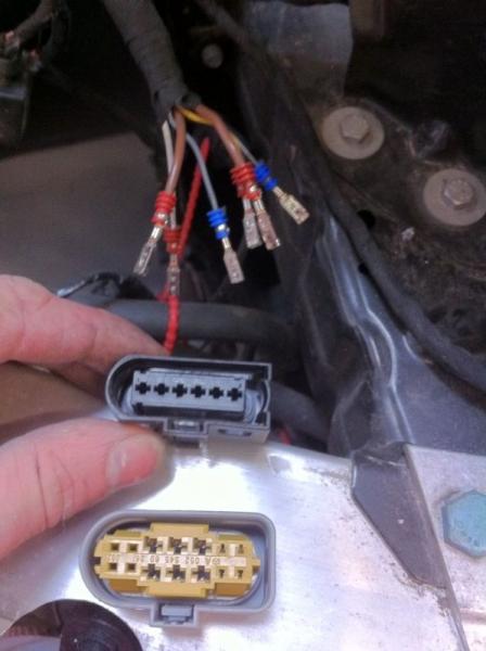

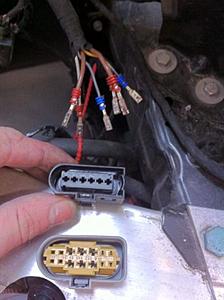

Originally Posted by overZealous1
i really havn't had any time to mess with it. the harness i got is very hard to understand. super basic instructions originally in german, then translated. it really makes no sense after just the very basic wire match. there seems to be alot of wires in it, and the left and right headlights are connected together. no pics either. frankly, i am glad i even got the low beams working! i am having a feeling though that the ignition needs to be on though. when i have more time i am going to strip the wires apart. the left and right headlight wires are so far apart i could almost hook up a headlight in the trunk!!

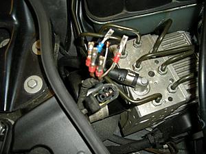

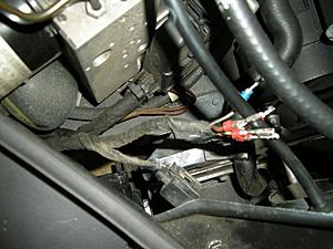

I have also upgrade my lights... my car is from end of 2003.
I only change the plugs..... take of the old plug to new one and I use the same wirings.... no problem at al.
Here is some picture how I do it.... hope it's help.
Juha

I took a picture of my plugs, anyone know where the second (top) plug goes?
Old Jan 17, 2013 | 01:47 AM
  #243
Ekselent's Avatar
Joined: Jan 2012
Posts: 883
Likes: 24
From: Finland
SL600 / SL450 (107) / E350 / BMW M5 E60 / BMW 745i (E23) / BMW X6M / Toyota Hilux 4 WD/ Honda CBX 10
If I remeber right one plug which was at the old light you don't need to use it at al...
I can look it at my car and take a picture if it the same plug you show at the picture..... it was a small plug.
Ah okay perfect. Thanks for clarifying. One more thing Ekselent, would the new plug that you purchased happen to have a part number on it?
I look at my computer and I find pictures which I took when I assembly the headlight and it's the same plug... and I don't need it anymore at al.... everything working fine....
Look here.
I'm going to try find out the part number also....
your making this look easy!! i am having to do major work to get mine lining up!
Honestly.... the fitment is pretty good...
Of course I have made some small adjustments and so on but nothing big.
The water thank under the right fender..... don't fit any more so I use heatgun and deform the old one to make it fit.
Then I must drill the PDC holes at booth pumpers.... and today I'm gone do it at the front pumper.
The hood is very good quality... Prior have made it strong!
Juha
Awesome, thanks!
I have to try find out what that plug is.... I'm not 100% sure yet but It can be for the automatic xenon headlight adjustment. Those wirings kitt they sell is for that also.... but it don't fit every car.
It's don't fit my car so I have only change the plug and the plug have following number A052 545 56 26.
I hope this info help....
Juha
