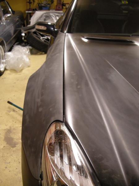

Sweet! I trust your analysis of it since you also paint.. How does the hood specifically look?
It's so hard to make such a large part straight when it's constructed in fiberglass, harder to make it stay straight through many heat cycles due to the resin tightening up against the reinforcement as it cures. If it were me, I'd soak it in a spray poly filler, then shoot a thin coat of black basecoat on it and leave it out in the sun for a few weeks to heat cycle it and shrink it as much as possible before blocking it and painting it.

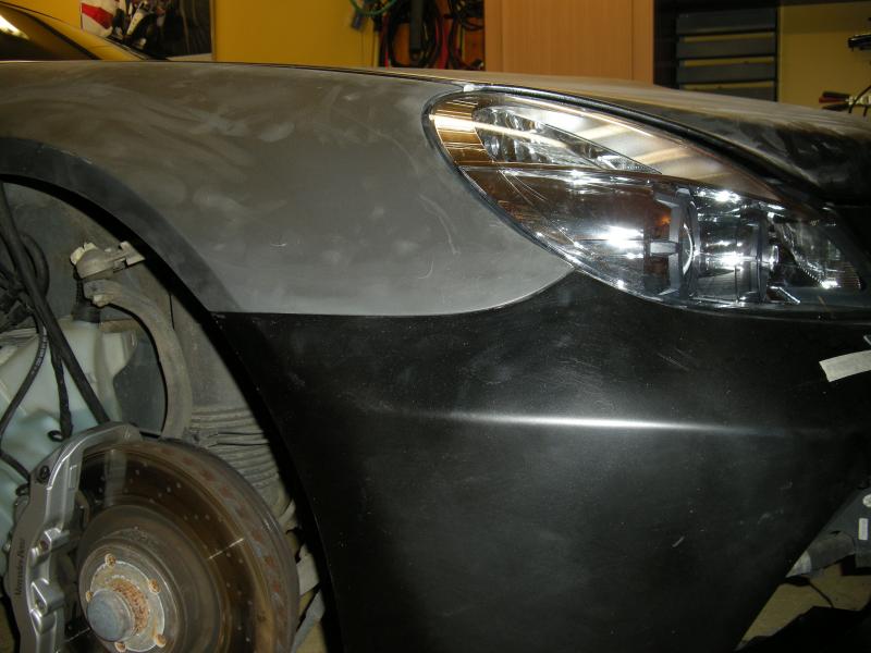

here at last! quality looks very good. impressed by the thickness of the panels. should be easy to make perfect and hold up good against warping over time.
got the new tool box to consolidate alot of my tools and free up counter space so i am a go starting tomorrow morning!!

the hood looks great! i have had to skim coat frp hoods before because of panel waves. very hard to flatten too if frp is thin and it flexes under your sanding block. every part from misha is very thick with no visible waves. since there is hardly any flex, it will be very easy to sand out.
i have had some bad luck with the "spray bondo". not sure if temps were just wrong, but i have had it separate from panels before and bubble. happened on one car i spent 3 months on the paint alone! ugg. but, if you go past the gelcoat you either have to spray that on, or skim coat with filler to close it off again. raw fiberglass and resin will suck in the chemicals and show weave or other things within a couple months if not immediately. i usually just use the very lightweight self leveling type filler though, never had any probs with that stuff.
it is average 40's here right now, so i really can't even do a thick primer as it would not shrink and cure till june!! will do a rattle can guide coat and go from there.

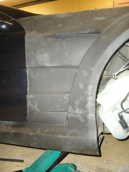

I'm ready for the day....
Small problems...
- one of them is the "water reservoir" at the right side.... I'm not sure if you have it at your cars but here in Europe we have it with a heater inside...
Now when I assembly the new BS fender the water reservoir don't fit... the space is to small.....
Maybe the BS reservoir is smaller or it's at another place.

I took few pictures from the right side before I came in from the garage.
I have only "hang" on the parts and have not assembly/adjust them together.
The fender is bolted on at the "frame". I have test and push them together and I know they fit pretty well.
I have not decide yet if I'm gone bolt this parts or glue them together...
But al the lines and parts looks like this.
The hood is only with two bolts and it's to much up but it's easy to adjust it to the right level vs fender.
When I have adjust everything I'm gone take more pictures.
What do you think?
Juha
