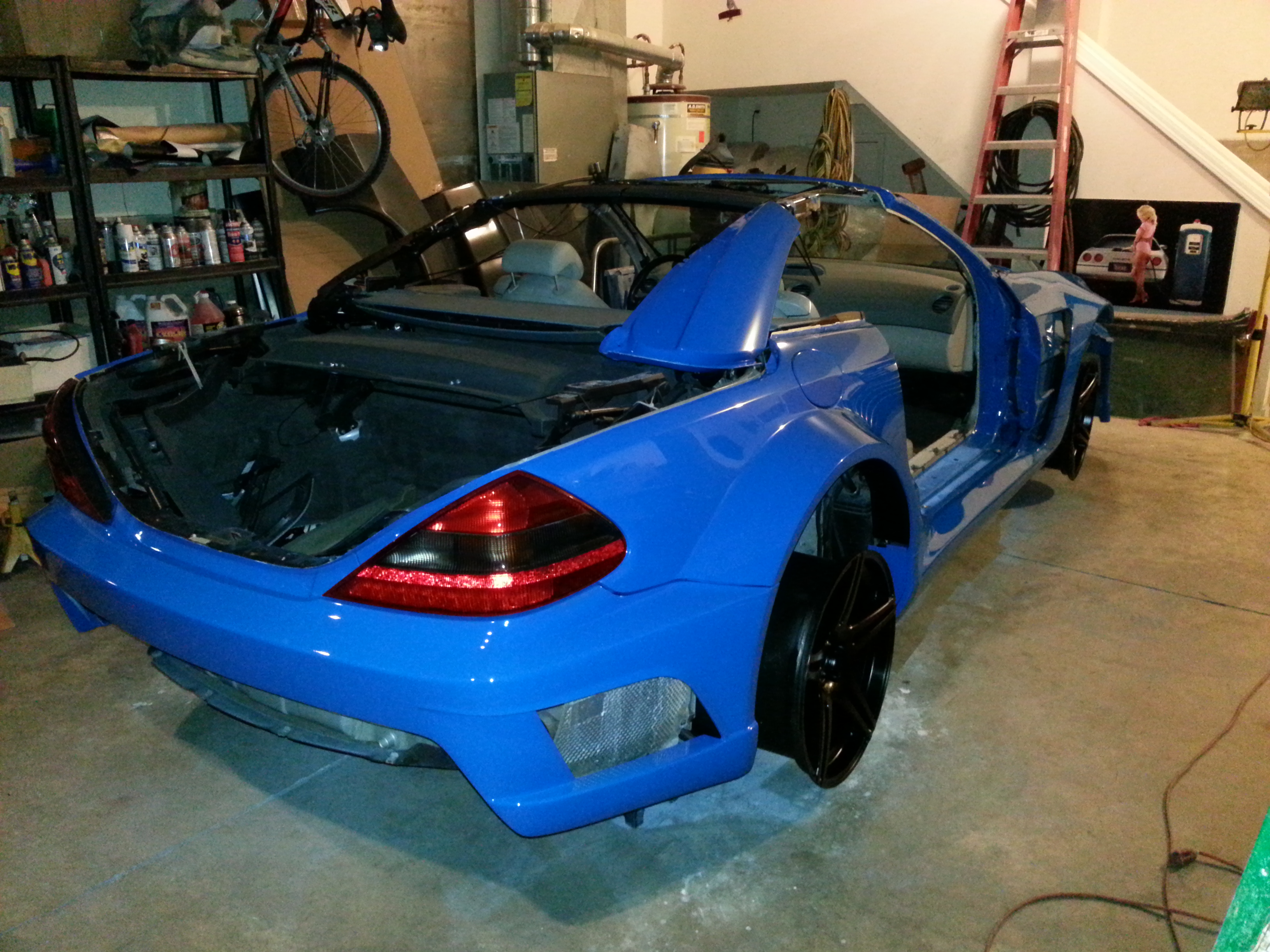

color sanded and buffed. 600 grit, 1000 grit, 1500 grit, then final of 2000 grit. then, 3 different compounds and 2 different pads. tons of work, but when done it looks like this.
this is why the body work had to be good. lol. unfortunately, in a few months when the paint is cured and fully set, the 2000 grit and compounding needs to happen again!

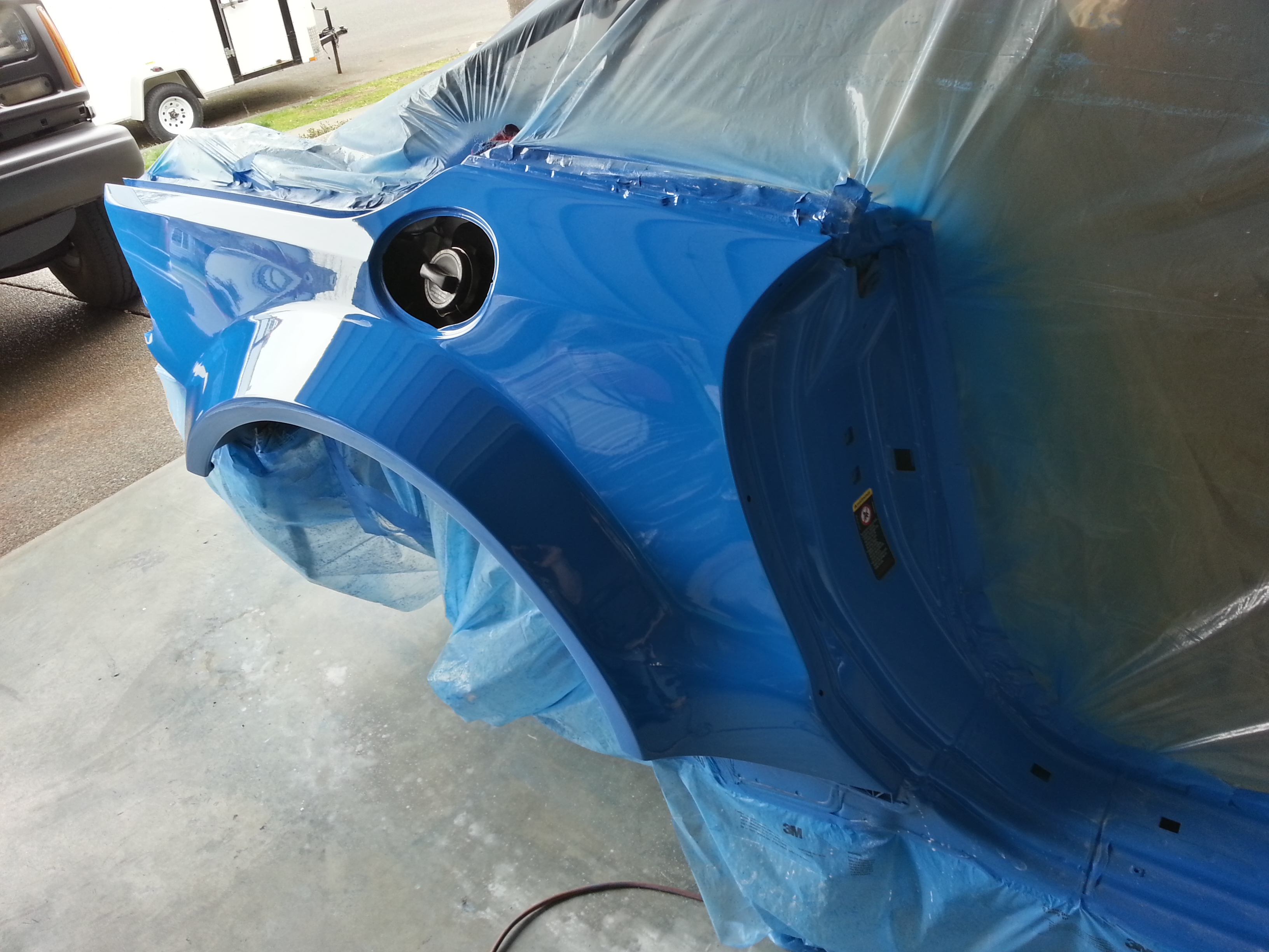

started painting all parts at 8am this morning. it's now 9pm. i am beat!!! things went great right up till one of the front fenders decided to jump off the saw horse i was painting it on and hit the concrete, chip a corner, then roll over onto the face of it. i was literally done with it with 5 coats color and 5 coats clear. suck! letting it dry then redo tomorrow.
on a more positive note, only 2 parts left to paint. it is coming out awesome!
pics as i start to assemble.

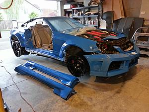

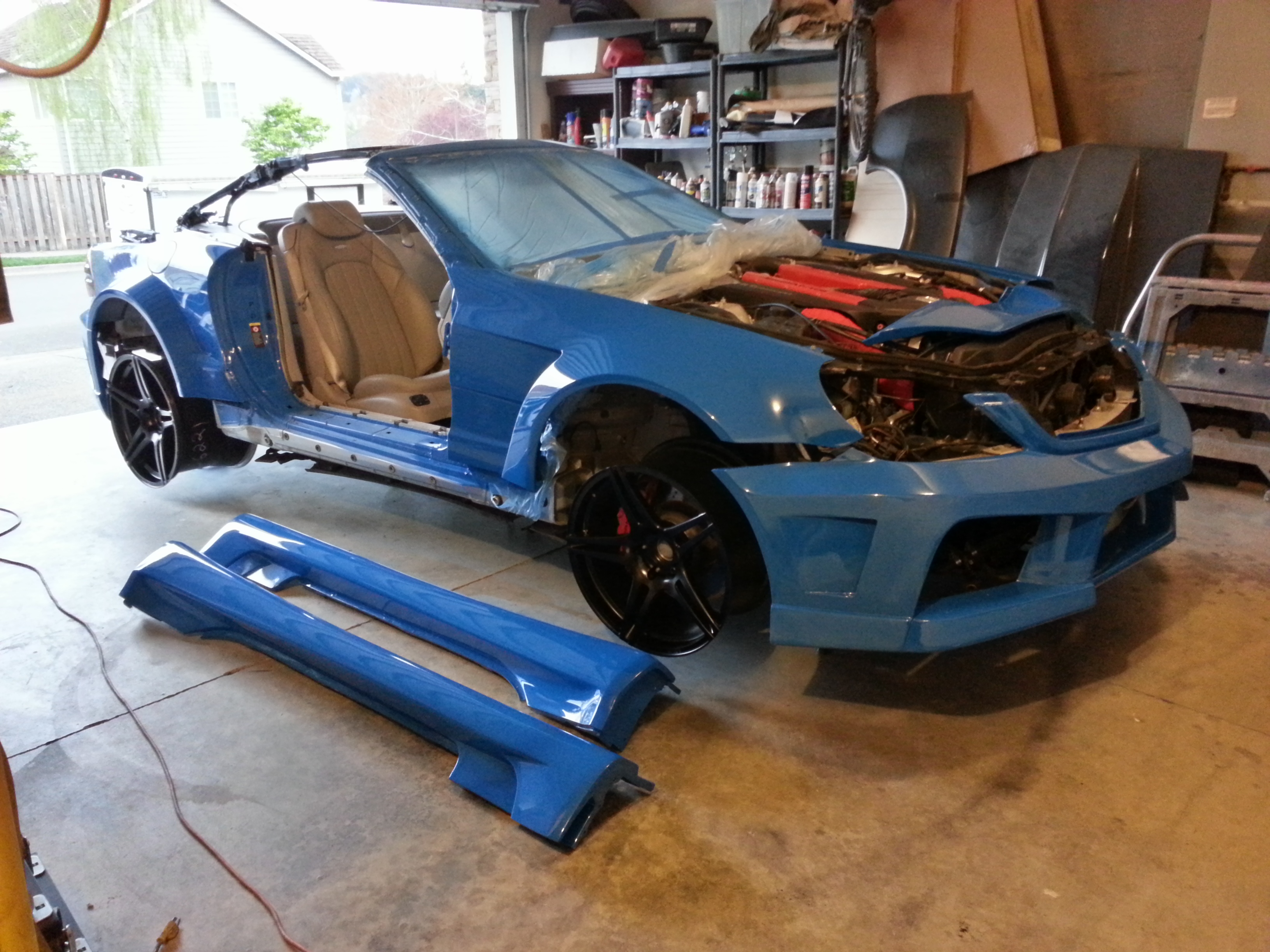

thanks man. here is a couple teaser pics. assembly starts today.

Paint looks great!

Looks HORRIBLE...You realy like this Audi RS lookng color on a MB??? You totally lost me here. But most important is that you are happy with it.

It's look better than I thought.... Blue and black wheels is a good choice....
It's your christmas time now!!!!
