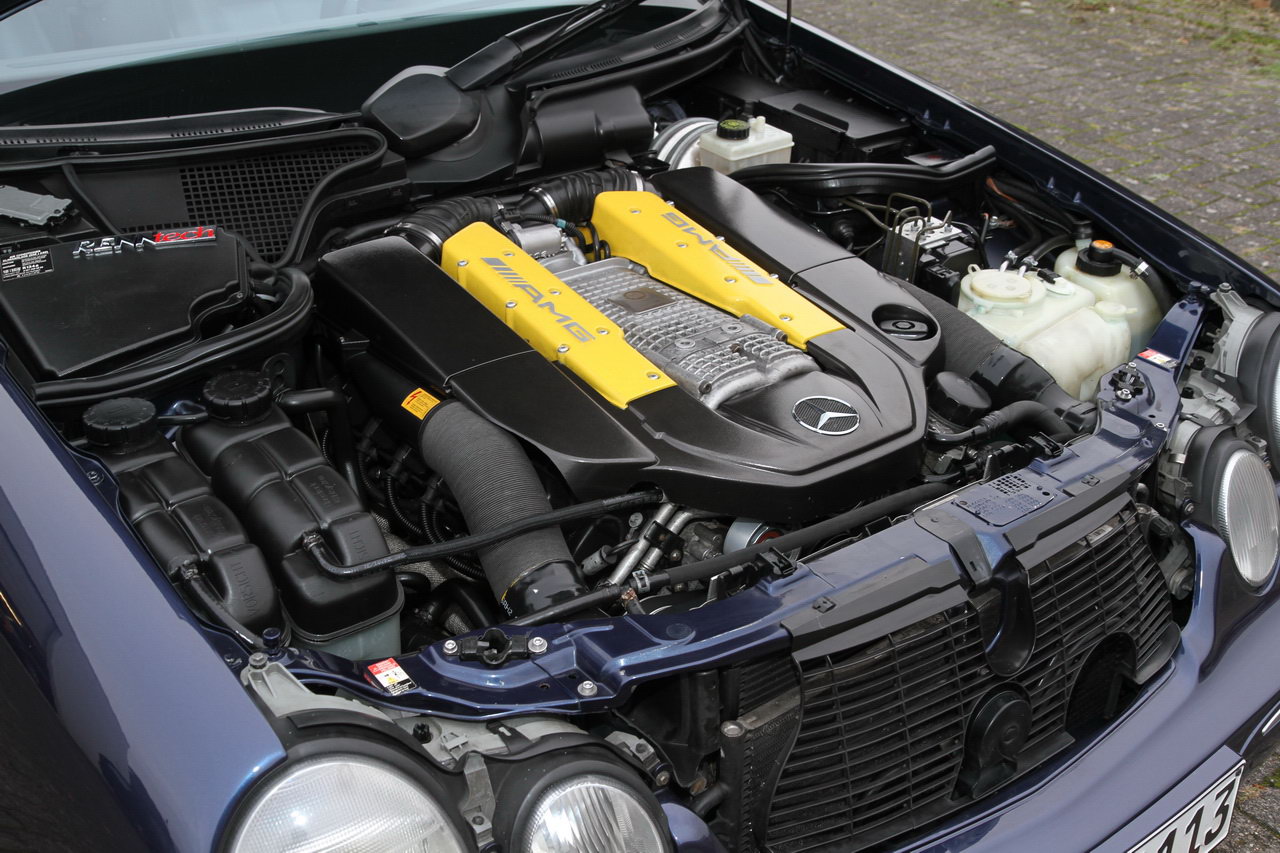

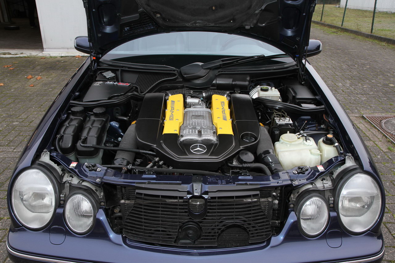

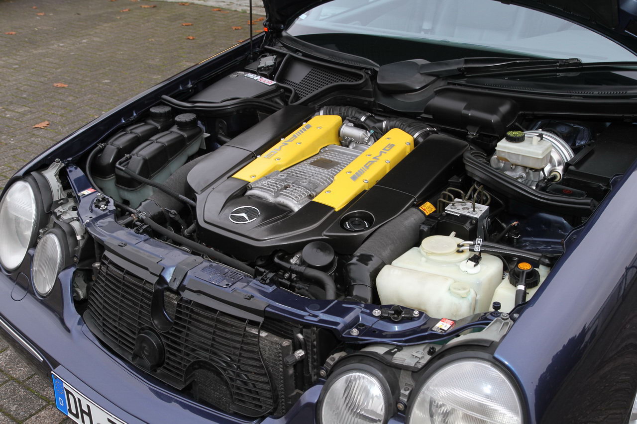

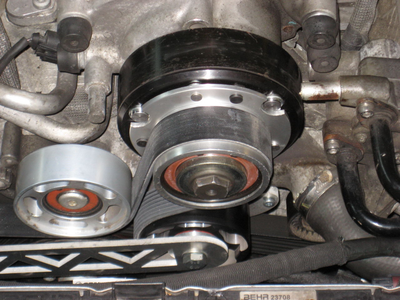

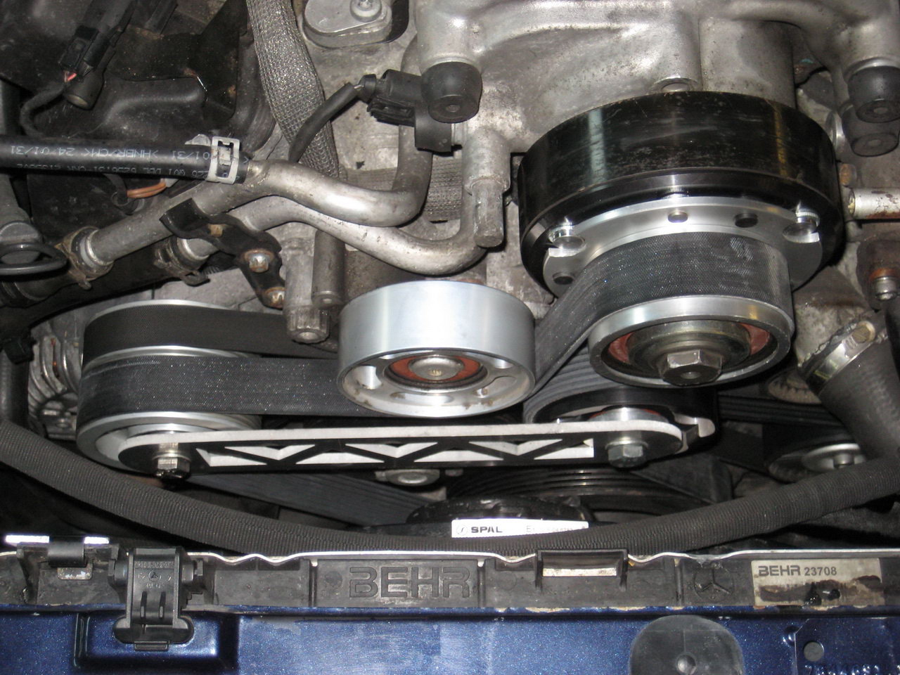

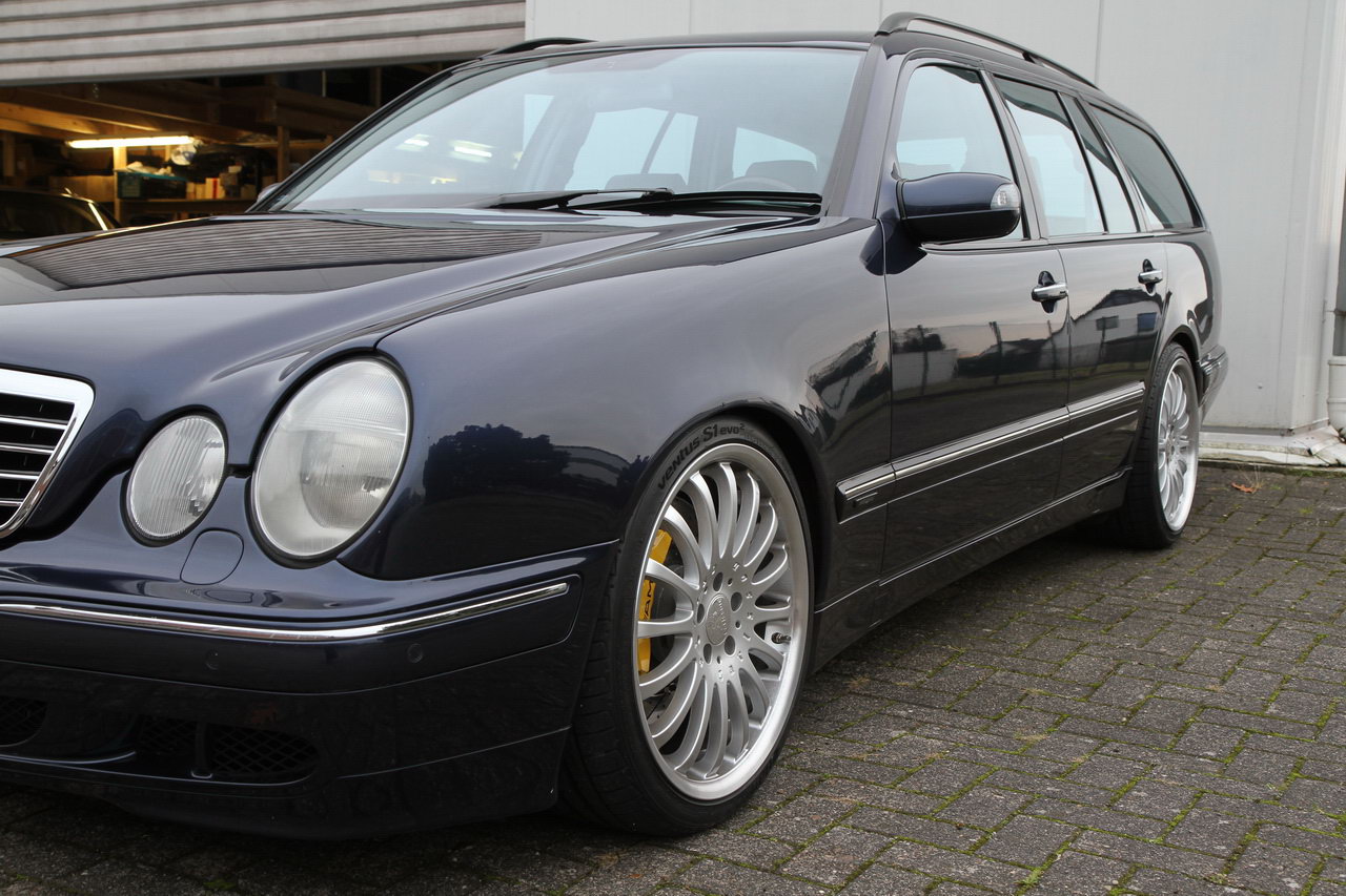

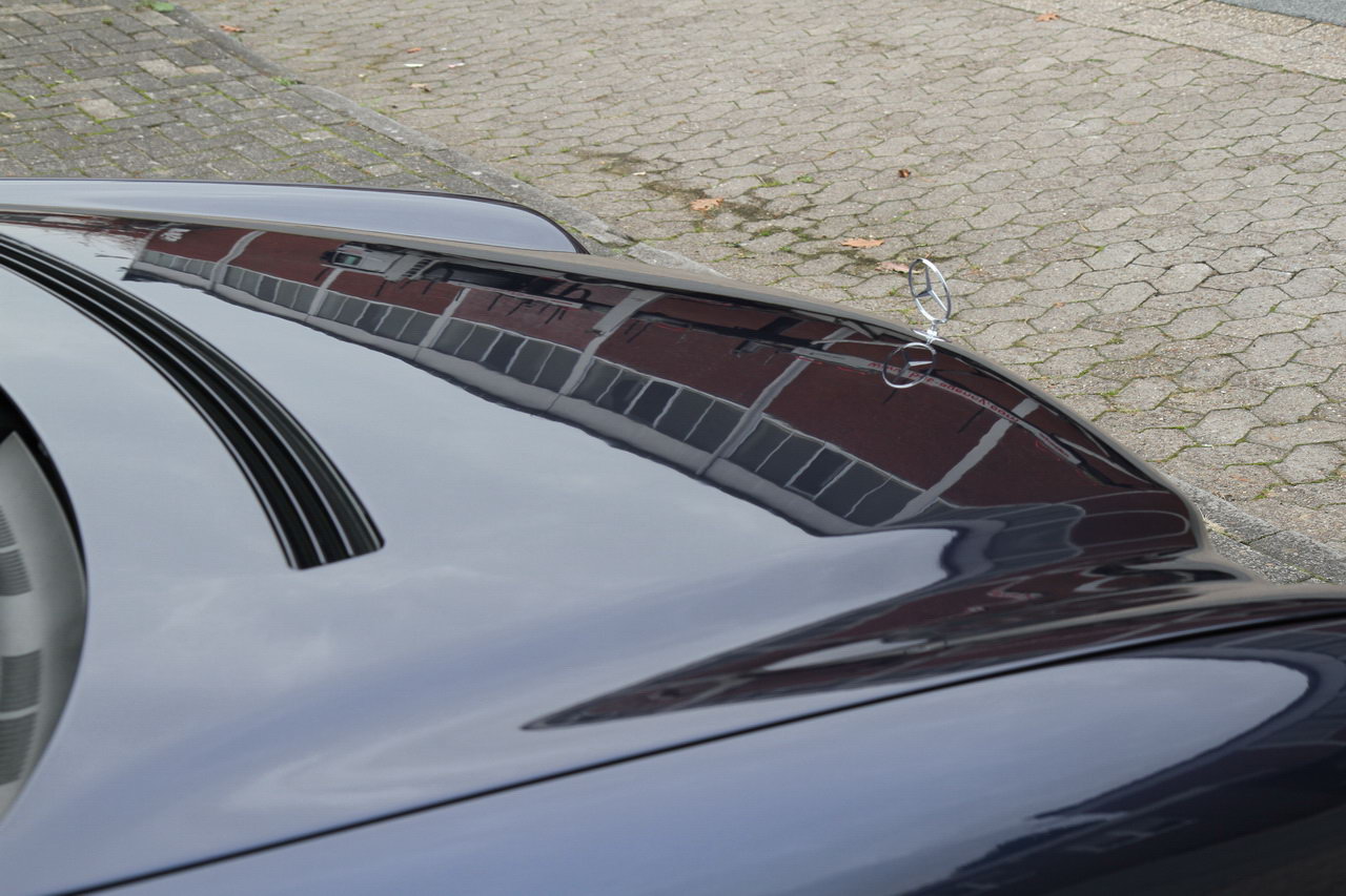

Some new Pictures... a friend of mine did a tremendous job on polishing and sealing my car with some nano sealing from "Koch Chemie". Great stuff thou

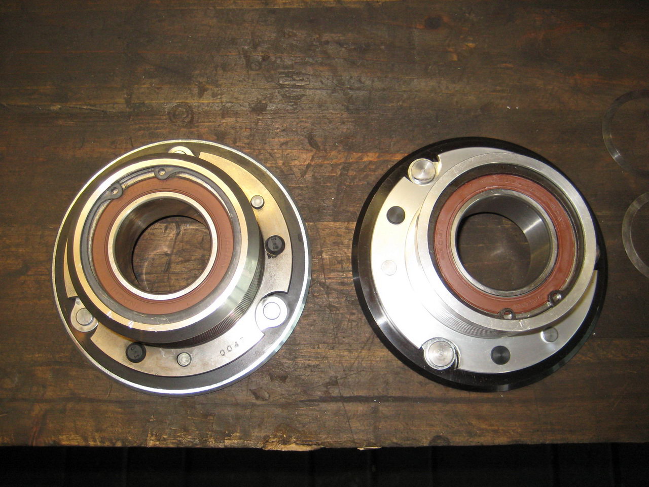

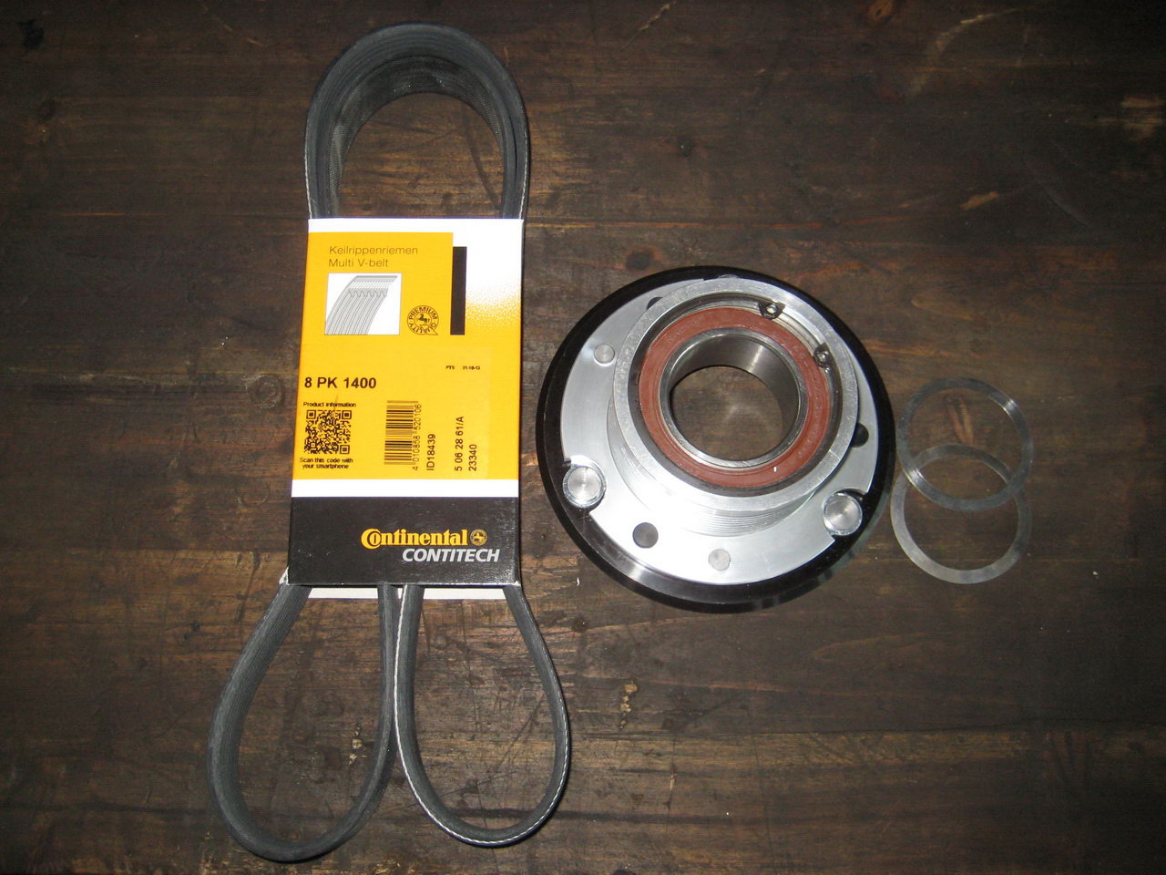

i also got my smaller S/C Pulley from Eurocharged. After a little math i came up with "172mm Crank Pulley + -6mm S/C Pulley" = "185mm Crank Pulley" ... what is a lot. I will do some testdrives the next days and see how much preasure i got now. Only with the 172mm Crank Pulleyy i had 0.85bar.
Here are the Pics:
greetins, Fabian

Your car looks fantastic! Great pictures!

Top work Fabian.. the 55K looks like it was always there

car looks like new, better than a original w210
