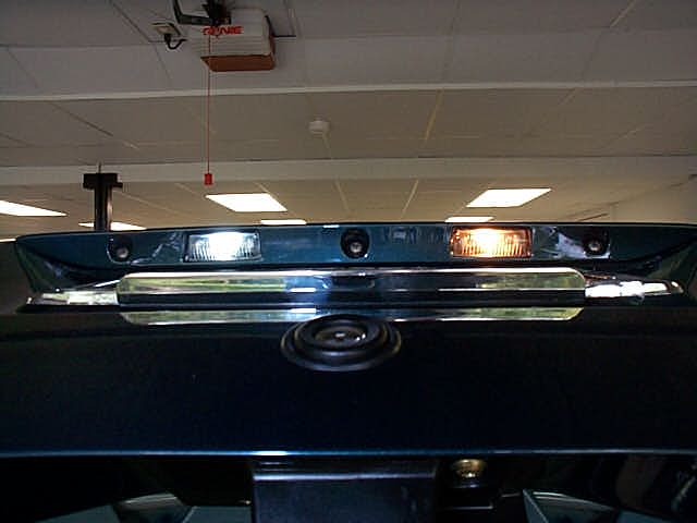

My plate is white and blue (sailfish), and with 2 X 9 led bulbs it makes my plate look like it is an LCD screen, it truly glows against the black car.
The largest selection of leds is found at http://spectrumled.com/festoon.htm
They have the resistors you will need to prevent "bulb out warning"

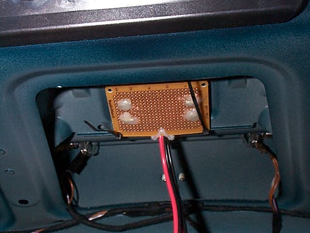

Thats it 39 they will fit tight, here is a pic of the resistors I used.
2 X 100 ohm ceramic resistors hard mounted to circuit board, I tested it for 1.5 hours and the resistors never got too hot to touch. I just mounted the circuit board so that it would not touch any thing any way, I also insulated the soldered electrical connections on the board with a generous amount of epoxy.

Ok, so installed the LED's. Without the resistor they would strobe, wouldnt stay on constantly. I than installed a 100 Ohm resis on each bulb. The lights work now, but im still getting the plate light out message...Any thoughts? Looks incredible at night, exactly like the lexus, a little brighter due to the 9leds in each bulb.. I also have tried the Hoen bulbs, barely a difference, not worth it...
-Walter
