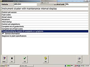

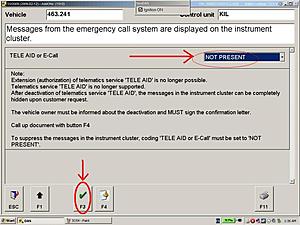

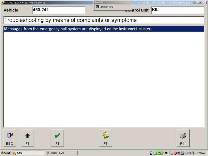

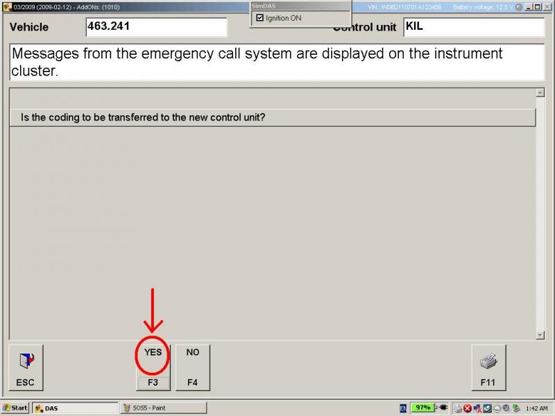

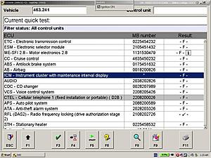

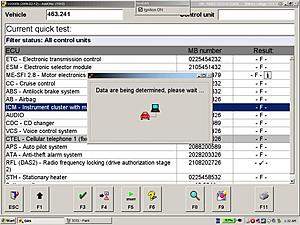

Originally Posted by more_amg
If somebody can help, I will really appreciate it. I'm trying to shut down the Tele Aid. In CGW menu, when I'm switching it to "NOT PRESENT", it will not let me do it. Any thoughts? I'm tired of this annoying mafunction.
Not sure if you have already figured this out but i got it to work on my G55. You can access through either quick test or control units. After you have chosen quick test do the following.
1. Choose ICM - instrument cluster with maintenance interval display
2. Troubleshooting by means of complaints or symptoms
3. Messages from the emergency call sytem are displayed on the instrument cluster
4. After you choose the above the next screen will have a box on the right that allows you to choose present or not present. Choose not present and save with F3 key.
5. After that it will say. Is the coding to be transferred to the new control unit and you need to choose yes or the F3 key again.
That is all and message should be gone..
Here are some pictures of the above instructions
Attached Thumbnails Star Diagnostic How To DIY with lots o pics-photo-1.jpg   Star Diagnostic How To DIY with lots o pics-photo-2.jpg   Star Diagnostic How To DIY with lots o pics-photo-3.jpg   Star Diagnostic How To DIY with lots o pics-photo-4.jpg   Star Diagnostic How To DIY with lots o pics-photo-5.jpg
