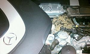

Here's what I found one day in the GL...it lives in a heated garage and gets driven regularly...not sure how they had the time to do this! I got lucky and caught it before they kept feeding....
