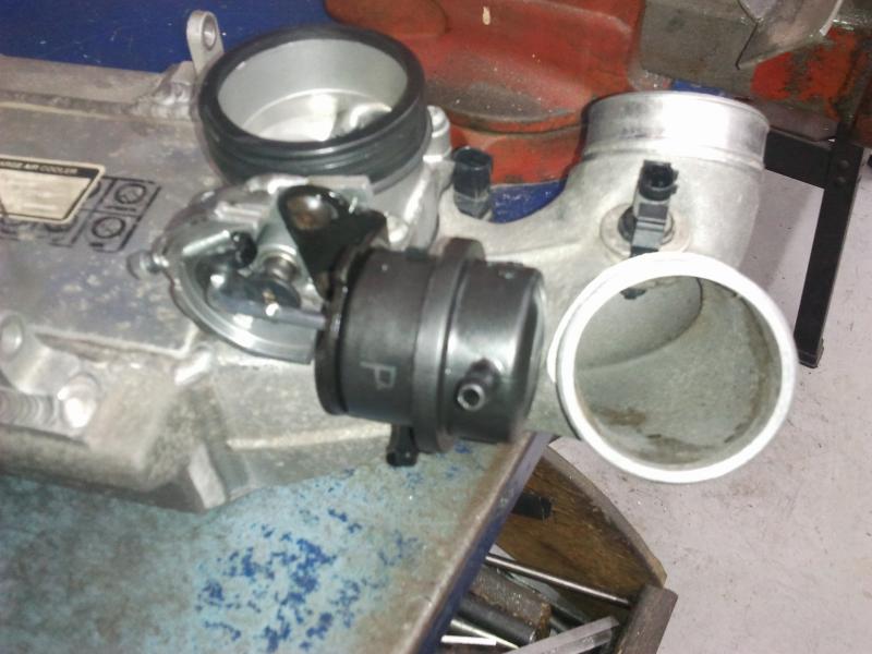

Here's a pic of my SL500's AMG set up. I had my electronic bypass actuator converted to a vacuum driven unit (see pic below)
It operates the same as my previous Magnuson blower set up. I figured I'd post in case others were contemplating a similar set up.
Shardul, your clutch less pulley system is very impressive. As soon as its tested and the proper tuning is available, I'll be ordering one from you.
Attached Thumbnails M113K Upper Fixed / Clutchless S/C Pulley-amg-intercooler-custom-bypass-valve.jpg
That is Badass!
Very smart setup. I like.

That is almost identical to Kleemann. They use a vacuum/boost actuated bypass valve. It is the smoothest transition you can get.
Ted,thanks for the props! We need to get together.
