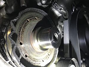

Hey guys I'm replacing my supercharger pulley with an new 83 from Eurocharged and when I took it off I noticed the two pins for the shaft were broken and they came out with the spacer.. any ideas what I'm supposed to do now? Thanks guys!

You can put the washer on without the dowel pins and you will be fine.

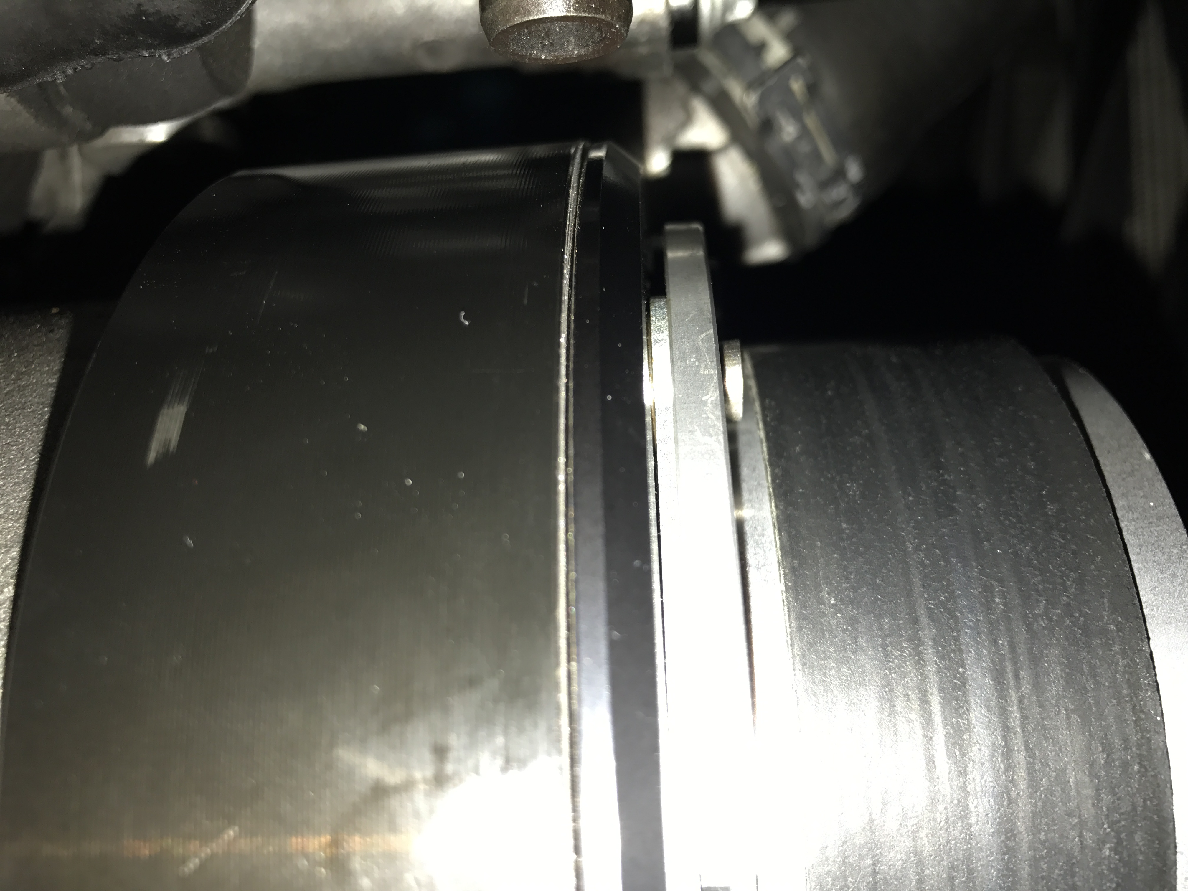

Hey shardul, I want to thank you for all your help! I installed my 83mm supercharger pulley yesterday and the gap seemed on the large side but after a drive it's nice and tight now! However I noticed one of the rivets on the pulley holding the spring seems to be crooked... damn!!! Do you think I should make Eurocharged replace it or do you think it will be ok? Thanks again!!
Here is a picture of it and one of the other ones.
