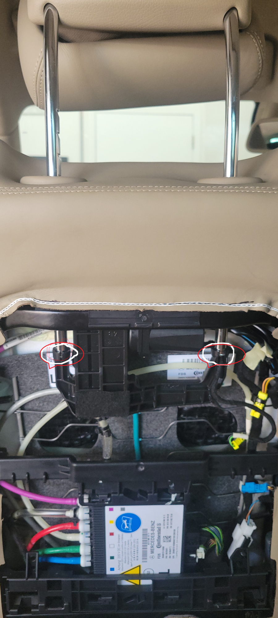

Hello Valvestud,
Do you have instruction to remove the front driver side headrest? IIf you do, can I please have it. Or anyone have it or know to remove it, please let me know. I
broke it myself. How stupid I was! Anyways, I saw some videos for the W12 but the last step for the 2 classes is not the same, The video for W212 does not have the 2 red circle as in my picture.

Never mind. I didn't pull it up hard enough. Thanks.

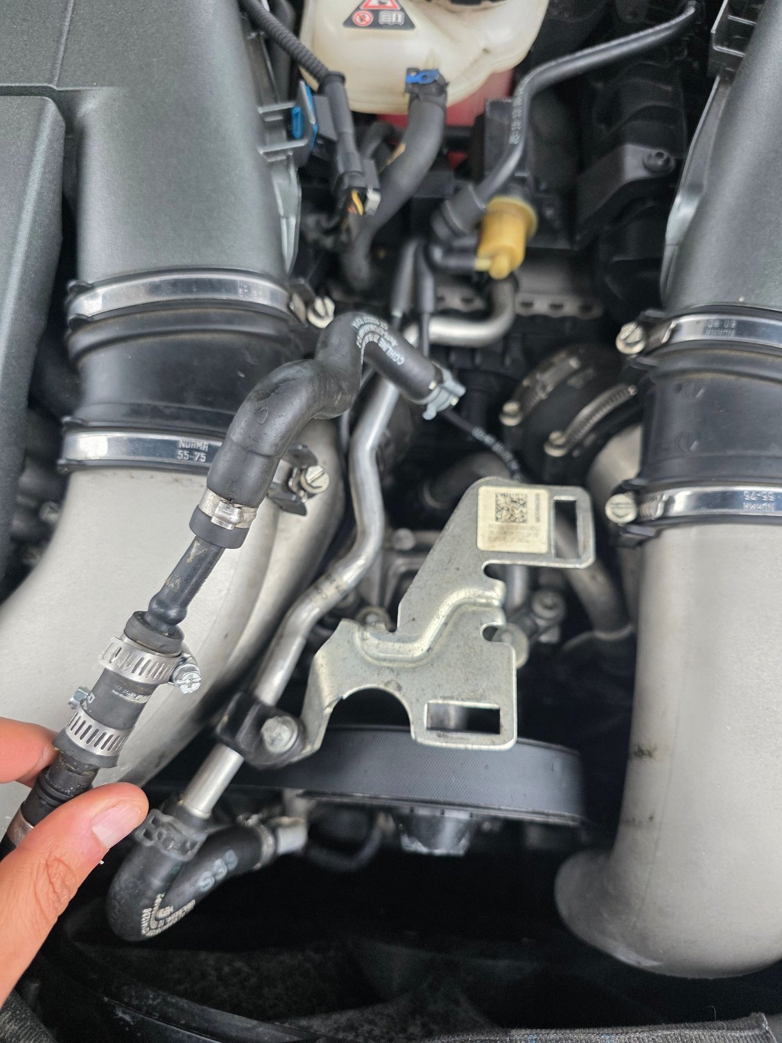

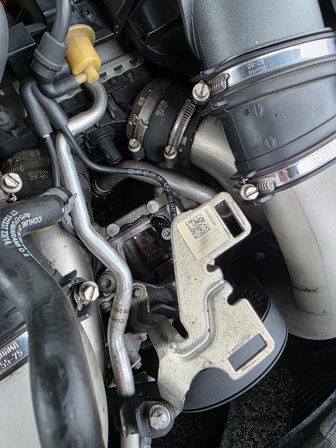

Just need help finding this part number. Its a hose with a bracket thats screws into the top of engine right behind top pulley.
