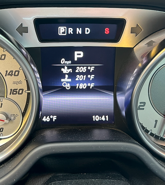

Originally Posted by JettaRed
And this is facilitated by displaying your AMG menu in the instrument cluster.
https://cimg0.ibsrv.net/gimg/www.mbw...442cf843b0.png

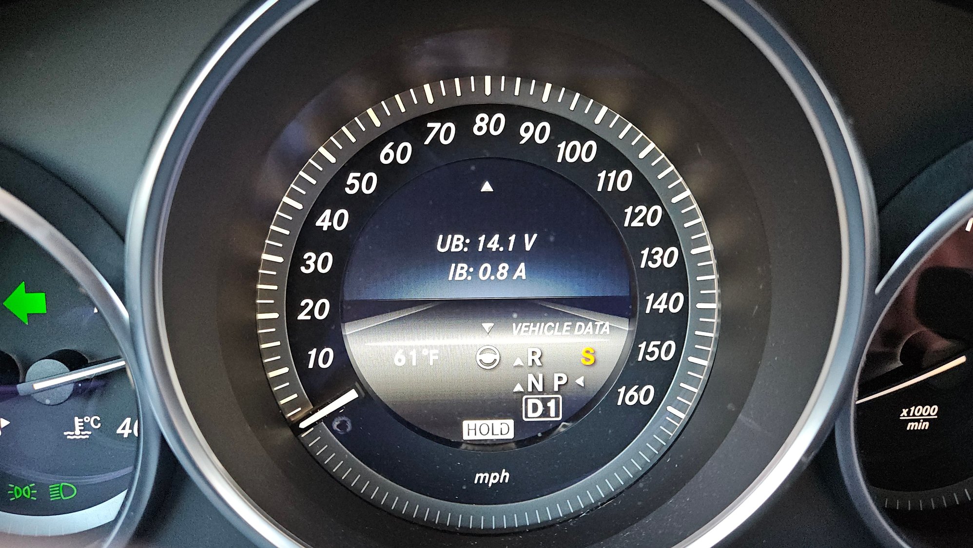

ALT-LIN trivial goodness for further granularity...
I disconnected my alternator wire today, so we'll see if I notice any immediate improvement (not expecting any). I do get the following DTC (as would be expected).
JR! I hear you about "not expecting any"... I was the same way : not expecting anything.
I was Miles away from expecting unstable voltage was hurting powertrain adaptations.
Chassis Voltage really should not affect anything but it's really obvious it does right away: no hair splitting necessary.
I soon as I started engine idled a bit higher than normal at operating temperature until throttle relearned idle Rpm automatically over 50Mi.
This is coming from a chassis with working variable voltage 12.6V/14.9V (many factors can disable the 12.6V float voltage range for a fixed voltage only). It took me a long time to get this 12.6V float managed by the REAR-SAM over > CAN-B > CGW > ECU > ALT-LIN.
> ALT-LIN Enhancement:
  1. Disconnect Batt GND at brass stud + AUX GND (Reboot step1)
  2. Unplug ALT-LIN!
  3. CTEK float Batt on "AGM setting" while unplugged
  4. Reconnect Batt Main/Aux (Reboot step2)
  5. Set IC to display shop menu: Volt/Amp: 14.15Volts /1Amp.
You do need to reboot + float AGM.
I find this stable voltage further refine the throttle granularity to help low RPM Lag associated with 2nd gear shift quality. This definitely help engine run more predictably.
This may further help settle good temp regulation (learned map control) I see as a bit moody. With MOD-1 coolant was steaming, now engine temp is just about nice and stable ie. no fan running!
Personally I think this is directly helping CAN network timings (just like "solderless" does), not only ignition coil secondary voltage or 3-phase pump output volume.
Plan is to go rework F-SAM artificial wiring bug and then try that vs. ALT-LIN stable vs. stock variable voltage.
The long story short is variable voltage contributes to LAG (poor throttle granularity) and by domino effect disable necessary tranny adaptations (confused: slugging + banging).
Where there is lag from poor throttle control there is confused tranny shifts. This is positively helped with smoother timings.
+++ Let me link my REBOOT procedure...
I use jumper cable to prevent sparking grumblings awake.
+++ Cancelling LAG yields strong responsive linear gas pedal with seemless shifts... like a good engine.
This is for civil driving style under 3500Rpm.
Lots of responsive torque with pressure sensitive pedal. No need to climg in the R's

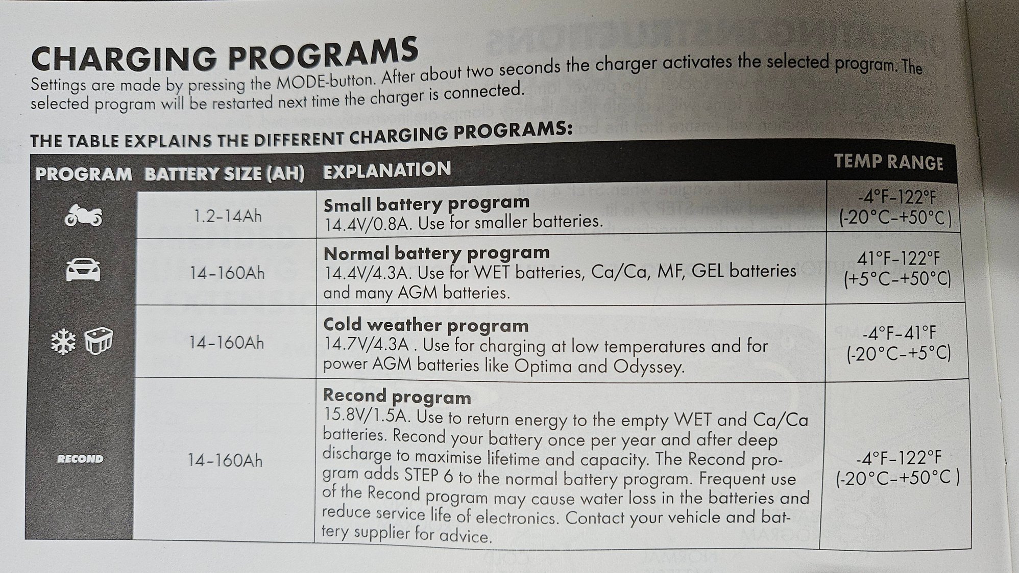

can you expand on the ecu connector? Snipping wires instead of pulling connector?
I want to do this too but it is crazy cold in Ontario so getting under the car is not fun right now lol. Barely did the oil solenoid but got that mod out of the way finally.
Also what do you mean by CTEK AGM Float while disconnected?
Old Jan 14, 2025 | 07:26 PM
  #2518
JCM_MB's Avatar
Joined: May 2021
Posts: 2,524
Likes: 2,041
From: US
2008 E350, 2012 ML350, 2014 E350, 2015 ML350
http://CTEK MXS 5.0, Cargador De Batería De Coche Y Moto 12V 5A Con Compensación De Temperatura Incorporada, Cargador Inteligente Baterias, Mantenedor De Batería Con Opción De AGM Dedicada https://amzn.eu/d/09Es0oQ

> ABOUT CTEK AGM FLOAT:
CTEK smart charger has a dedicated "AGM mode" to re-balance battery cells using a slightly higher voltage.
details of steps vs. settings
available operation modes
smart electronic float charger
Using this cycle optimizes the battery to be more powerful with lower internal resistance.
The draw back is higher voltage is not good for some of the chassis electronics that use cut throat margins (Main amplifier uses 16Volts caps!). So its best use while battery is out of circuit else use normal float mode, (just not AGM).
battery sensor shows it doing nothing
Again stable voltage is a nice thing but the key is what it does to module interoperation.
Speaking of LED HL, I think ALT-LIN stable voltage make them a tiny bit less bright than stock voltage swings. So electronic control adapts better to fixed voltage.
