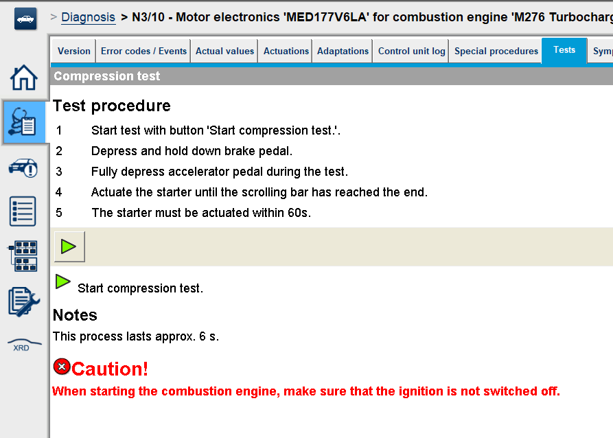

There is a process of holding down the brake pedal and accelerator pedal to the floor while you crank the engine. That is the method used when doing the comparative compression testing. The engine will turn over without starting. That seems to be common among many brands of cars. Someone may want to confirm that. If that works, you may not need to pull all those fuses.

The process is called "clear flood mode". You also have to hold down the brake at the same time.
Here is a related video that may better explain things.

...There is a process of holding down the brake pedal and accelerator pedal to the floor while you crank the engine. That is the method used when doing the comparative compression testing. The engine will turn over without starting. That seems to be common among many brands of cars. Someone may want to confirm that. If that works, you may not need to pull all those fuses.
Here are the procedures in XENTRY for the compression test.

The one in blue is some US cars is called : Clear Flood mode, on purpose for CRANK ONLY, but NO START, our W212 can't do that.
We need to do Xentry Compression Test ( relative compression test ) to do this. This test would not produce DTC and will do CRANK-ONLY but NO START, while getting the
Relative Compression value by way of cylinders crank speed comparisons .
