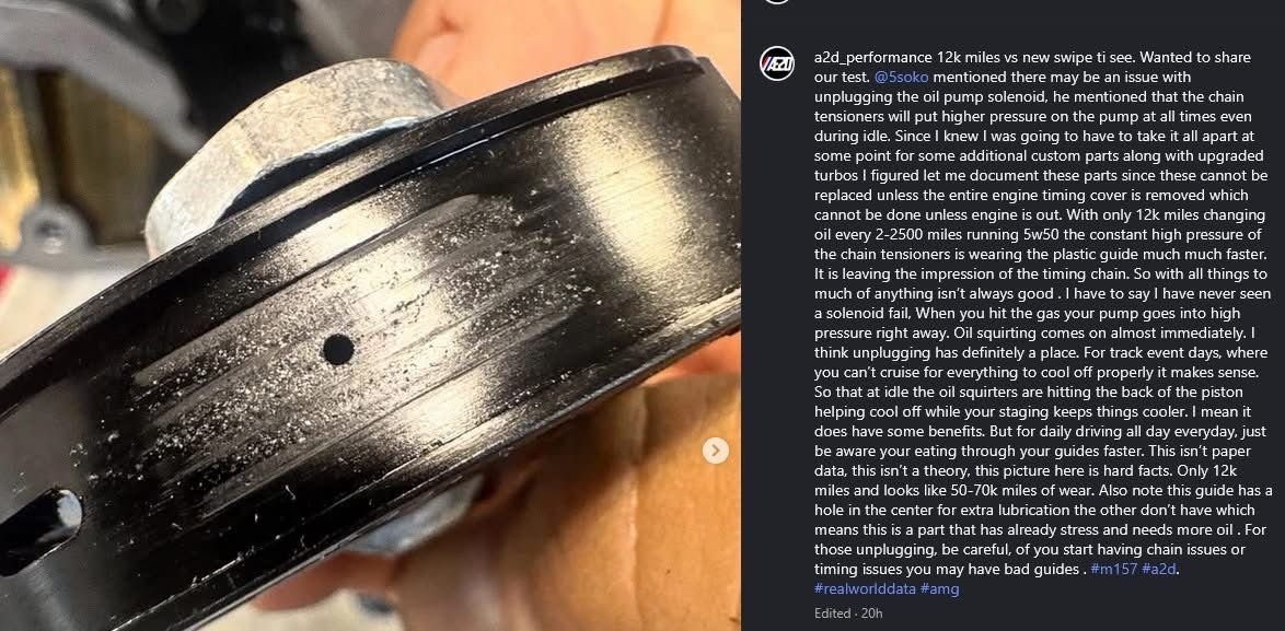

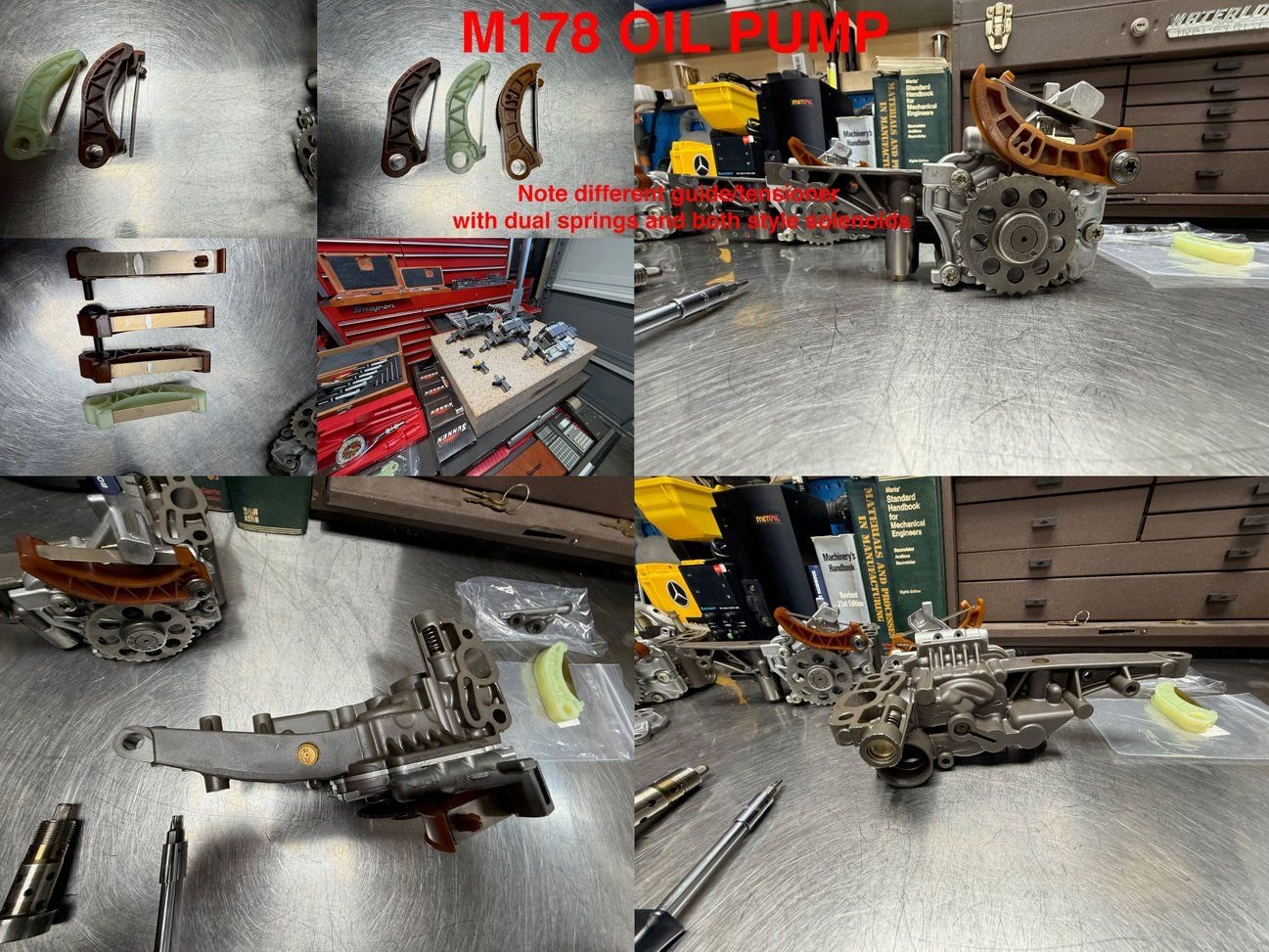

Quote: Ah I see what you mean….
Tensioner was new, what you see is the result of 12k miles on new tensioner.
did I miss that? That the tensioners were new at the beginning of one 12k mile experiment of unplugging the solenoid? I don't have fb
edit: so these were new guides as per your updated above
what is the average life of those chain guides in "normal" use ?

Quote: did I miss that? That the tensioners were new at the beginning of one 12k mile experiment of unplugging the solenoid? I don't have fb
They’re swapping bigger turbos and an intake. So the engine was coming apart after break in. That’s why they decided to experiment with disconnecting the solenoid. They knew the engine had to come apart again. It was a perfect opportunity to run some tests.
I think killing the messenger here isn’t productive, and to be honest they (a2d) appear pretty competent. I guess we’ll just have to wait until someone here who has done the mod for 12k to pull their engine or top end apart. Bet the oil filter had some guide material in it. You guys may want to dissect them after oil changes….

Quote: They’re swapping bigger turbos and an intake. So the engine was coming apart after break in. That’s why they decided to experiment with disconnecting the solenoid. They knew the engine had to come apart again. It was a perfect opportunity to run some tests.
Here’s one of their (a2d’s) products
https://modalwork.com/products/m157-...hHut_bf7bMJxvv
who is killing the messenger?
we are allowed to evaluate all data and ask questions yes? Or does it change based on our position? A2d wants to know more about this as do we, and being the highly competent people that I'm sure they are - they welcome a discourse on this ongoing yes?
they are one engine with one solenoid unplugged; I look forward to more engines revealing their wear and tear inspections

REDLINE WITHOUT MOD
This would be an interesting discours if it was not misguided by FB types.
"MOD high pressure is wasting pump chain guide".
> Seriously :
-- WHO REMOVES his engine out and takes it apart every oil change ??
-- WHAT APPLICATION are we talking about here: driving at 2500R. or racing at 6500R.??
-- WHAT ABOUT the other 3x chain guides: /worst /ok /better ??
-- WHO REPLACES tensioner at 12K intervals ???
-- Is this part s known defective design for high Rpm ??
-- I can not conclude anything from looking at a worned plastic guide besides I agree it does look poor.
I don't think an engine intake company is worried about chain guide as much as vaporized oil jacketing intake valves near their intake.
They should build an effective PCV oil separator to keep oil away from their intakes.
Personally I don't believe normal driving damages engines the way redline extreme output does.
It's entirely normal to rebuild racing engines. Everything goes, it's all good business for max output.
Now let's remember that above 3500Rpm oil pump is set to full volume regardless of MOD.
I can readily go along "a2d Intake GMBH" customers to enjoy stock oil setup as they please. So they can directly question suppliers for better grade when their stock plastic tensioners fail.
REDLINE MOD-0 PRESSURE = MOD-1.
There's no point in disabling pump solenoid for racing when the ECU already does that above 3500R
There is a use case for better oil specs but that's not "MB Approved" to save-gas.
Solenoid MOD is as described. If your engine bottom Rpm is responsive and your tranny shifts seamless then don't change a thing. Let's make this more simple the other way... if your tranny shifts seemlessly that means your engine is well controlled.
MOD-X is not about oil pressure it's about disabling stock spongy hesitation around 1750R.
Poor powertrain control is caused by bad cam timings and cured by effective cam positioning.
SOL-MOD is clearly not useful to prevent wear in full bore racing. ECU disables solenoid at 3.5kR
> You know it's peculiar when an oil pump specialist has nothing to say about :
-- pump chain chewing guide...
-- anything that can be sayed about pump latteral freeplay...
-- Any data about what force a pump tensioner shaft under 60Psi Max puts on the surface of tensioner??
> STOCK VS. EXPERIMENTAL MODS...
Are on a different path
ALL MOD void warranties
More power > more wear > more repairs!
Good stuff for free is not for scarry cats.
Reply 1

MY question would be, is the companies assumption that these vehicles will have this wear after the vehicle has 12k miles about 3500 rpm....meaning after 30k miles but a third being in high rpm. If oil pressure is an issue, would it not be regardless of the mod. Considering a full teardown, was a new timing chain installed (and therefore all/every sprockets and gears that touch the chain), and was it an mb chain? Was the finish/polish of the chain correct? Is the tensioner the same part number as stock? Were the guides all replaced with original mb parts and were they the same part numbers and batch numbers...? Is the car otherwise completely stuck with no upgrades, no, well then how are those variables accounted for in the assumption. Basically, are all variable being considered in the assumption that oil pressure is the cause? I would need a much better breakdown of info to make a conclusion. Would a stock car have this issue or is it really a case of lots of parts touched and assumptions made but are in no way part of a reliable experiment. One thing we can all agree on is that a five weight starting number for the oil is the same regardless of the final weight of oil, and that 50weight final viscosity is not as volatile as 40 weight (the old weight used by owners of cars with the majority of any engine issues) so should have better AVERAGE performance, especially with some mileage/use.

Quote: just saw this in fb mb group
here is the link to original thread in instagram, yesterday i just saw the pic in FB that's why i just attached it
View this post on Instagram
Reply 1

Quote: here is the link to original thread in instagram, yesterday i just saw the pic in FB that's why i just attached it
https://www.instagram.com/p/DNQt_pVxAsp/?img_index=1
This is absolutely something I will be mindful of. However it is one data point and there could be many other factors involved and if so how were they ruled out?
For me then the answer is to leave the engine as designed for now and drive 'properly', whatever that means.

I remain unconvinced that we have any evidence that unplugged solenoid solved anything other than "feel at the seat of the pants" when driving.

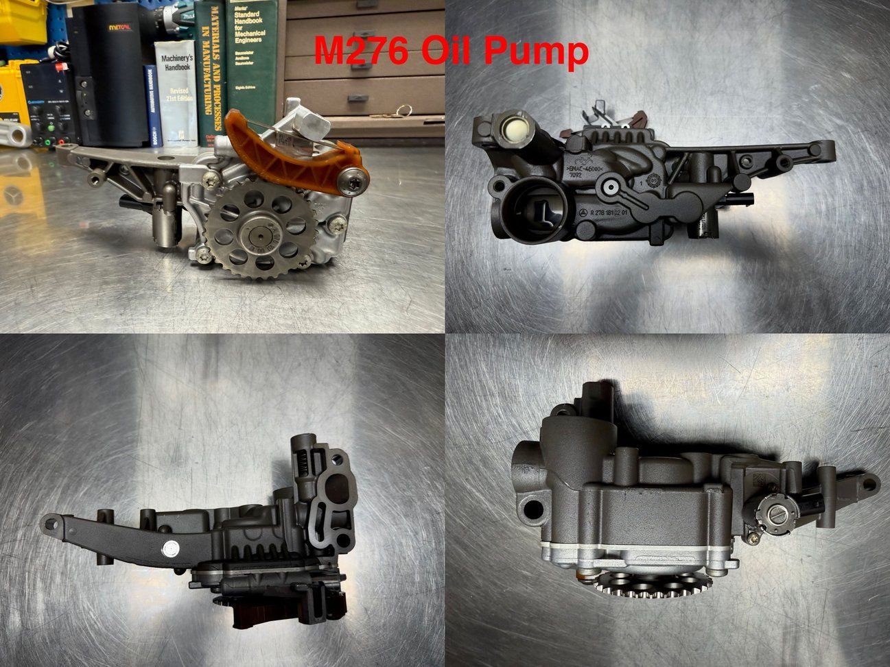

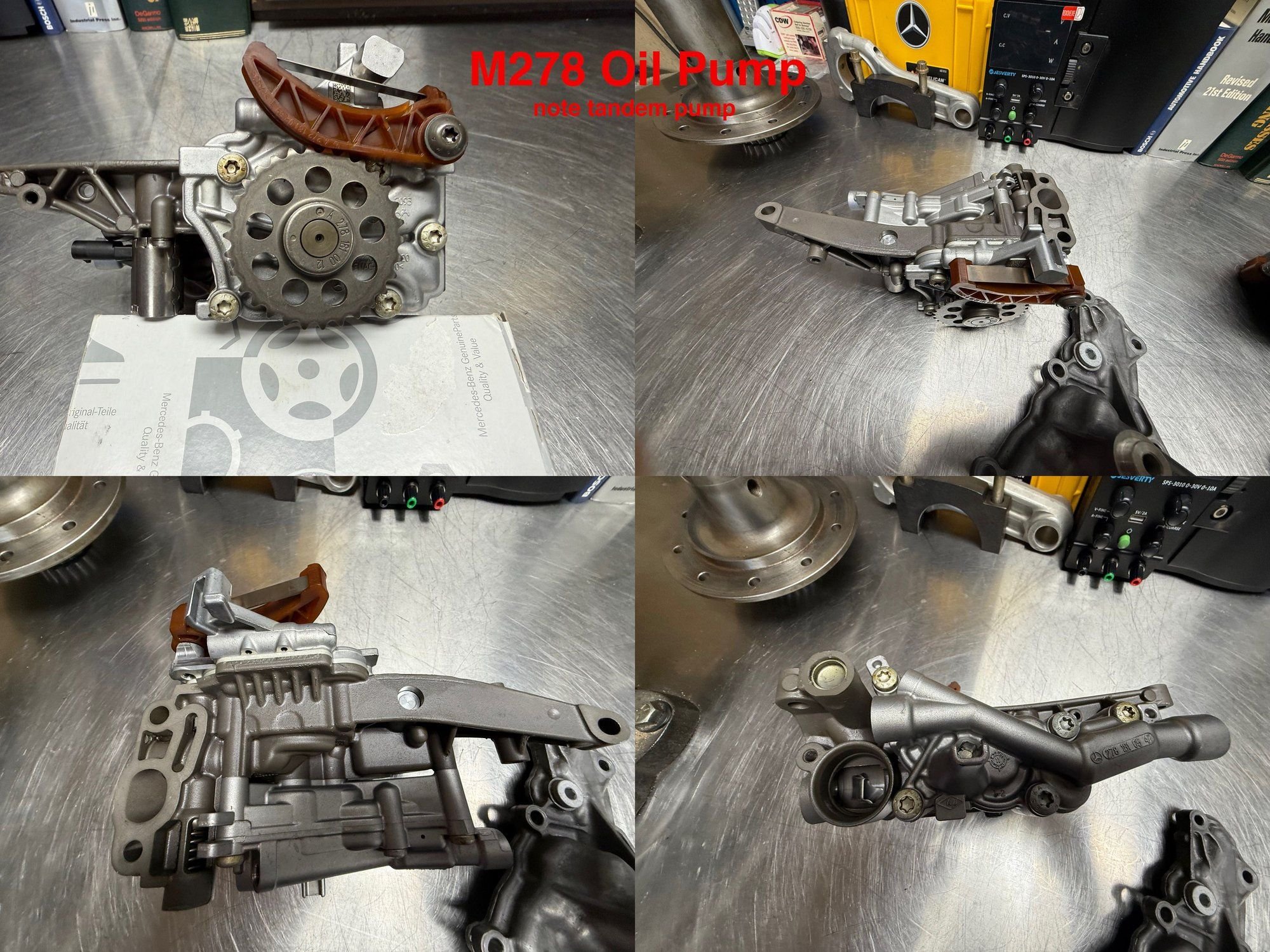

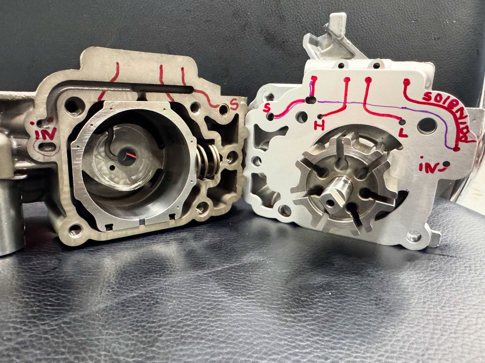

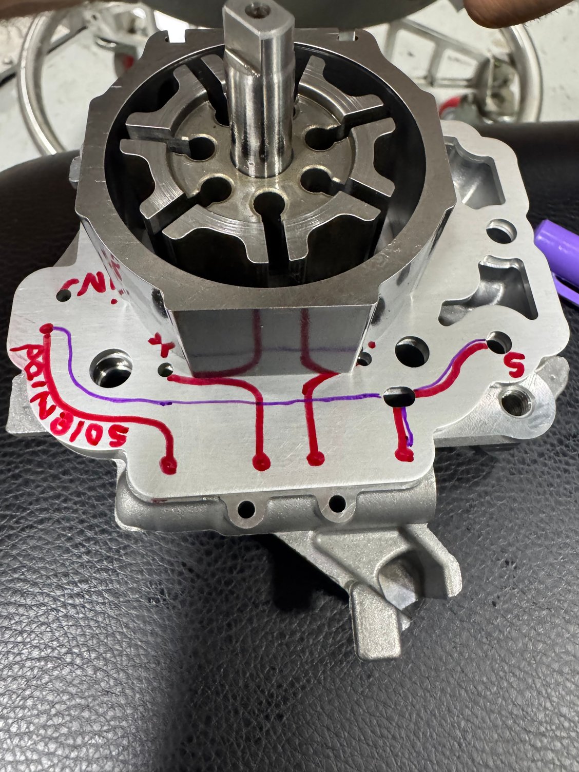

So I spent the last week digging deeper into the m157 oil pump, oil solenoid, how it functions and my conclusions. My first thought about doing this was hesitant. Unfortunately nobody wants to be attacked because the information they have uncovered doesn’t align with what the masses have assumed. Understand I’m not trying to knock anyone, I respect everyone’s time and efforts and the fact that we are all trying to improve the performance of our cars no matter which aspect of the car it may be. In addition I have seen some with not even the ability to take an engine apart make statements about probably one of the best m157 engine builders we will probably ever have, and writing him off as he is some pansy like he doesn’t know what he’s talking about. Aka(Tasos). I think it was just a little difficult for him to articulate it so that the avg person can understand it. Or so it seemed. If anyone thinks I’m wrong that’s fine you’re entitled to your opinion. But remember it’s just an opinion until you grab a pump dissecting it like I have and coming up with what you think the pump functions like. But I’m really good at what I do . Again don’t shoot the messenger I’m just sharing my findings and this is just a small sample of what I have done to figure it all out . I will be making a post with detailed pictures small videos with explanations. I’ll just need a little time since I’m busy at the shop . But a quick summary. The pump cannot fail in low pressure, if it fails , it will fail and automatically go back into high pressure, which probably explains why it’s not a hard code since they figured by the time it failed there’s probably a **** ton of miles and there’s no point in dropping everything. 2 things can be true at the same time . Yes this is done for emissions, better fuel economy, longer intervals etc so there’s is definitely some merit to what some have found. I think it has a place. But I’ll go more into detail when I can make a post and explain it all and how it all works .
Reply 3
Aug 16, 2025 | 11:58 AM
  #3900
@Cifdig
Thanks for using your resources, money, AND TIME to post some badly missing testing. It’s been a concern. Along with several other potential issues. I would definitely be dissecting my old oil filters in search for guide material if I had a customer running this “mod”. Changing the designed operating oil pressure of the engine creates several interactions within the engine. Some have the potential to damage the engines though unforeseen long term consequences.
The pumps themselves are different too. The M278 has a tandem pump which will also add to the load on the tensioner/guides.
It’s always tough responding to a wall of texts, google searches and vague posts speaking in “tongues”, from people taking this personally. People have to realize, it’s not personal. If your data is wrong, doubling down and posting walls of google searches and youtube videos is unproductive for the community in general. We all realize everyone wants to help. But we’re looking for competency, not quackery.
This is an important data point that should be taken seriously. Remember folks, it’s about load cycles on the pump (mechanical engineering term, not the electrical definition)
Good Luck Folks!
Guide/tensioner had actually broken on this M278 oil pump.
Broken guides, more pressure on the tensioner/guides than people realize.
Reply 2
