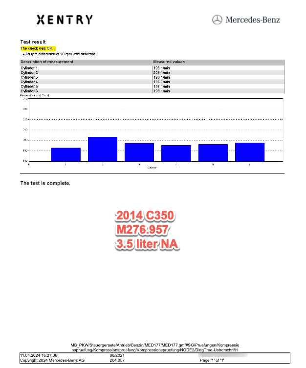

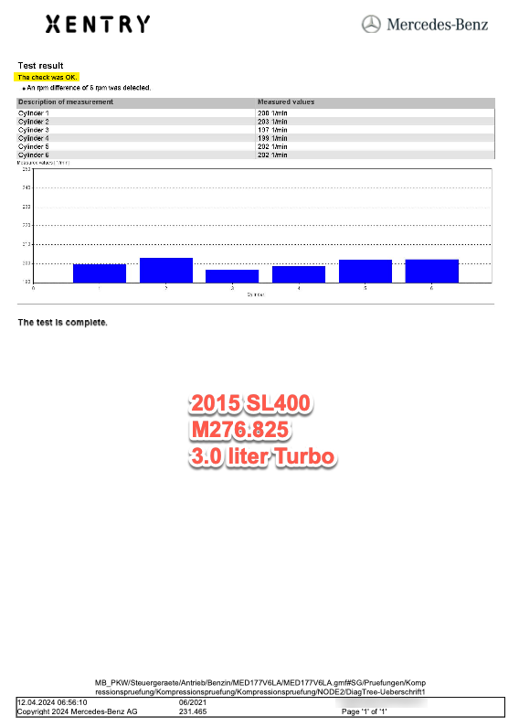

I did compression tests on my two cars using XENTRY.
  • My 2015 SL400 (M276 3.0 bi-turbo) has been unplugged for about 3100 miles and five months. It is using Mobil 1 0W-40 with about 450ml CERA TEK and 300ml Mobil 1 15W-50. I have a little over 2000 miles on the oil.
  • My 2014 C350 (M276 3.5 NA) has been unplugged for about 3000 miles and 4.5 months. It is also using Mobil 1 0W-40 with about 450ml CERA TEK and 300ml Mobil 1 15W-50. I have a about 2300 miles on the oil.
The results were similar and looked good.

Old Apr 12, 2024 | 12:41 PM
  #1524
CaliBenzDriver's Avatar
Joined: Apr 2019
Posts: 11,923
Likes: 6,776
From: Silicon Valley
W212 MY'14 M276-3.5NA @75kMi
good setup 👍
JR: I'd call that a really good setup
We observe RPM differences between TT/NA... it's likely the battery load handling or voltage drop in oxidized GND strap difference under 750Amp.
Also it's interesting to see that Cylinder 1 away from gearbox is always the weakest and the first candidate for piston issues.
We note the TT shows more uneven contributions. That suggest some type of wear hopefully helped by wet rings.
With that setup you can expect your ECU to deliver GDI timings. Mine started on fresh 5w40 MOTUL even before doctoring my viscosity. It was spraying for about 1500 to 2000.Mi before enough viscosity was lost to smoke.
When you notice cold startup RPM improving and the starter launching the engine into high RPM instead of laboring.... then you'll know your ECU is handing out timings improvements.
In any case you are getting necessary dry-lube chemistry combined with spray cooling such that your oil viscosity remain stable. This delivers unaltered hot engine performance vs. spongy response with heat in MOD0.
Knowing this is good insurance against "$10k oil-in-harness" and perhaps blown up engine is rather comforting.
