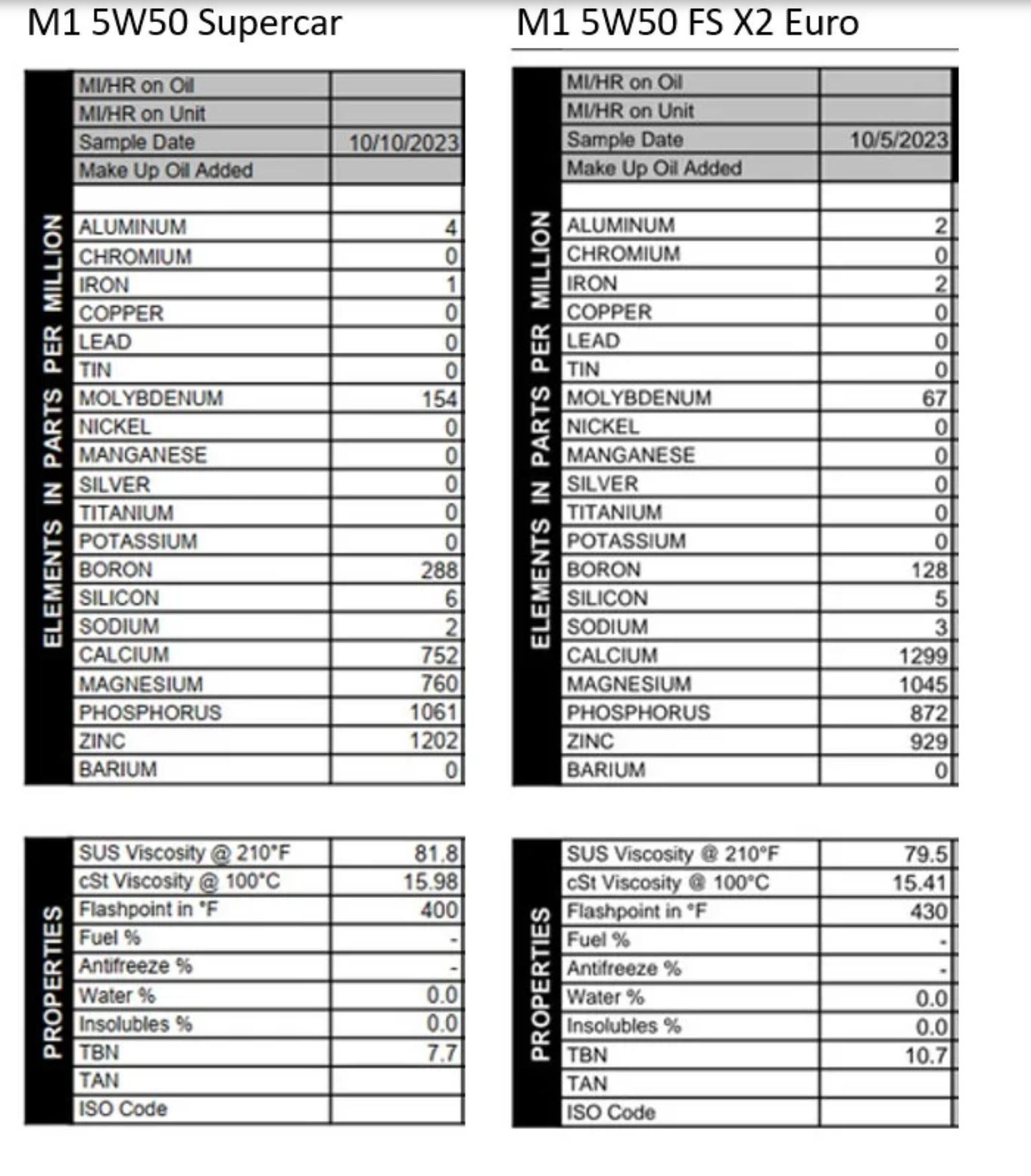

Can you pls post these specs... I can't open the files without being a member.
MOB1 5W50
MOB1 5W50
Let's see which Mobil1 product works best with high heat.

MOB1 5W50 SELECTION
Originally Posted by Cla1111
Both are excellent high quality oils with high flash temps (400/430F) for less impact on viscosity variations.
Given the choice, I'd pick the right side oil for its cleaner formulation with less zinc contaminants.
Left side oil has higher protection package for higher output applications.
The flip side is higher deposits... necessary for protection!
High power output needs proven solid anti-friction besides a viscous film. This has not changed!
Thin lubricants with clean-lean formulation wear out engines more rapidly.
Mixed city driveability: right side oil
Spirited power protection: Left side oil.

@CaliBenzDriver would you say 700+ horsepower m157 motors Qualify for left side oil over right side?

From 500 to 700+ HP application:
that would be left side : "MOBIL1 Supercar" with additional friction modifiers - Viscosity alone can not protect high output engines nor trannies.
That's when ZDDP steps in and Lambda/cats are replaced by mapped fuel. MOTUL has a ZDDP RACING oil.
This must be a true blast to handle!

thank you for the great info! Really tough choice between M1 Supercar versus Motul 8100

Correct on the old mobil but it seems the new sp is better performing in the lab. Like you said, lots of testers would be great and with this popular thread, Im sure there will be many to follow.
