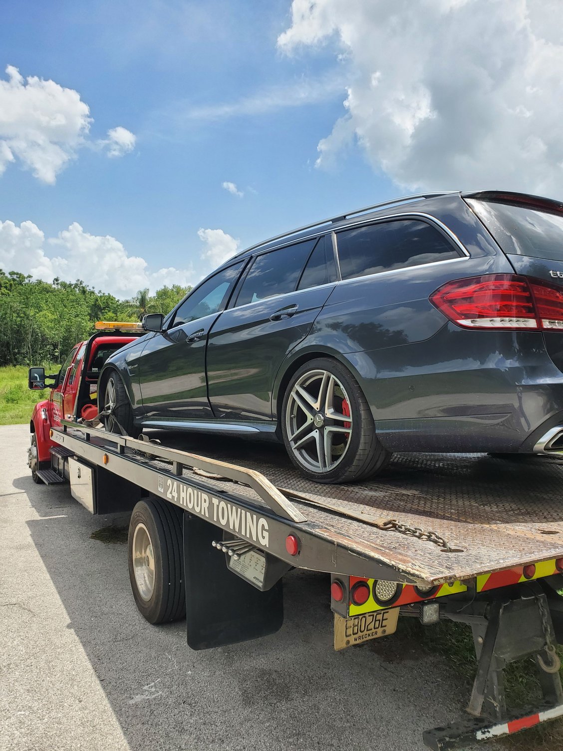

Freaking now what.
With brand new battery
https://youtube.com/shorts/cAcvfqsrI_4?si=FKuD6CbnW0sXWrfj

Gets weirder. Disconnected both. Rear is good. Front is new...

Running

No. Really the behavior is the same with the old one and the new one.

Fix? I was JRA...parked the car for about two hours. Got back in and this....figured it was low voltage. Tried to jump it...same error. Went and got a new battery. Same. Unplugged rear battery....let it sit an hour or so. Plugged batteries back in....same.
Mechanic is thinking some motor on the trans or a trans resister plate....said to take the blue and white wire out of the CAN (pass foot well) and see if I can scan the car after that....

The scanner does not see the engine or the trans...moves on to the Dash that says it can not see the engine. Looking at TCU and Trans stuff now (about 45 minutes from the car).

Turns out the issue is a transmission Servo motor that is about $800 and requires proof of ownership of the vehicle including driver's license to even order the part
