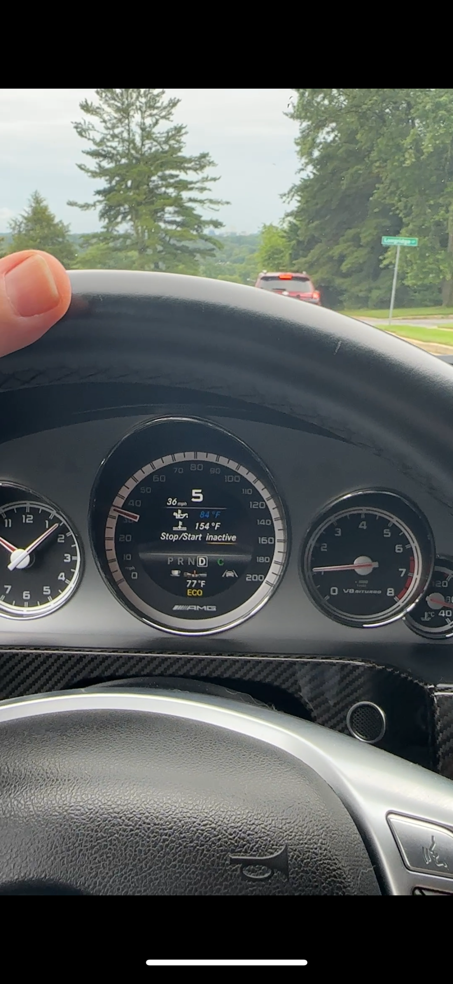

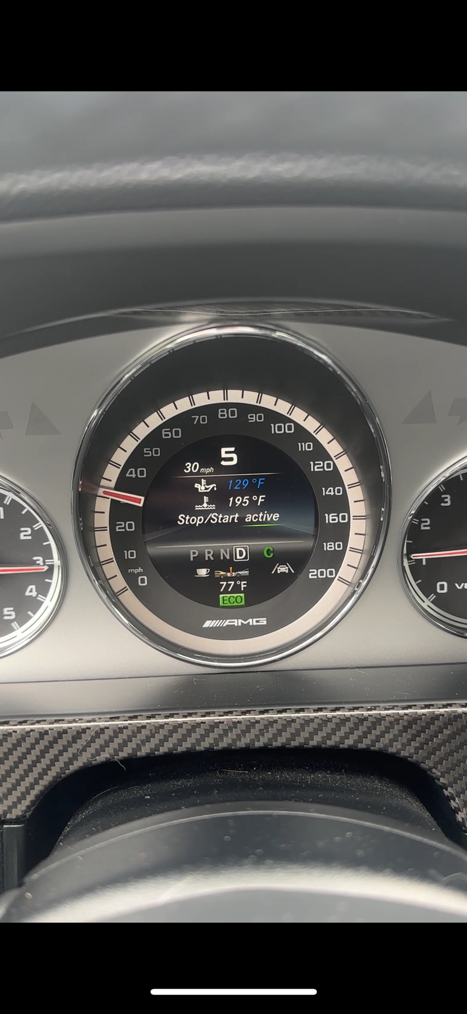

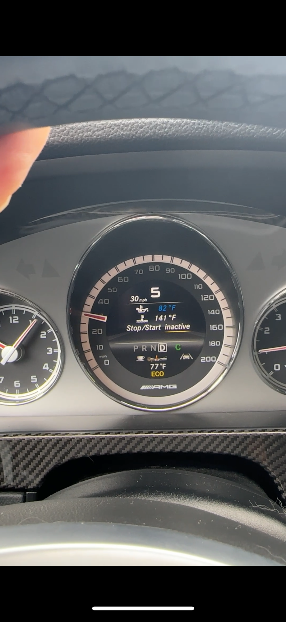

Some pics-warning Eco mode on…lol
.1 ish miles. Idle down and drive
.2 mi
.2 mi
Exactly one mile @ 25-30mph.
these pics are pretty close to my description as the temperatures were changing during the videos
.2 mi
.2 mi
one thousand Rpm 30mph 5th gear
one thousand Rpm 30mph -- 5th gear
Did you cover the whole distance at 1k.Rpm ?
Oil could no pick up any heat, coolant was forced to pick up 100% engine heat.
Once the engine has been re-checked by sce dealer,
I'd try pumping coolant by driving at higher Rpm, like 2000Rpm

Ok, you know there's one failure condition that can cause real fast heat up...
You said the solenoid harness inside the oil pan was worked on by MB dealer tech, right?
Stock enabled solenoid should now be switching Low/Normal pressure at startup then above 3500Rpm.
-- Did they replace a new solenoid that had not been working
or is this original solenoid with new harness?
-- Your engine type don't happen to read oil pressure, right?
-- Does engine idle normally smooth /wet or extra vibrating /dry ?
solenoid harness only based on the parts description. Never had any issues with the solenoid.

Should be picking it up soon. They flushed coolant again and do not notice anything that looks abnormal to them at this point. One suggestion is that the newer coolant is keeping the car hot for efficiency, which has been discussed before..
When first receiving the car back, I noticed there was a little bit of residue that was not blue so I had asked them what type of coolant went in and had them double check to make sure everything was correct. The new coolant was a regulatory required change and Mercedes now says it is OK to mix new coolant with blue coolant as well as just use the new G40 coolant. I had them provide me the documentation and I’m providing it here for awareness.
so I’m wondering, is anybody here on exclusively G40 coolant?
This is actually posted right inside the door to their shop.

STOCK HEAT MGT
no, engine does not read oil pressure natively
engine started and seemed very smooth. A little almost in perceivable shake on idle down, but I think that is due to the adaptation to the new clean valves. Drove very smooth. No perceptible lspi.
I think you should be golden with this service. You may want to re-learn stock heat Mgt with Rpm.
Fact: at 1000.Rpm hardly any pumping can happen!
> TEST DRIVE OK?
-- Do a warm-up test drive keeping up engine near 2000.Rpm with paddle shifters.
This will help pump the coolant all around.
-- Oil has no chance to pickup any pistons heat.
MOD-0 cylinders are kept unsprayed below 3000.R
-- So cold oil is only warmed up by coolant through the heat-exchanger.
Always keep an eye on levels of both COOLANT + OIL before starting with engine cold. Engine may develop leaks.
+++ MOD-0 STOCK HEAT REMOVAL...
-- Cylinders heat is exclusively managed by coolant circulation through smart-Tstat.
-- The energy-efficient water pump Rpm needs to be kept up 1750.Rpm for effectiveness.
