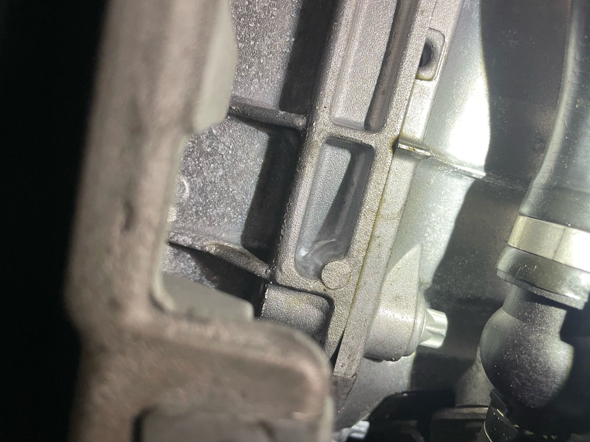

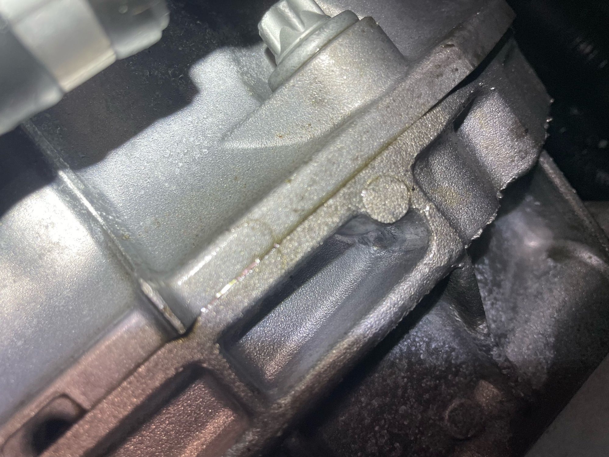

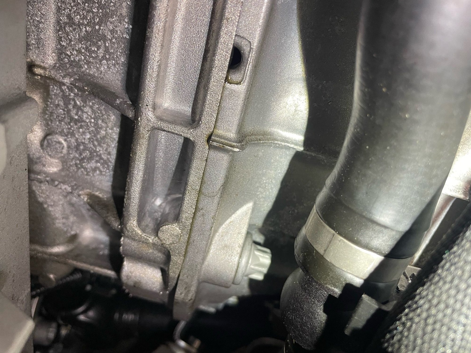

I'm being a little lazy here as I did not read the whole thread. Changed my oil yesterday using a youtuber for guidance - I checked the RMS as he advised and I had a very light amount of oil residue where he said to look. Everything I have read so far says this is more common on 18-20s with around 50k miles and you definitely know you have an issue due to oil drips on the floor. I have a 21 with 5k miles and have no drips on the floor, just this light residue. I'm taking the car to a mountain home that is 3-4 hours from the closest MB dealer, so, if needed, I'd prefer to get the issue fixed under warranty and while I'm nearby numerous dealers. Do y'all see anything alarming here?

It’s leaking.
