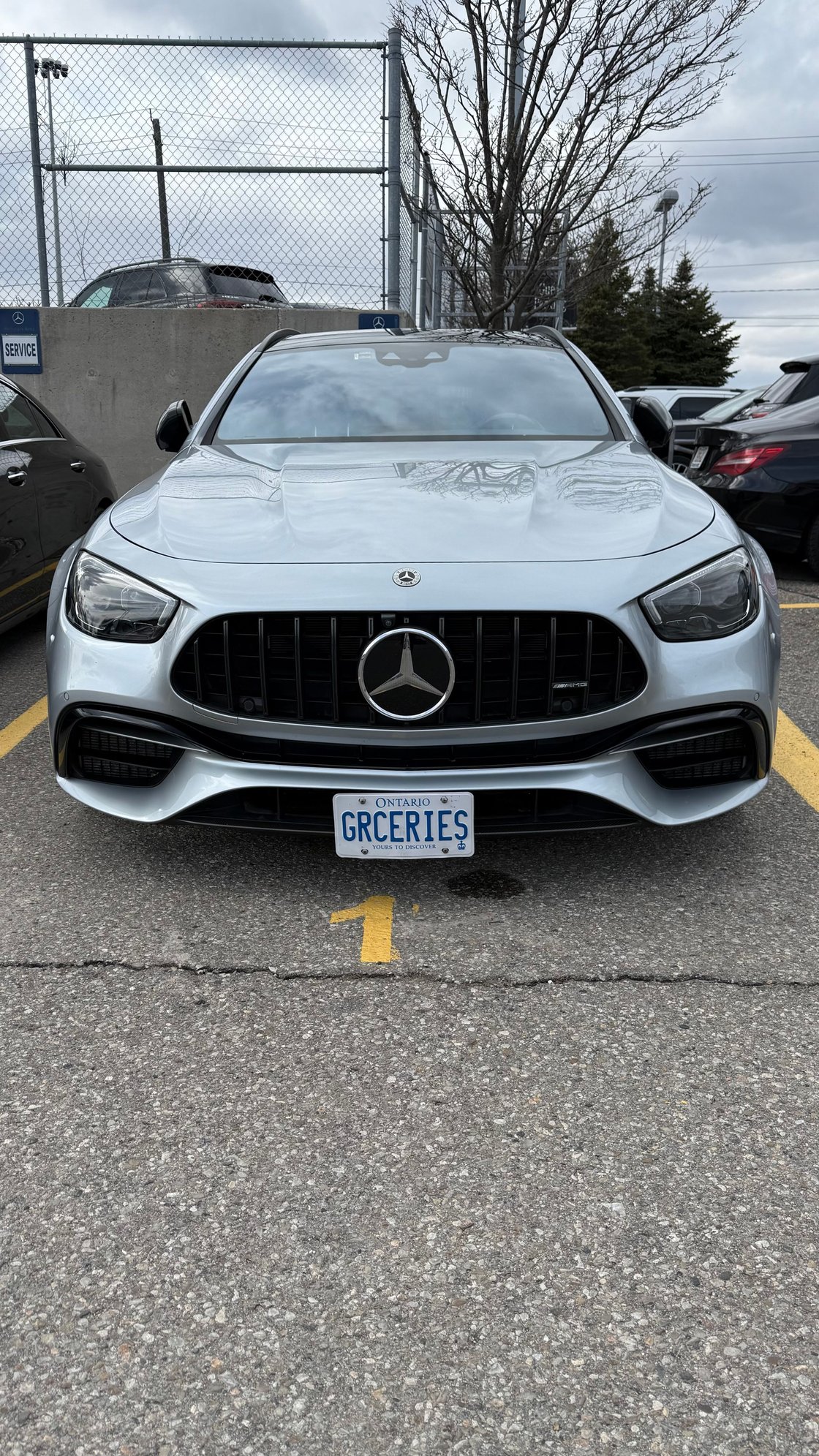

Service A
Oil Change, Brake Fluid Flush, Air Filters, Rear Dff Oil Change, Transmission Oil Change
They wrote "Minor oil leak from front differential, recommend reseal". Bugger that I just read this on the report at home - I will have to ask if this is a warranty thing.

Old Apr 9, 2025 | 05:16 PM
  #555
bobblehead's Avatar
Joined: Jul 2013
Posts: 2,594
Likes: 811
From: Toronto, Ont, Canda
go fast grocery getter wagon
Would they not fix it on the spot ? It’s stupid to make you go back for this.

Originally Posted by I.T. Guy
Service A
Vroom Vroom! If the weather breaks it's time for summer shoes!
So strange it is leaking, not a common issue I don't think, if so, there must be a cause, no cracks in the casing right?
Service A
as you recall this was common for the w212 2014+
How many miles do you have?
this will blow my mind if they don't cover this under warranty
- the front diff fluid is a non serviceable item for the 213, so how will they claim I wonder that this is not warranty item
File Type: pdf
Old Apr 10, 2025 | 09:06 AM
  #558
I.T. Guy's Avatar
Joined: Mar 2011
Posts: 2,507
Likes: 1,586
From: Canada
2023 E63S Wagon
All good points
The more concerning thing to me is usually my SA will point stuff like this out, I found out only by reading the papers after getting home. I hope just an honest busy/oversight.
Remember they did replace my whole transmission, I wonder if the leak is from that?
I texted my SA back, confident all will be good. Keep you all posted!
