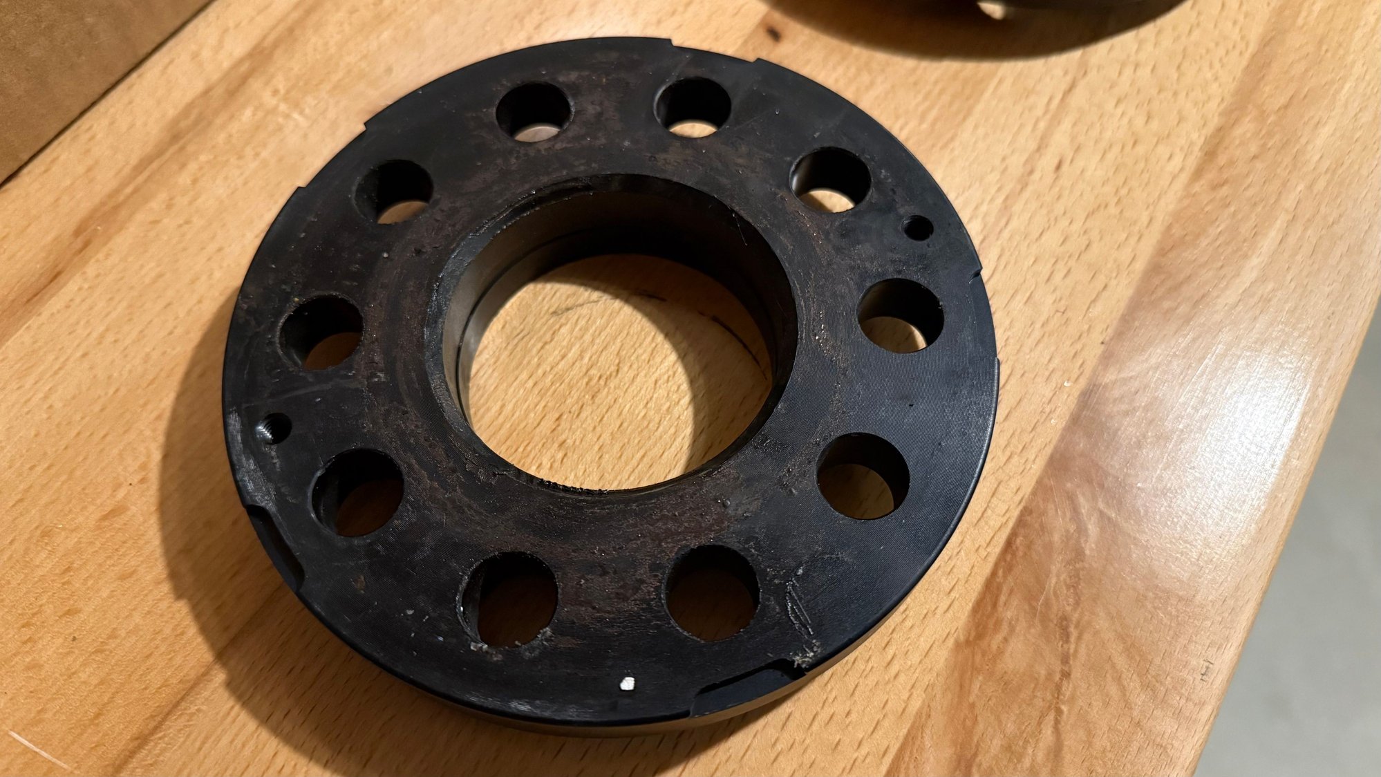

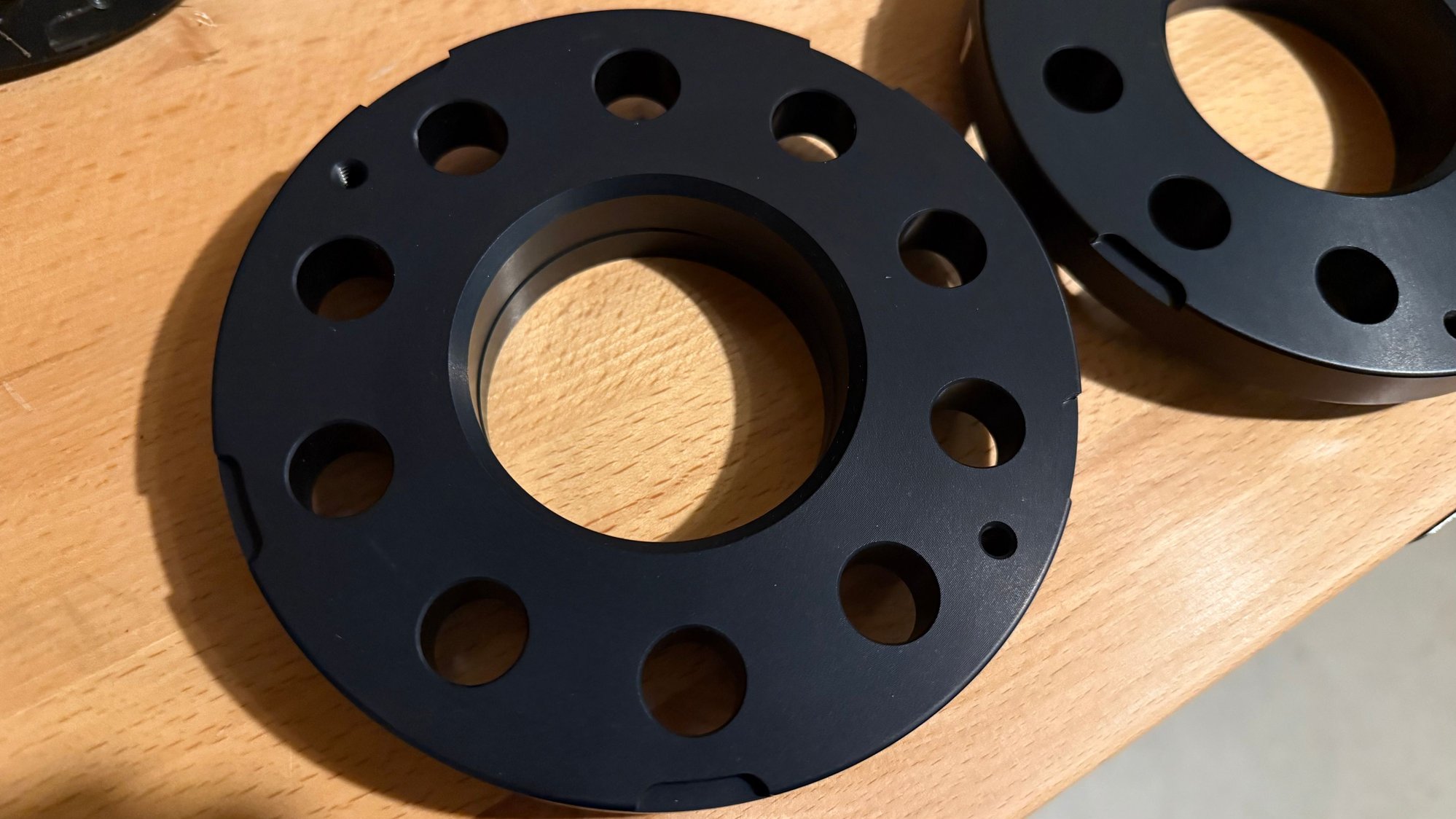

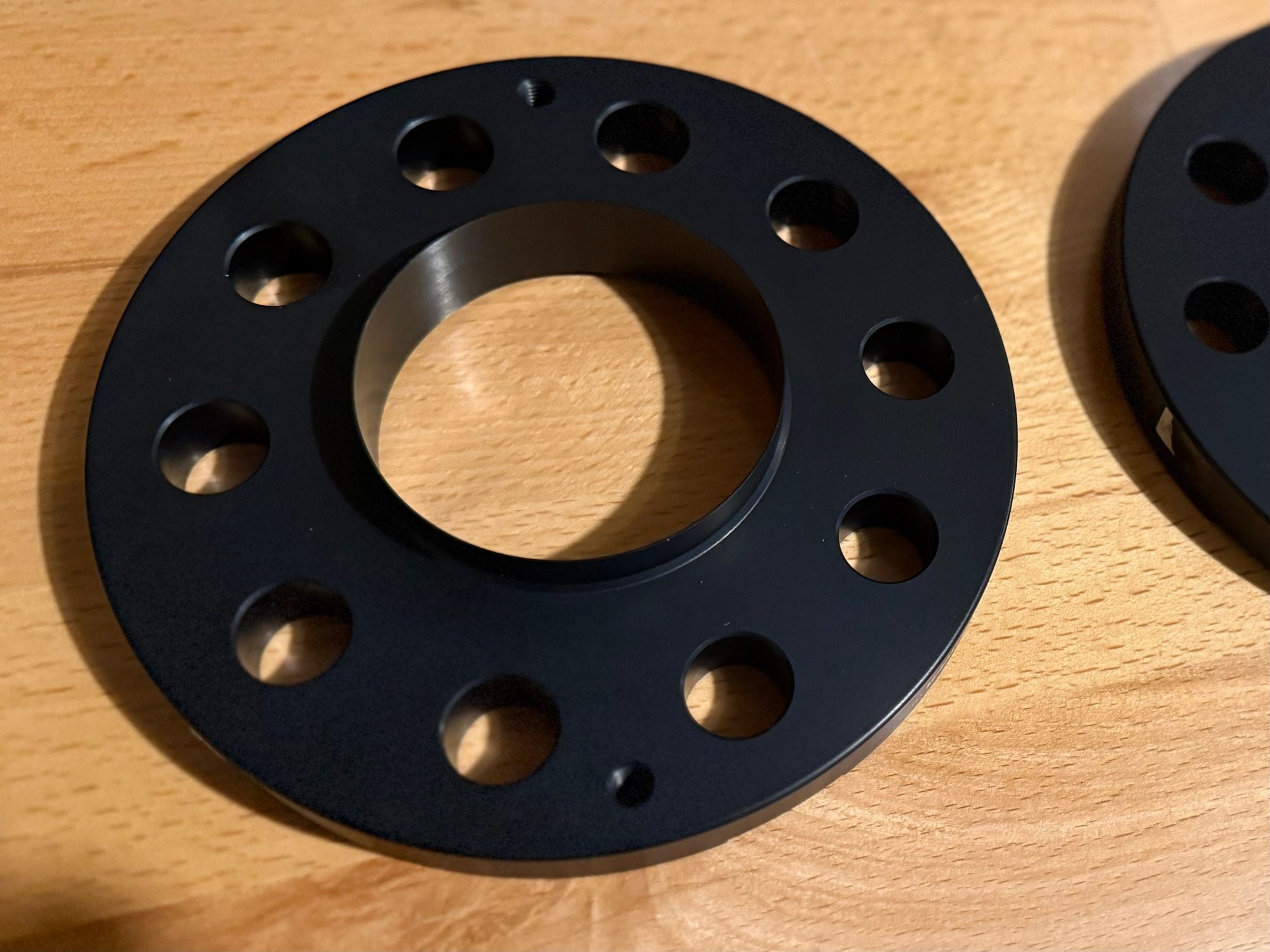

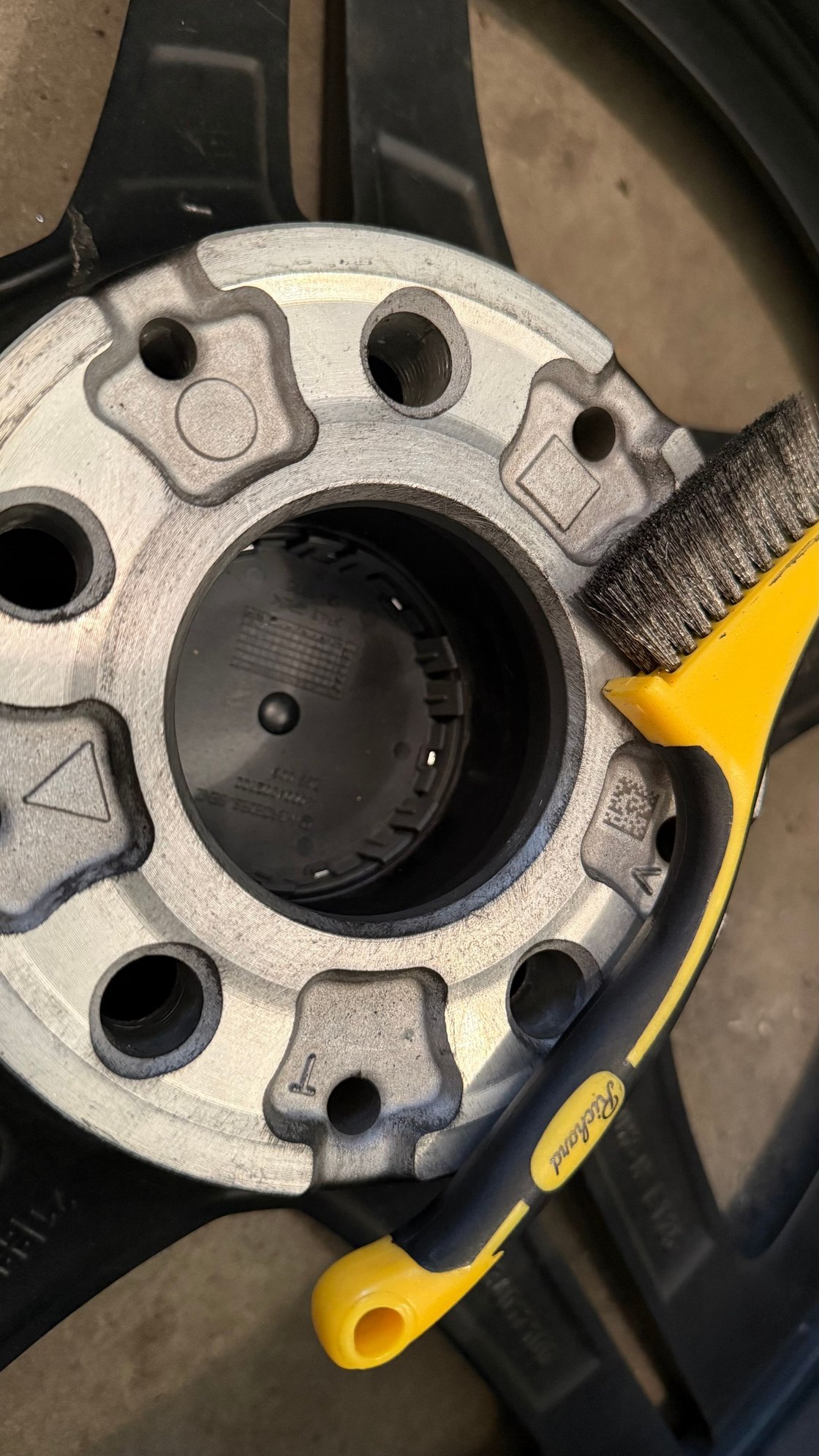

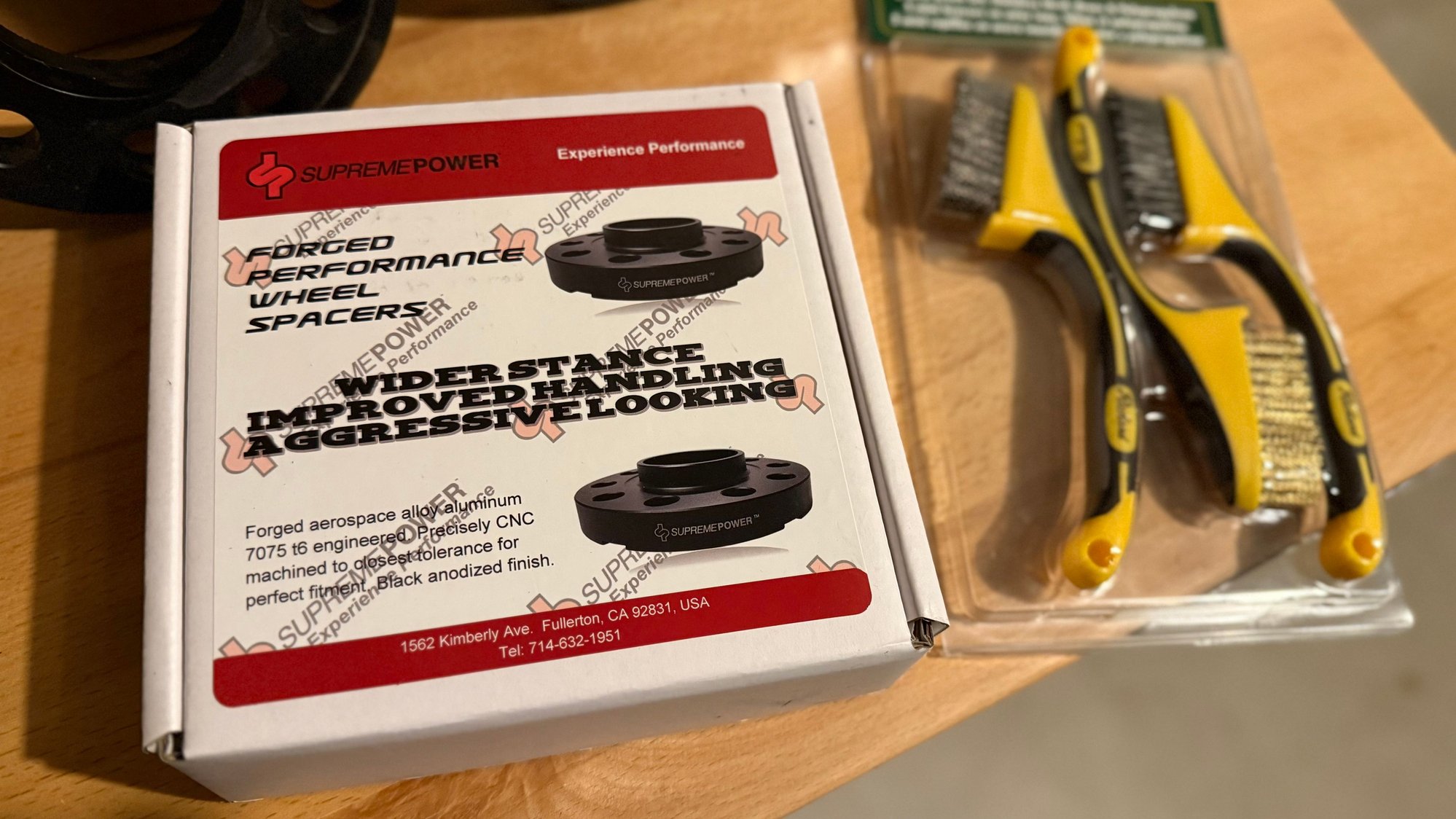

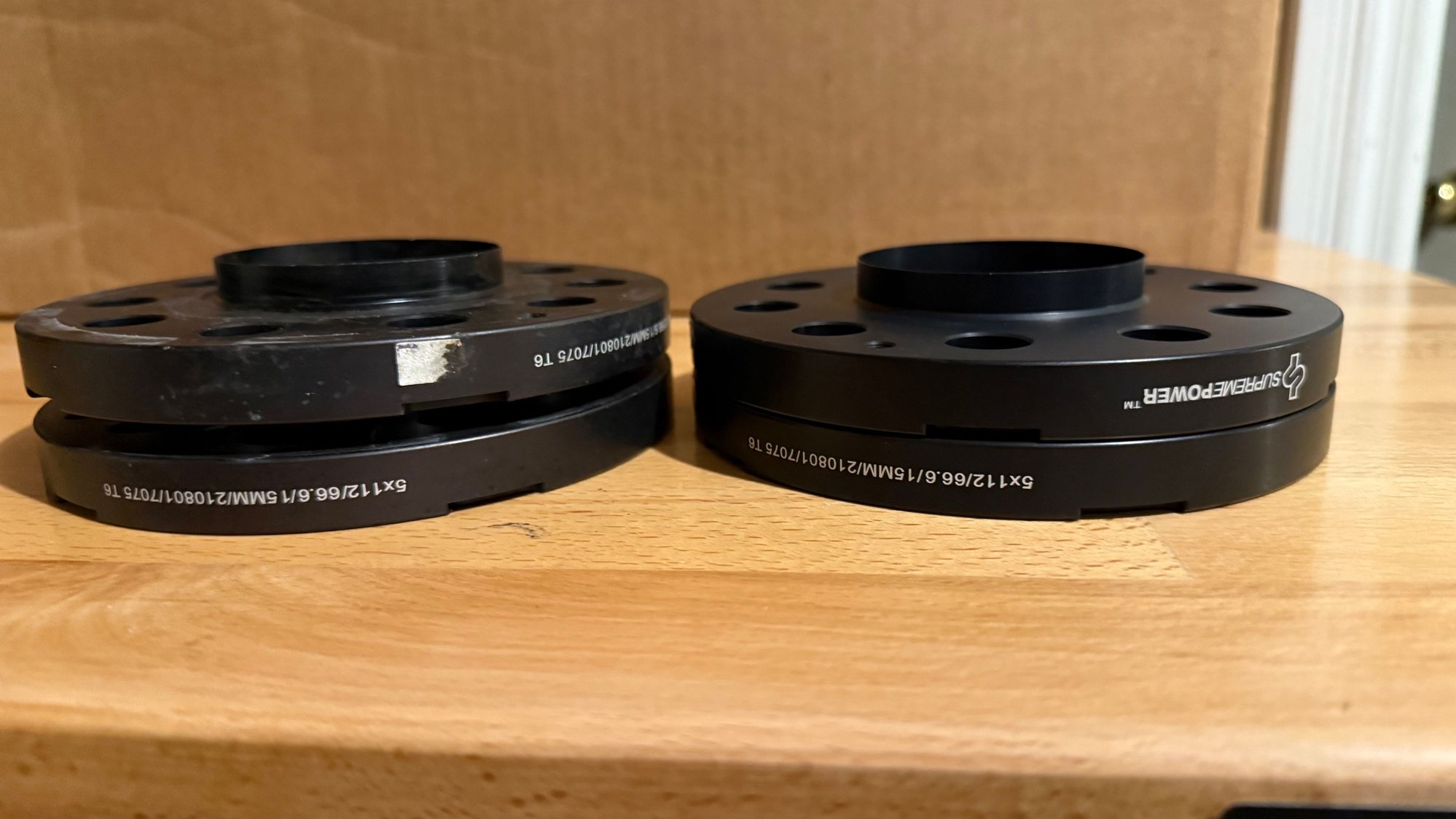

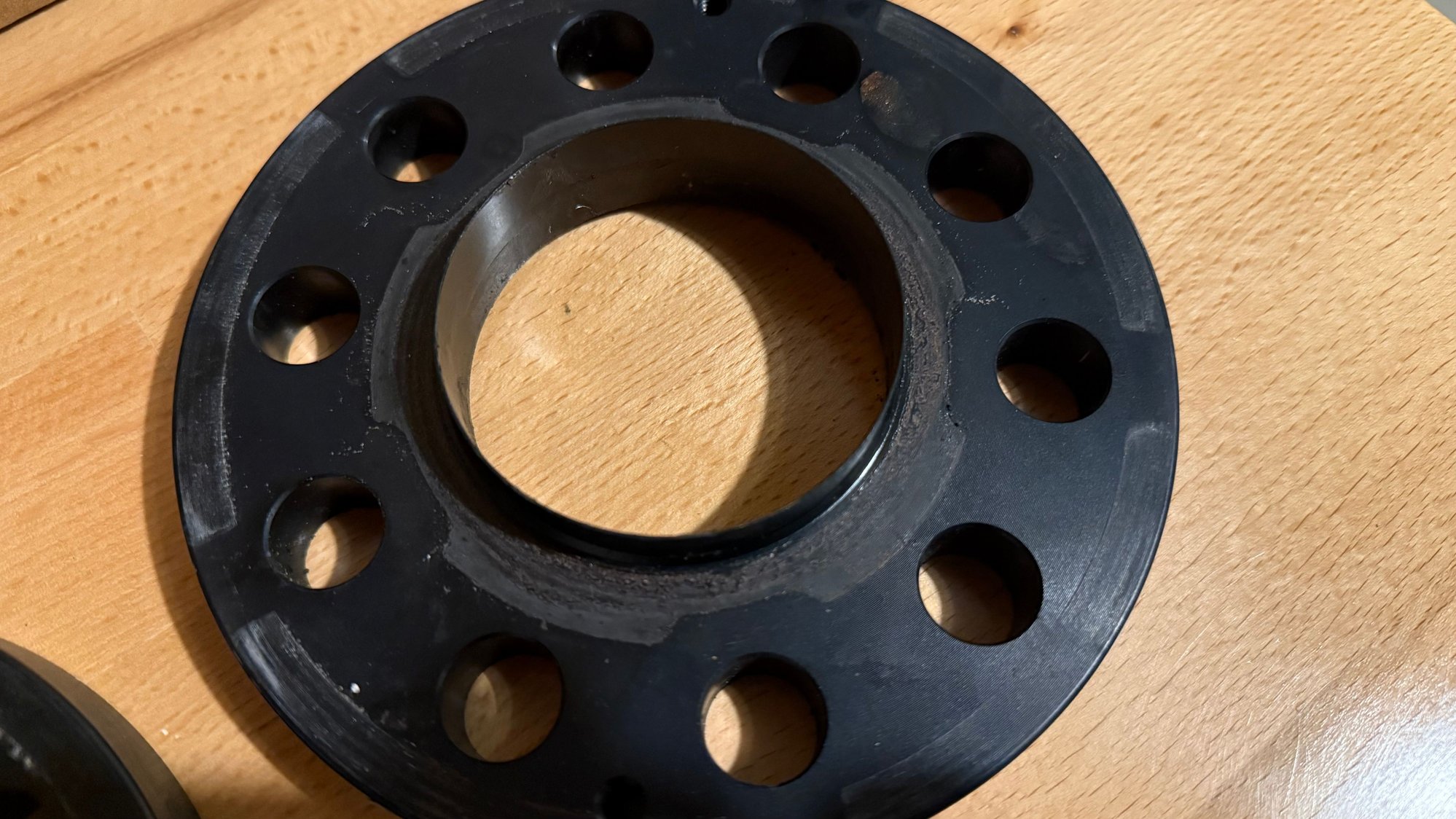

Spacer update
Turns out cleaning everything and installing the new spacers fixed all shimmy. I greased them this time and will clean and grease again on every winter/summer rim change.
Supreme Power was very helpful thank you! They put their money where there mouth was and sent me replacements, confident it was a dirt and corrosion problem and not a spacer problem.
They were right!!
New spacers and wire brush kit
Old spacers would not nest anymore due to dirt and corrosion
Old
Old
Old
Old
New
New
New
New

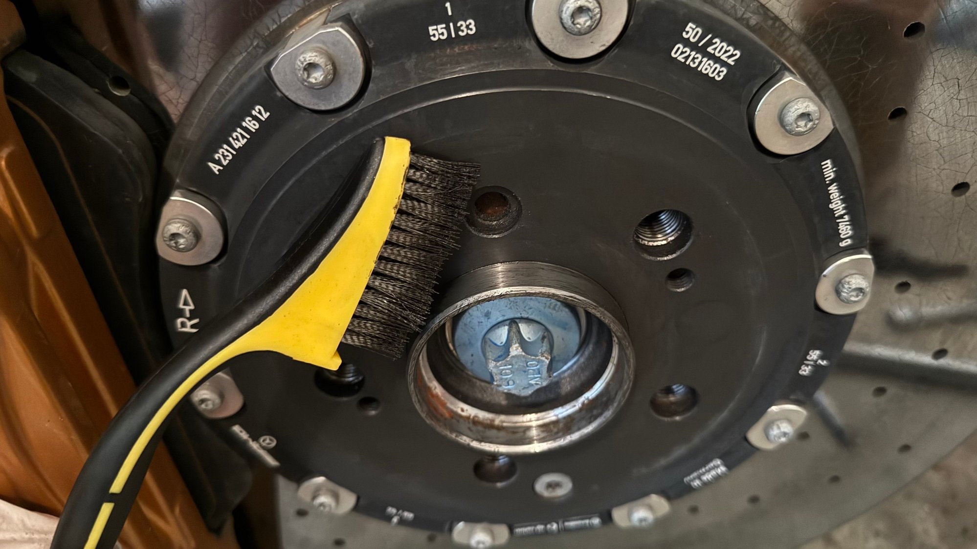

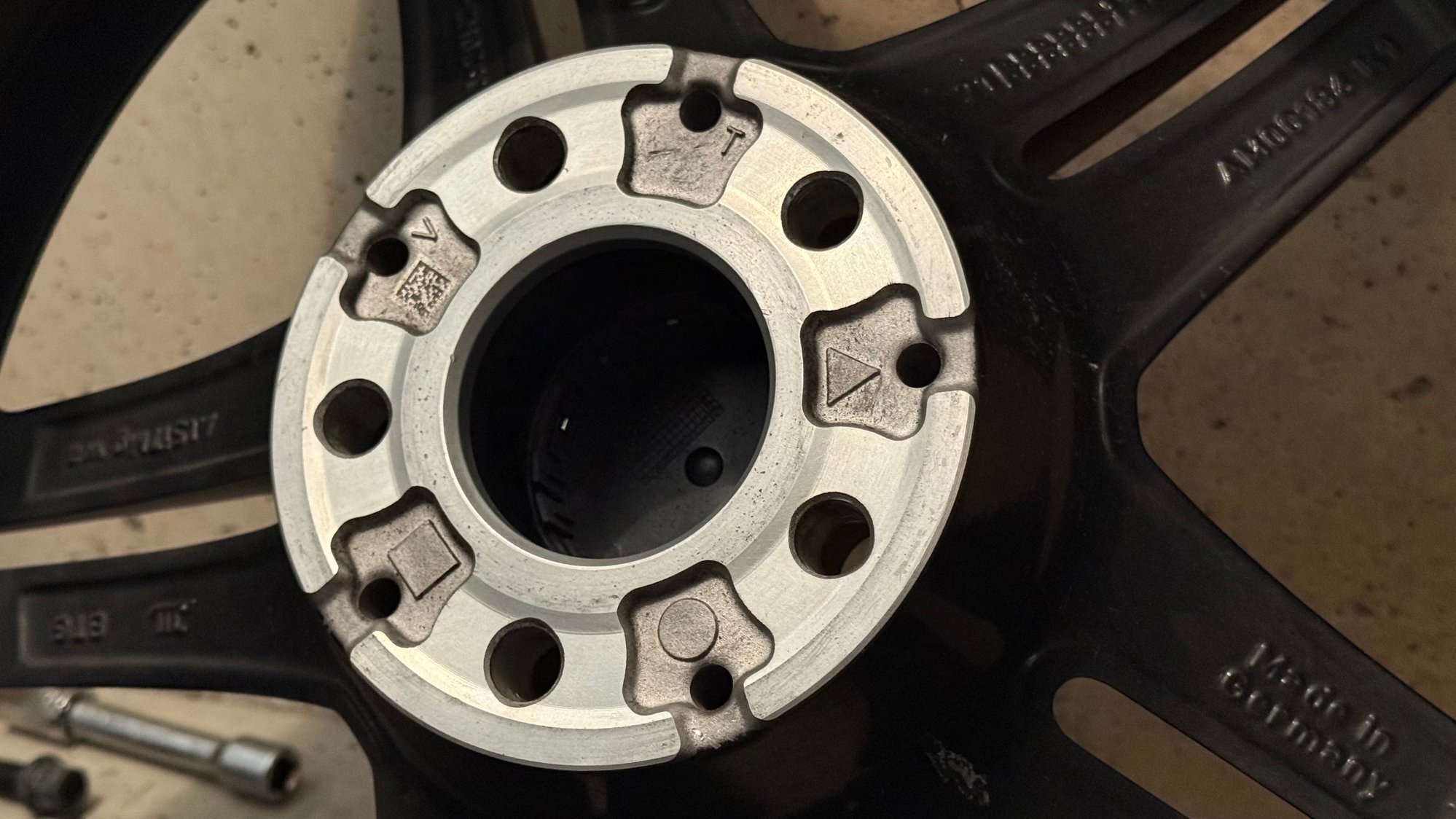

Cleaned up the face and hole
Cleaned up the face and mounting hole of the wheels
A lot of nastiness came off - all clean
A lot of nastiness came off - all clean now
Hub and also mounting face had crud and galled aluminum in spots
Hub and mounting face also had crud and galled/corroded/stuck aluminum in spots

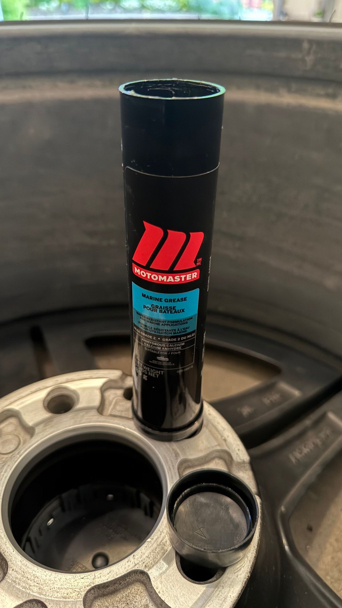

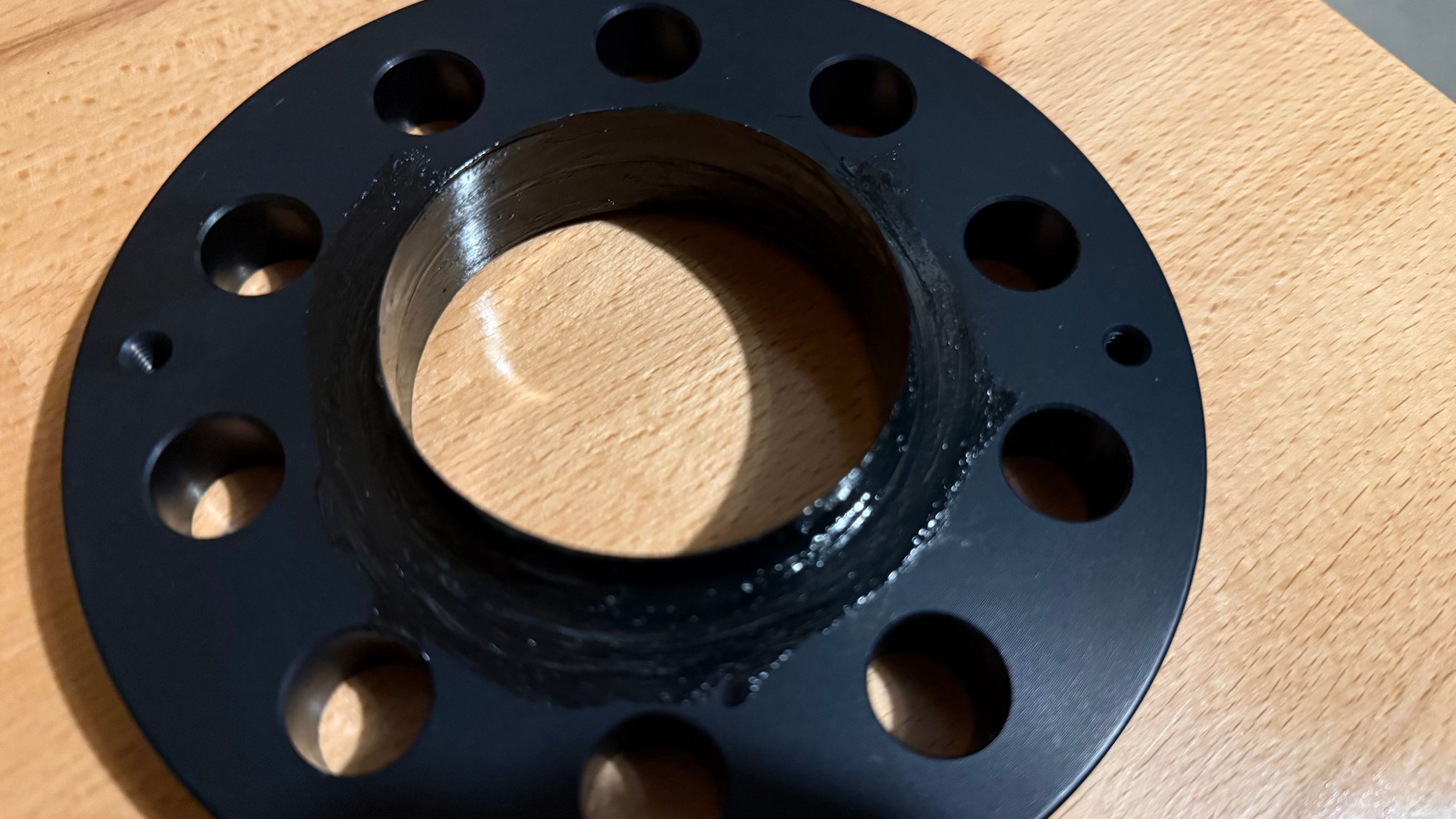

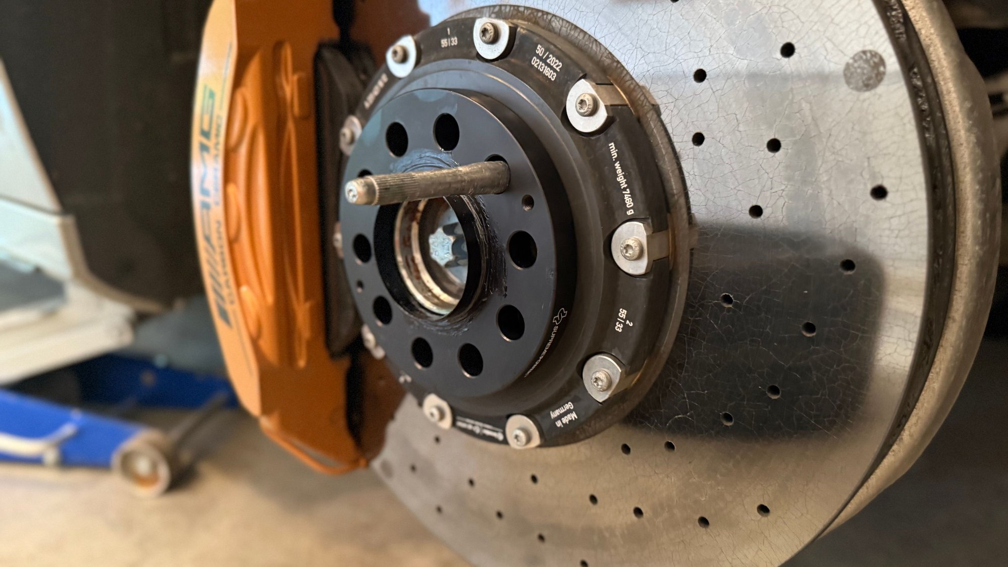

Marine grease
Marine grease
Greased inner and outer and very then layer on front and rear mounting surfaces then wiped the surfaces off. Left grease in the hub diameter parts (did not wipe off those)
Greased inner and outer and very then layer on front and rear mounting surfaces then wiped the surfaces off. Left grease in the hub diameter inner and outer parts (did not wipe off)

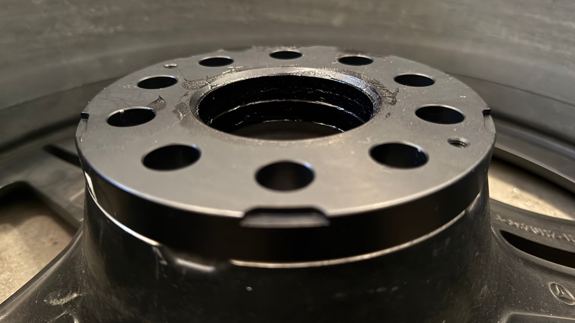

More pics

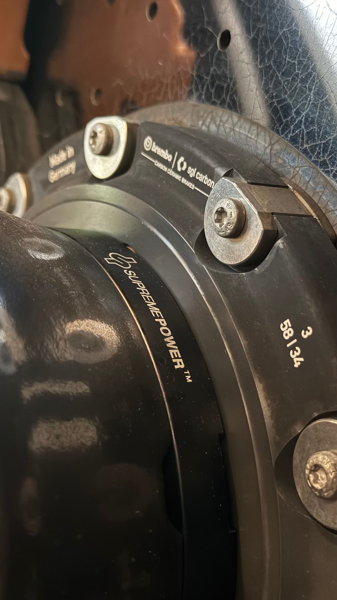

New greased spacers on cleaned wheels fit snug but still fit easy by hand not like the corroded ones
Nice and flat new spacer fits again very easy by hand

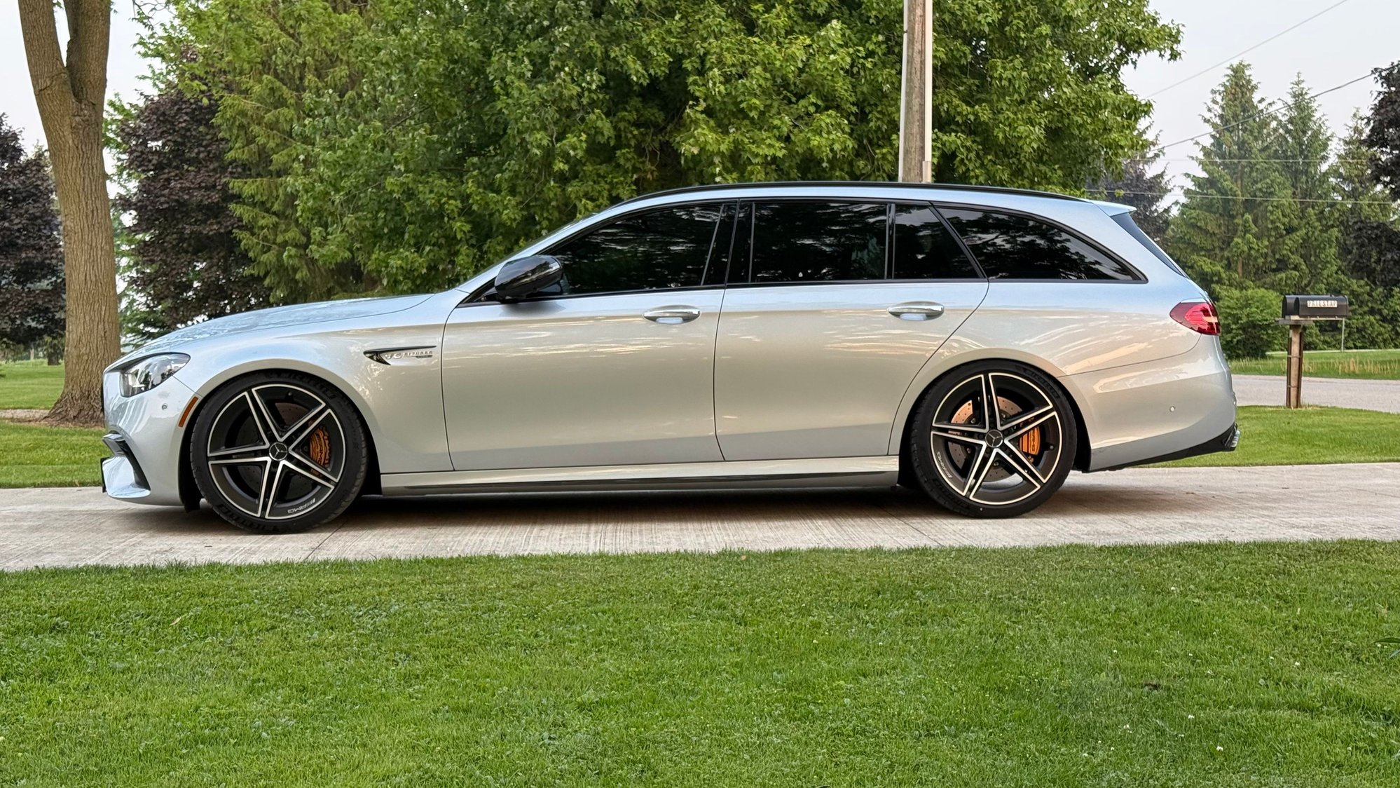

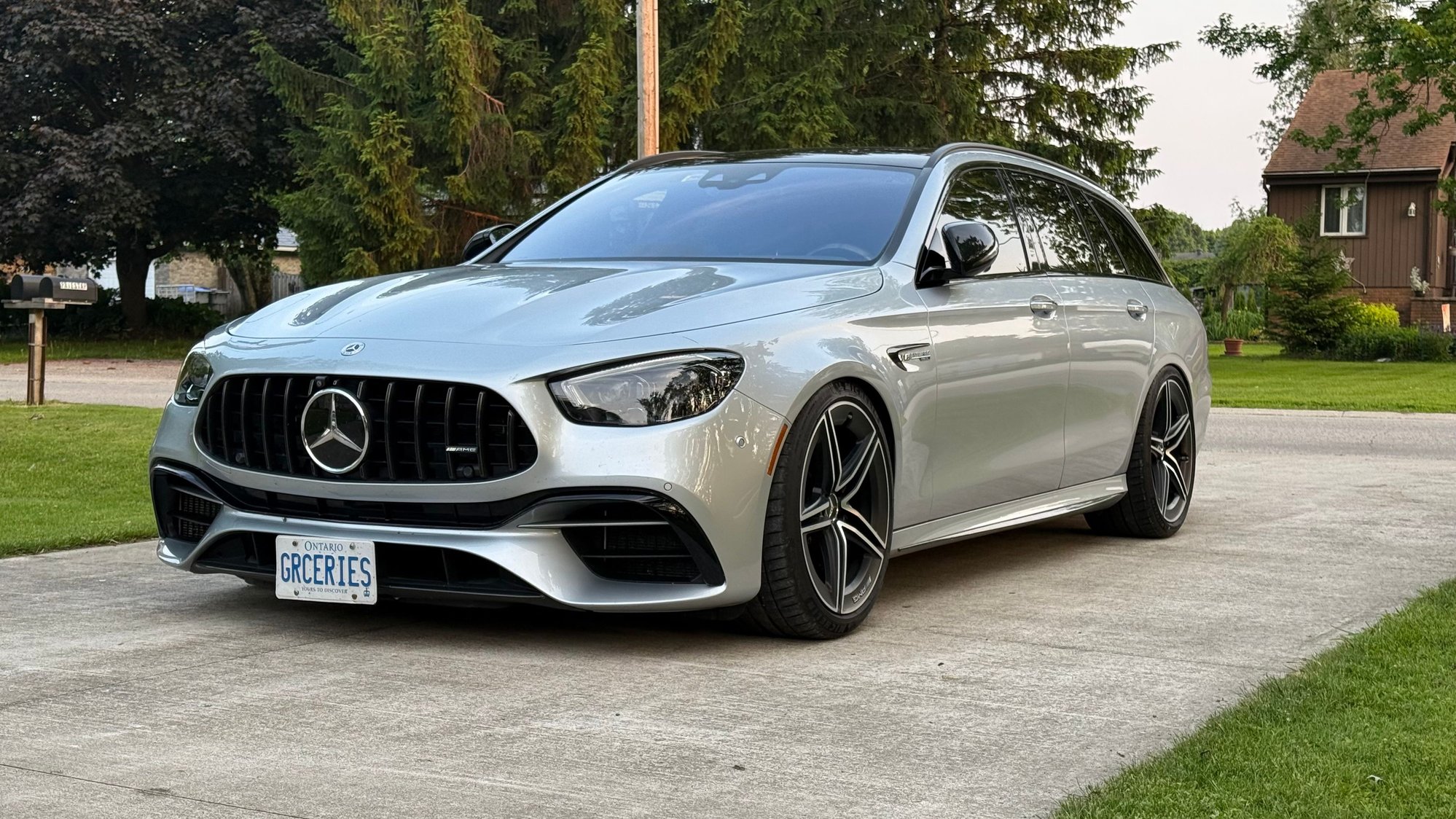

All done! Thank you Supreme!
All done! Thank you Supreme Power!
Leered 30/32 F/R
Lowered 30/32 F/R
I hate front plates. And it’s crooked. Need to remember to pop off the Sto N Sho for pics!
I hate front plates. And it’s crooked! Need to remember to pop off the Sto N Sho for pics!

Wild, im lowered only 19mm in front and it looks almost as low as your 30mm.
Your wheels are 20's yeah?
That is Wild! Yes stock 20"

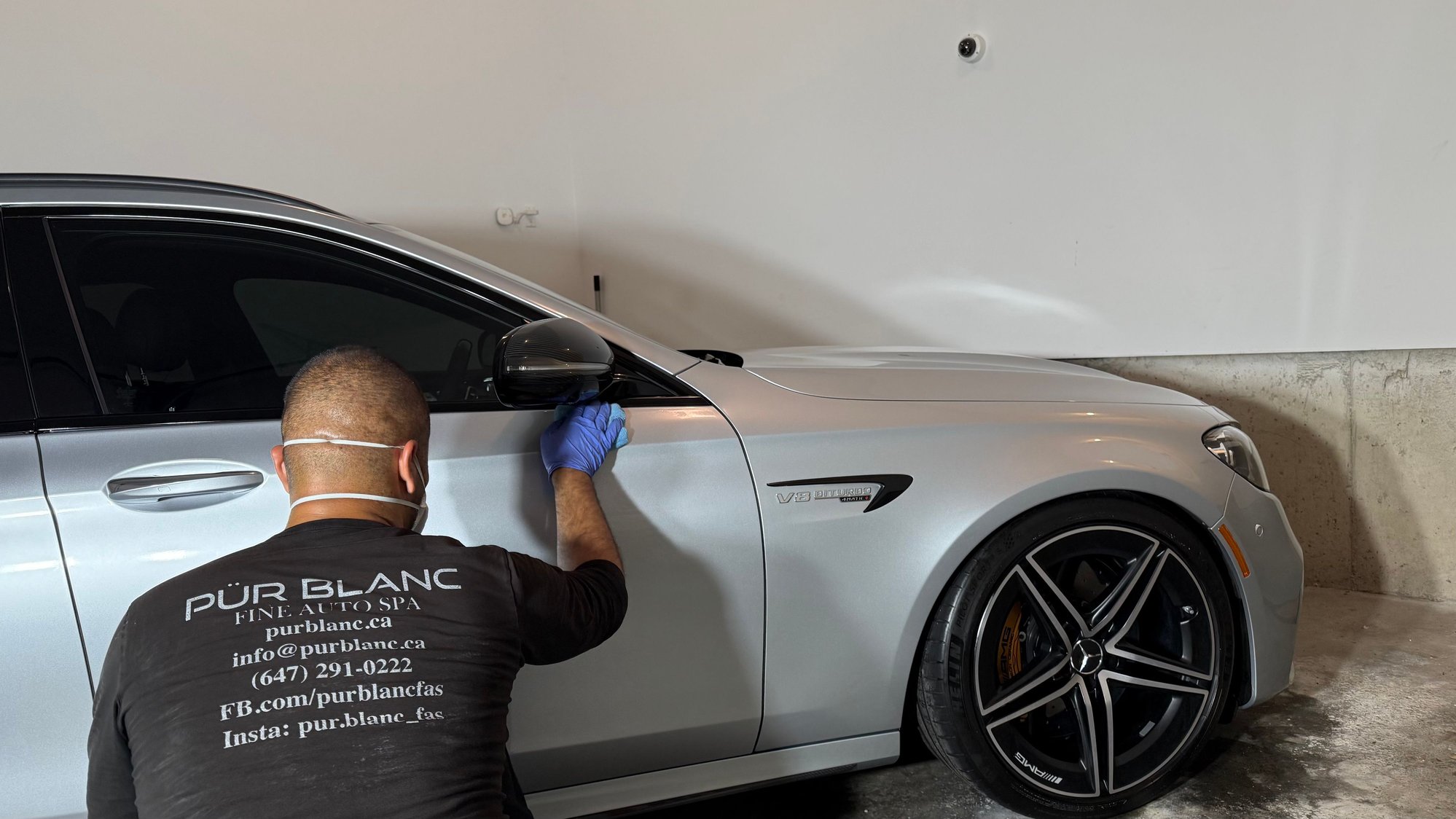

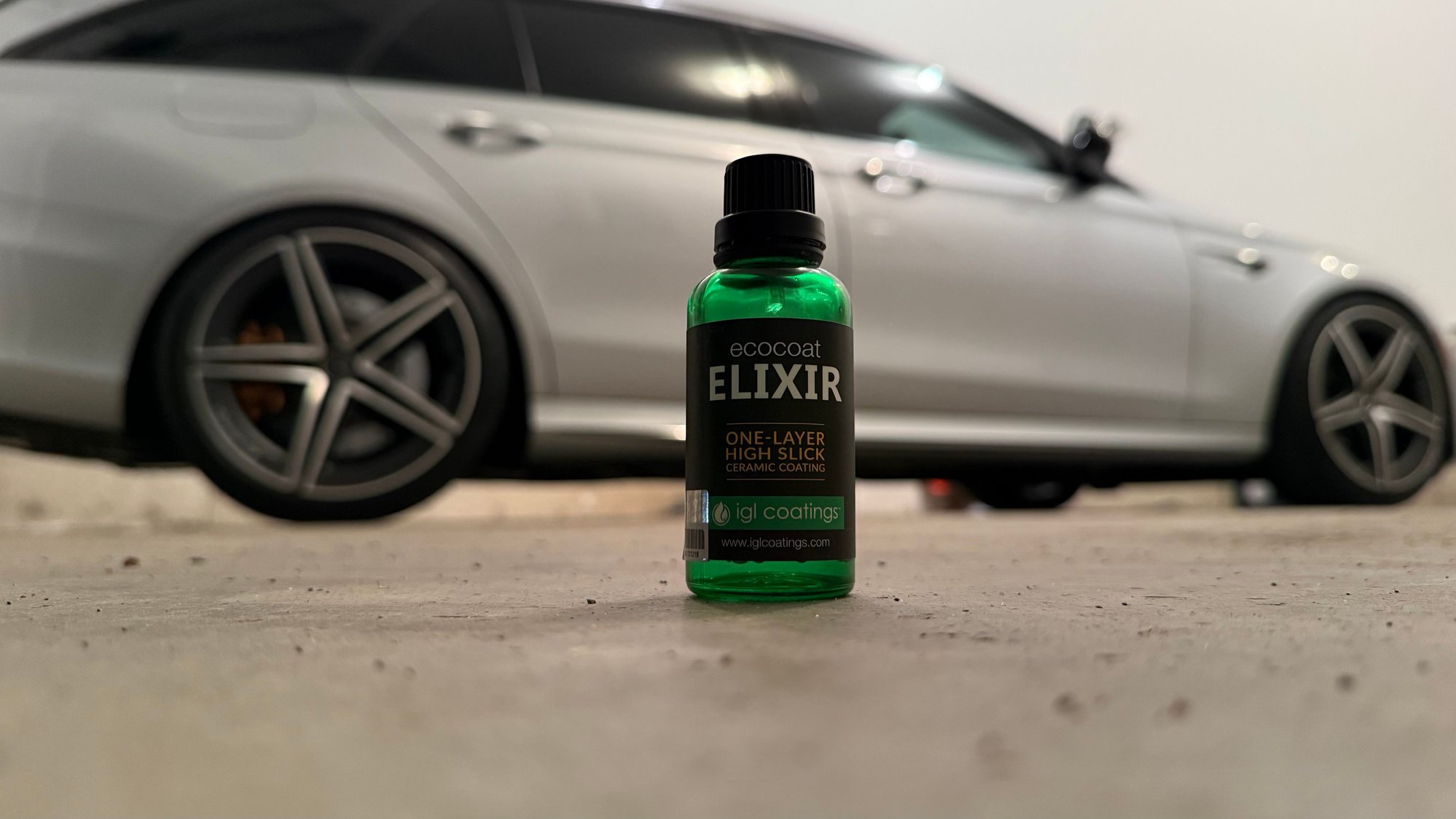

Justin from Pur Blanc Fine Auto Spa did a full inside outside under hood detail. Car is in great shape! The only light scratching was from when I accidentally drop the gas cap and it dangles.
All perfect again! Leathers all treated, and exterior coated with 3 year Ceramic.
Car is better than on delivery day.
Justin is the best.
