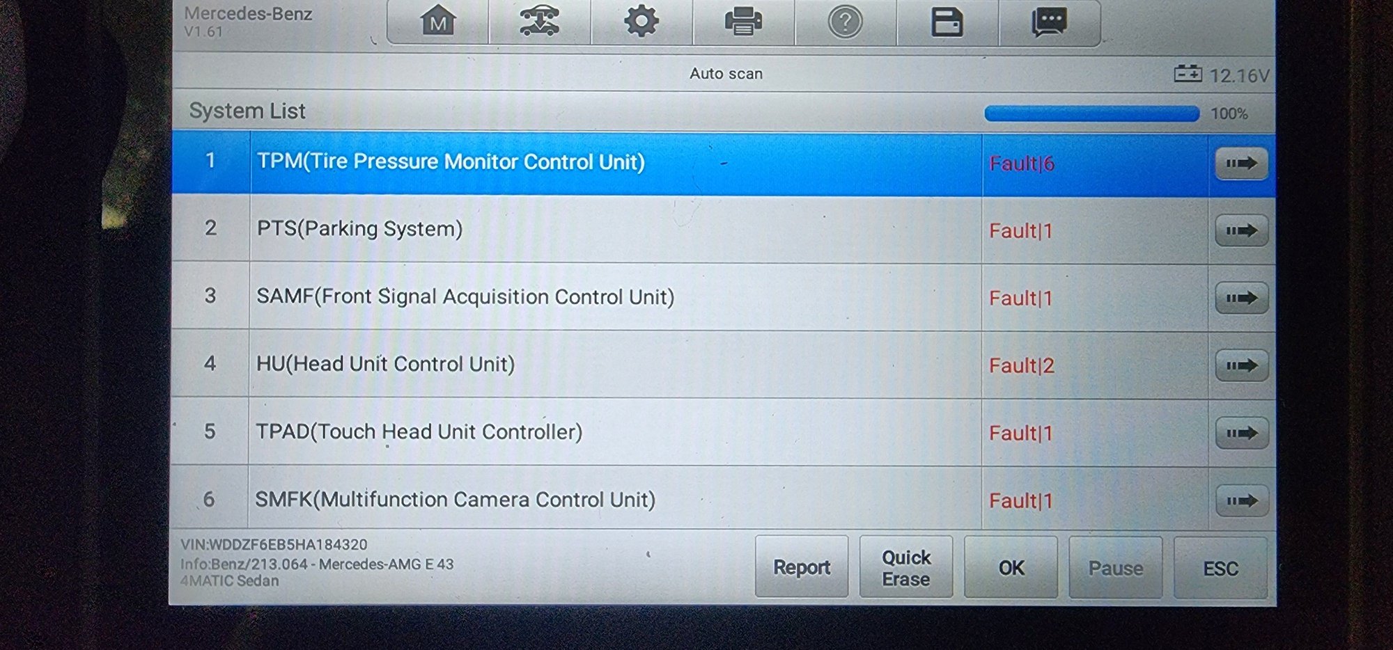

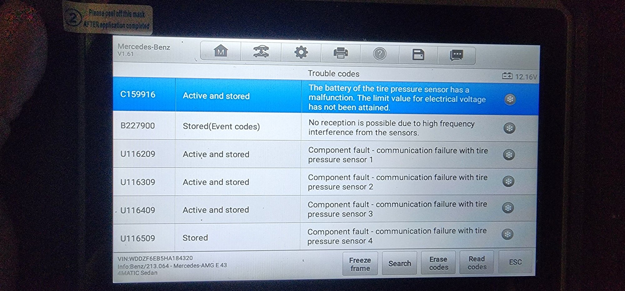

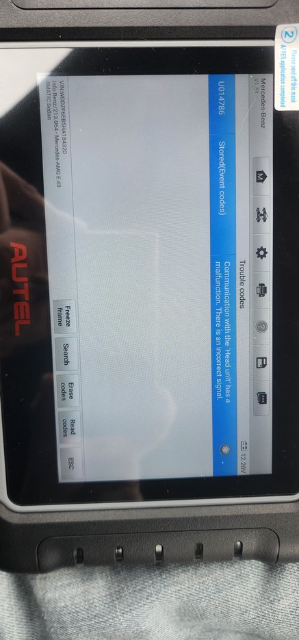

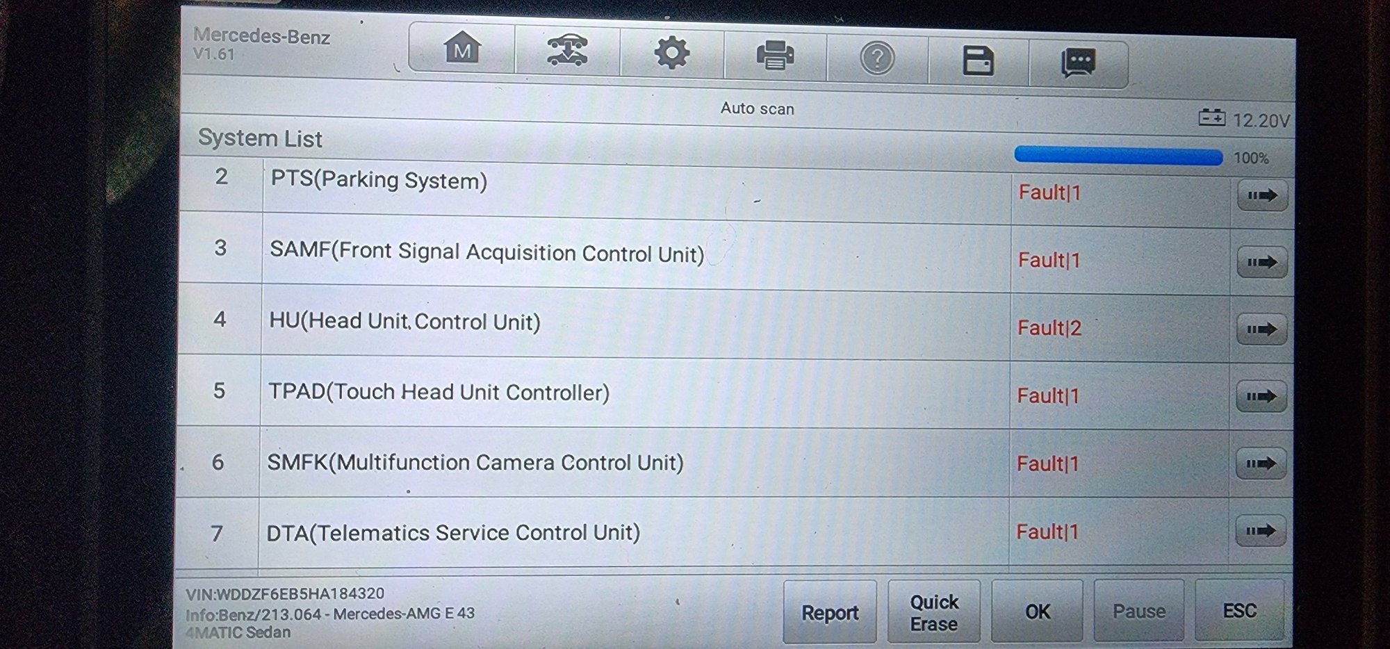

My scan tool came today. I wasn't able to mess around very much but I did get some codes. Due to limited time I will just share the pictures I took instead of typing it all out.
I had seven faults in total.
Spoiler
Most of these aren't relevant. They were just errors due to things like the head unit not being able to connect to the internet or running low on windshield washer fluid.
TPMS fault: So, over the last few days all the sensors except the left rear has stopped working. I'm guessing the sudden drop in temperature pushed them over the edge and it is only a matter of days before the last one stops working.
Based on what I am seeing here, it doesn't seem there is an issue with the actual module but rather just the sensors need to be replaced, correct?
Spoiler
I know I need to examine the modules mentioned in this thread and see if I can see anything. I'm not exactly sure what I'm looking for or what I should be testing though. I'll have to mess around with it in the coming days. I'm out of time for tonight though...

You have a fault in your SAM, we discussed this earlier - this could be contributing to your trunk issue
you have a low battery issue with the tpms, and this could be why it's not communicating. You need to replace them anyways, and then you can re scan; however, you still have a code fault with the control unit for the tire pressure monitoring system
issue is why is your SAM giving you a fault code and you have issues with your trunk
you also have false with several control units themselves, you gotta wonder why multiple units are not operating appropriately, try to clear the codes and see if they return after driving normally for a few miles.
i've seen these codes come and go, which has really nothing to do with anything serious. Sometimes it's related to the main battery or a low electrical voltage scenario the trips all of these units simultaneously.
I forgot it was the SAM you mentioned.
I meant to go back through this post and scan those modules when I had a moment. I think I know why some of those codes popped.. I tried to pull up one of the apps in the head unit without a subscription just to see what would happen so that must have triggered a code. I also intentionally drained all the windshield washer fluid because there was summer fluid in there so that triggered a code. When I first subscribed to the service for Mbrace, the app couldn't communicate with the car at all so maybe it was why I had a code for the telematics. Customer support did some behind the scenes things and now everything is working fine with the app.
But get this! I just cleared all the codes and now the trunk is working perfectly fine!
I can't tell you about the TPMS issue yet because I have to drive the car but I'm sure they are all going to fault out except the front left one. I'm almost certain they all need to be replaced. That is going to be done this Friday.
I do wonder about some of the codes though, like why the SAM messed up. Maybe it was from my car wash, maybe it wasn't. I guess I will just have to keep driving the car and see what happens.
Anyway, I'm on my lunch break so I don't have too much time to mess with the vehicle right now but I'm satisfied with this turn of events.

I'm glad clearing the codes worked out, that's often a solution for relatively simple problems for these vehicles.
there may have been some type of electrical gremlin associated with the car wash that has now dried up or cleared up somehow. Drive the car for a little bit, 20 to 30 miles and re-scan for codes and if you don't have any codes, you should be good to go. Also have someone do a test of your main battery even though you said it was just replaced, you never know if there is a bad cell and a poorly performing battery even if it was just replaced, can cause some of these electrical gremlins.
and now that you reset the TPms control unit, you may have better luck with your sensors, reporting the actual values of the tire pressure. Also, when you clear the codes, you often will reset the ECU with that scanner and you will also benefit from likely improved throttle performance as the ECU has reset the throttle adaptations and now is gonna learn, potentially more aggressive, driving pattern and give you the feeling that you have a more responsive Engine. For example, and read to the end of this thread.:

Unfortunately, the issue is back. As soon as I cleared those codes, I went and tested the trunk and it worked. When I was getting off work I tried to remotely start the car and noticed it was taking longer than usual. I ended up canceling the process and when I went outside I decided to test the trunk. It's no longer working.
Except this time, there are no trouble codes relating to any SAM module. Come to think of it, the first time it was the front SAM module with a fault code relating to a windshield washer fluid. I'm not sure why clearing the codes worked momentarily when there was no fault for the rear SAM.
I tried playing around with the SAMR module and was unable to really accomplish anything. I can pop the trunk and things but I can't really control that latch on its own. When I try, I hear a slight noise in the trunk and nothing happens. But if I do a power release it does open up. I don't know if that tells you anything.
Oh yeah, all the TPMS errors came back. So I'm pretty sure those three sensors are dead. Like I said, I think they were just clinging on to life and once I brought them into Wisconsin winter, they just gave up the ghost. The car was residing in Georgia where it was nice and warm after all.
I also have a head unit error again but it's just for not being able to connect to the internet. I live in the rural area with spotty cell service and I'm guessing whenever it loses connection it triggers a fault code.
Clearing seemingly irrelevant codes did not help this time.
I'm suspecting now I will have to manually test the power latch using the links provided in this thread. Maybe It isn't getting power or sensing when the trunk is touching down.

Well yes, like I said, I'm pretty much certain the TPMS batteries are dead. It was no surprise to get an error message again. I'm 99% sure that when they are replaced Friday the issue will go away.
I just find the trunk issue to be odd though. I don't understand how resetting codes for modules that should have nothing to do with the mechanism would suddenly make it work ever so briefly. I had a fault code for the front SAM, not the rear.
Perhaps this is just one hell of a coincidence that it went bonkers after the car wash and then briefly worked after resetting seemingly unrelated modules.
But yes, I think the next logical step is to diagnose that motor. Maybe I can scrape enough time together this weekend to do some testing as per that linked thread.

EDIT: Great, new codes but guess what? I just reset them and the trunk is working again. Let's see if it works when I come out of work.
Here are the codes. I'm terribly sorry they are sideways. My break is ending and I don't have time to fix them.
