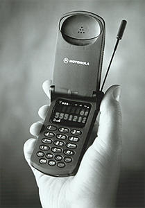

How can I convert my Star Tac to a Bluetooth
I'm searching for a bluetooth for my 2000, mercedes. Can I convert my old cellular phone system (motorola Star Tac) to abluetooth system?. My car systems is complete, noting has been remover.
