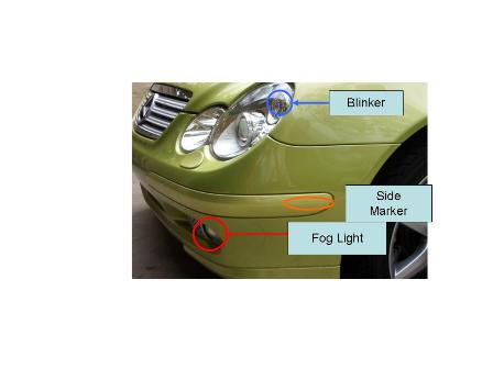

Citron :
Did you have the instructions to remove the old blinkers for the new cristal clear blinkers for w203 i know that you have a beter ones, but i buyed the W203 ones and if you have the instructions to remove the old fog lights ?
thanks for answer my cuestions, and thanks again you re a great friend.

do you mean the amber side markers? those you just pop right off. for the sedan you would want wedge a small flat blade screw driver between the lens and the impact strip, and the lens just pops right out. you take off the bulb from the back, replace with the clear lens and and put the lens back into the strip. they are very easy. actually written instructions will be located in your owners manual for your car. should be in the under replacing the light bulb for the side marker, it give written instructions as well as illustrations i believe.
im confused because you ask for the removal of the blinkers, and then you mention the foglights. but you want to put in a clear lens.

which one?
Attached Thumbnails Bi-X: W203/CL203 OEM Bi-XENON Upgrade, Auto-Levelling & Programming thread-presentation1.jpg

I think he means the blinkers on the side-mirror housings. Kinda like what Carlos is going to do with mine, replace the stock W203 ones with W211 ones.

ok, i got it now. he wants instructions to remove the mirror housing in order to install 2005 indicators or W211 indicators in the mirrors AND instructions to change the fog lights.

No silly. He never said markers. You are the one that brought up the markers issue. Read his post again. He's asking about the side blinkers, the ones on the side mirrors.
edit: OK, never mind. You got it. Funny.

Here are the foglight instructions:
From 'patronus' at mbworld.org:
On the driver's side, you must replace the bulb from under the car. There is a panel just below the light. There is a seam between that panel and the one under the engine. Remove the screw between these two panels and fish your hand up through the crack (no need to remove the panels). You should feel the back of the bulb and.... Good luck!
to add to this, the bulb base twists 90 degrees then you pull out the bulb from the socket. replace the bulb and screw back in. its not hard, ive changed my fog light bulbs 2x so far. finally happy with the color.
here is a thread i started with instructions (under my pen name ) for removing the mirror housing.
https://mbworld.org/forums/c-class-w203/87118-mirror-removal.html
you must remove the housing in order to get to the indicators in the housing. two screws hold them in. indicators are plug and play for 2005 W203, W211 will require changing the plug from 4 prong to two.
hmm, maybe not though now, they got rid of the puddle light on the W211's i thought, so maybe it is just 2 prong plug. the 4 wires were: 2 to the puddle light bulb, and two to the LED's in the blinker.
not sure how many plugs they have now. mine had 4!
