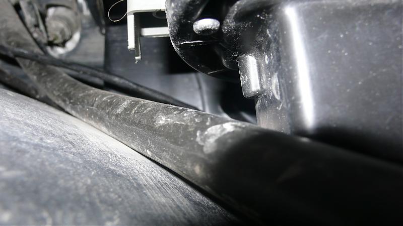

Ok im stupid, how do i remove the cover to change my bulb for the Bi-xenon Headlight?
I can open the bi-xenon cover no problem on the driver side, but on the passenger side, the bi-xenon cover has a screw beneath the the adapter thingy on the cover, which is very hard to reach. Also i heard from a friend that it's a special mercedes screw that only mercedes can open the cover.
So question is, do i really have to remove the bumper to open the cover?
Is there an alternative way or what type of screw driver i could use to open it?

here is the pic of the screw that i need to unscrew before i can do anything, anyone have any idea how i can open it? i heard only mercedes dealership has the screwdriver of it

That requires a torx head, not sure of the size though. Should be available at any auto parts store.

It looks like a Torx screw. If you have a ratchet set, you should just fiddle with the different screws to see which one fits. It looks like it's a torx screw with a lot of treads (or whatever you call it).
my question is why the hell is there a screw there? both side should be a black snap-on cover that's easy to take off.

i just bought the bulb from a local auto shop (friend of mine). yes it flicker few times then turned off. Most likely it's the bulb's problem.
To answer FrankW, i donno, stupid coupe bi-xenon is different then? lol
