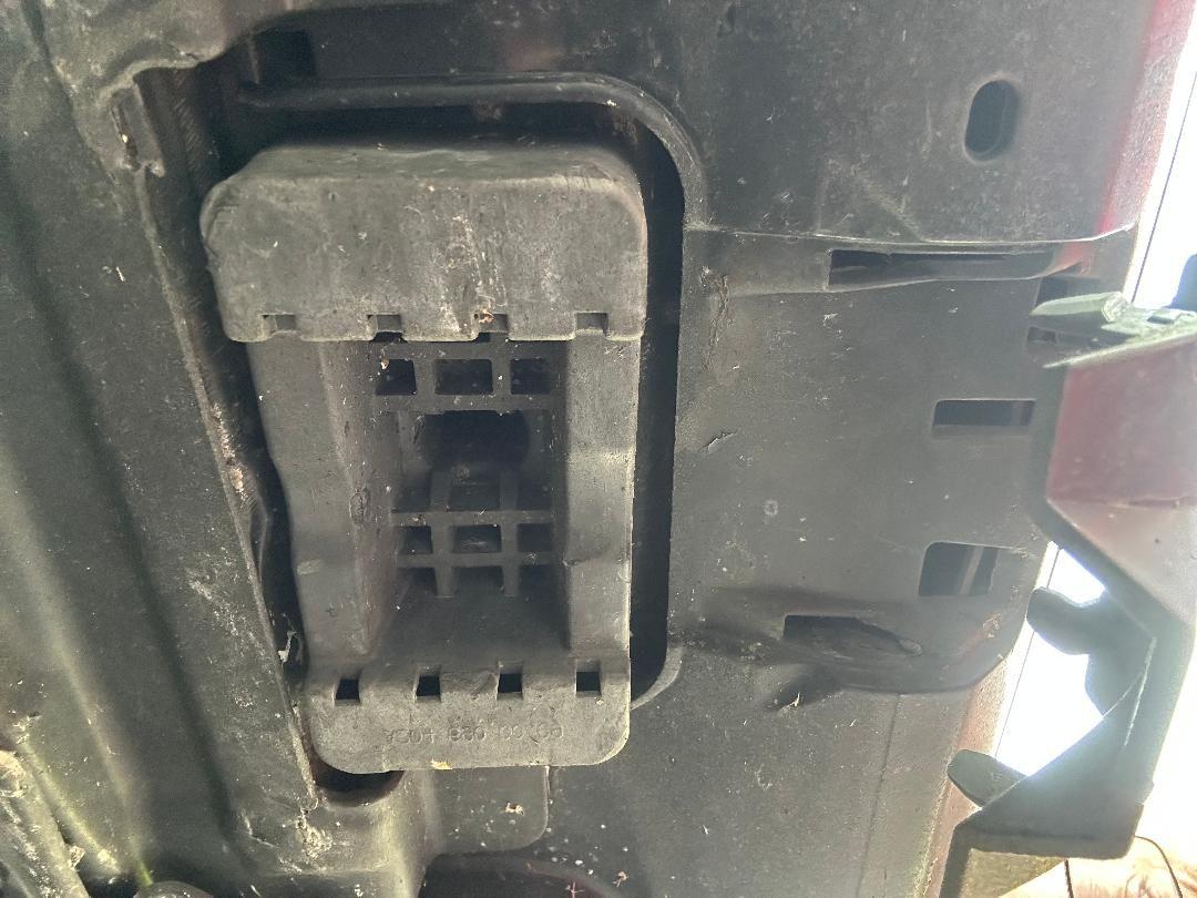

Hey Matthew - again first time working on this car as it was always under warranty.. So do I need special jack pads to insert into the jack points below? Then, where can I jack the car in order to place jack stands at this point so I can work under the car?
Appreciate everyone's replies but want to learn the right way to do it.
Thanks!
~Rx
You can buy the OEM jack here: https://mbworld.org/forums/c-class-w...t-my-c450.html
Or the jack pad: https://mbworld.org/forums/c63-c63s-...63s-coupe.html

So hate OEM jacks but I can simply use the pads. If I jack up here, where do you place jack stands if you dont mind sharing?

Thank you - that old posting helped with pics!

Originally Posted by Rx008
Thanks W205...
Put the jack pad in the slot and then you jack by placing the centre of the jack on.
